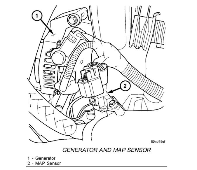

Good morning,
The car does not have a mass airflow sensor. It uses a MAP sensor in place. I attached a picture of the location for you.
What is the issue that makes you think you need a mass airflow sensor?

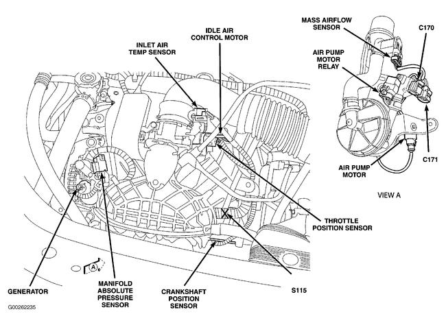

I looked at another diagram on here and it is showing a mass air flow sensor by air pump motor and air pump relay. I'm lost.
Dec 18, 2019 at 10:59 AM
Okay, thanks.
Again, there is no mass air flow listed for your car in our information system.
