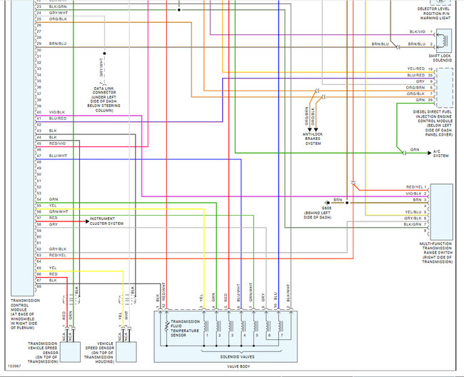

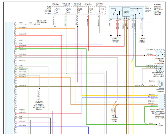

looking for wiring diagram for TCM on 02 jetta with 01m auto trans
2002 VOLKSWAGEN JETTA
23,800 MILES • 1.9L • 4 CYL • 2WD • AUTOMATIC
WIRINGHELPNEEDED
swapping 01m into another car, thought I had all the wiring figured; can't get communication with TCM I believe I cut a wire thats needed, please provide a diagram of pinout
Dec 8, 2025 at 7:04 PM
Sure, here are the transmission wiring diagrams, sorry no pinouts for this car. This guide can help you test the wiring connections.
Dec 10, 2025 at 9:53 AM
