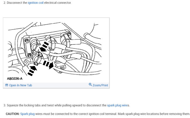

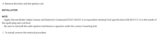

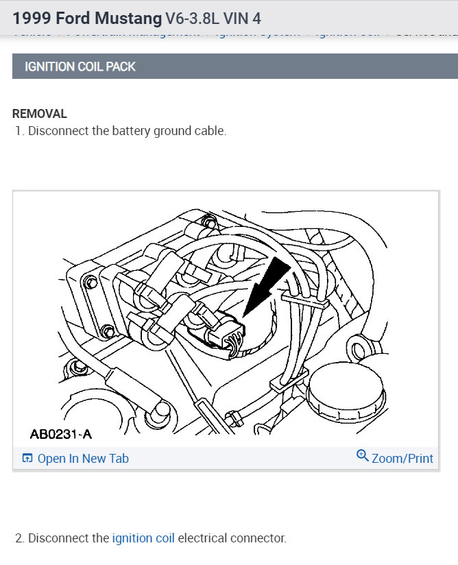

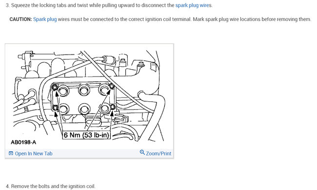

The trouble code P0352 in your 1999 Ford Mustang is related to the ignition coil system, specifically, "Ignition Coil B Primary/Secondary Circuit Malfunction.
I would swap out the ignition coil which can cause this code and make the engine run badly. Check out the images (below). Please let us know if you need anything else to get the problem fixed.
Oct 27, 2023 at 8:40 AM
CATMONKEE
I pulled the coil and tested it with my multimeter, and it tested fine. What I discovered was that the coil electrical connector plug doesn’t lock in place like it should. The locking tab is worn. I zip tied it, so it locks, and the car drives fine. It was working itself loose after running awhile. That explains why it always ran fine at first. Thank you for your help. You certainly pointed me in the right direction.
