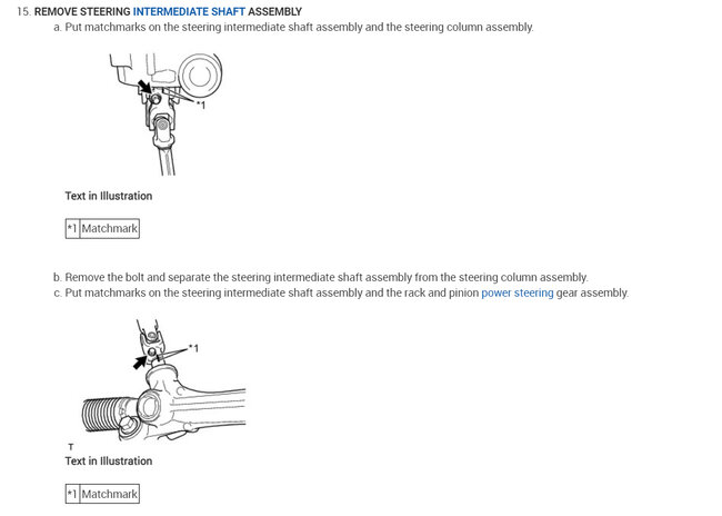

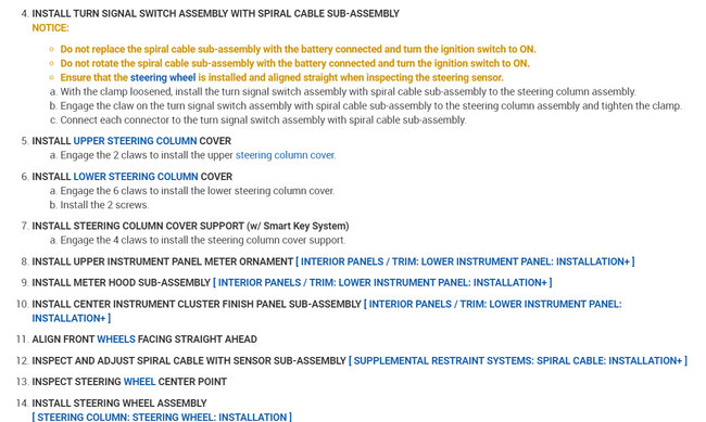

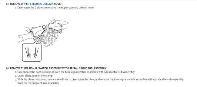

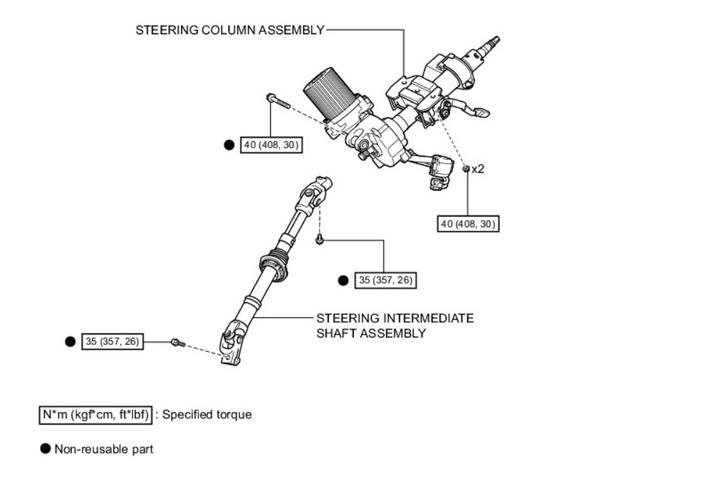

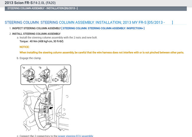

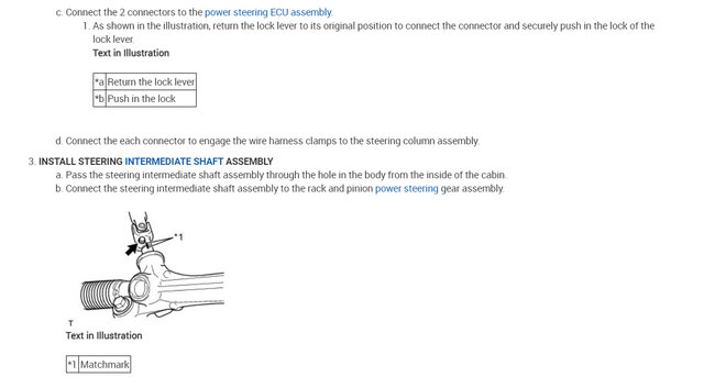

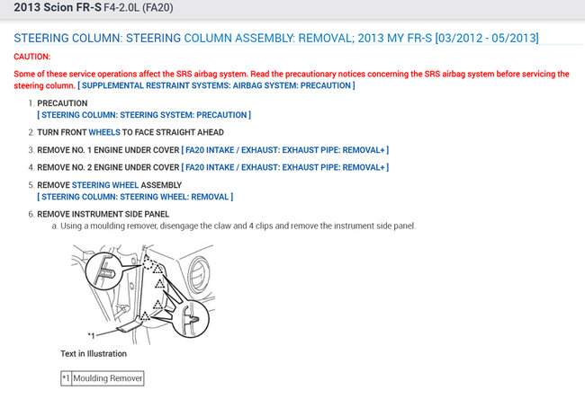

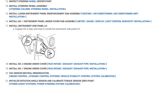

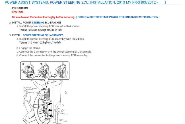

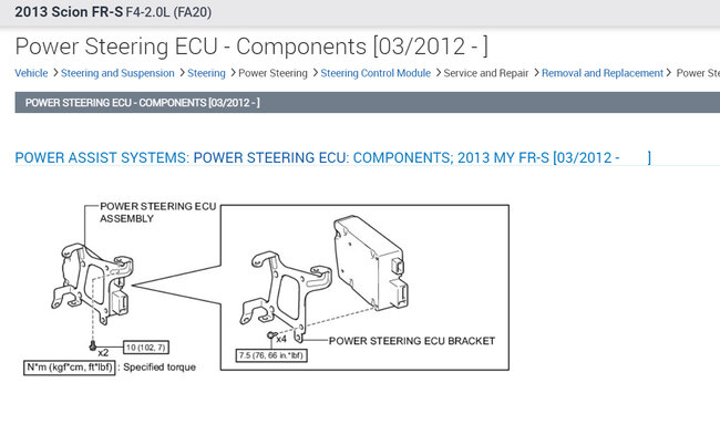

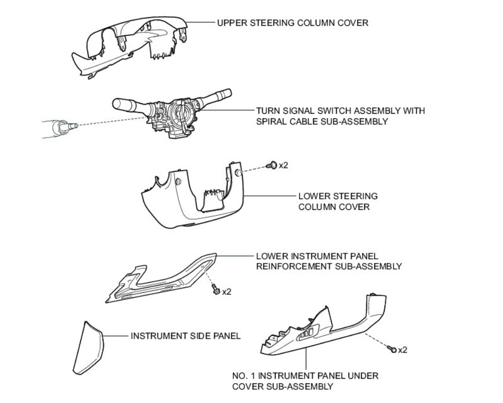

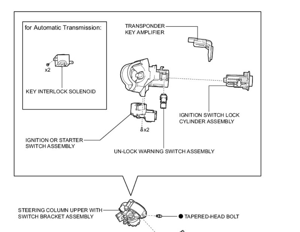

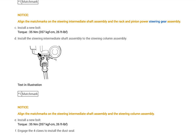

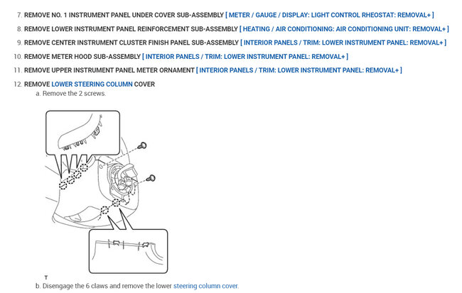

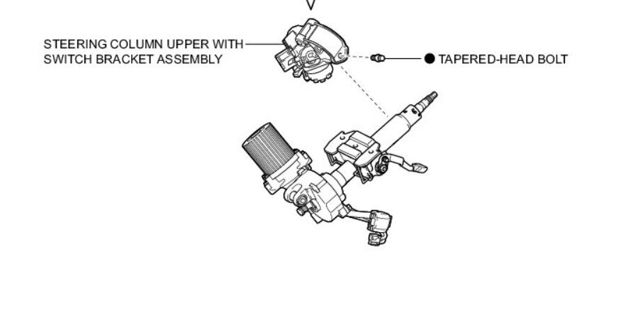

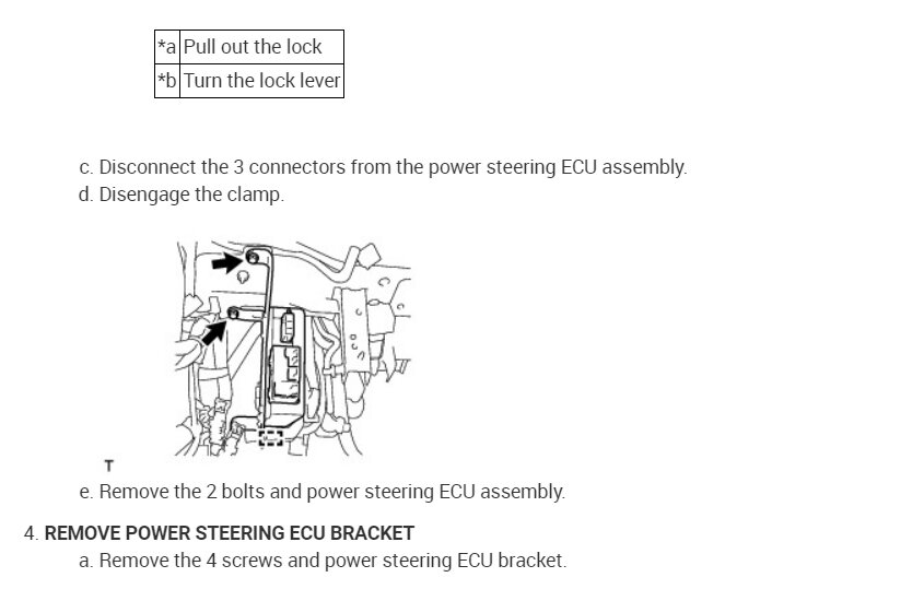

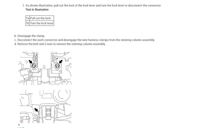

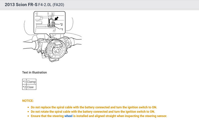

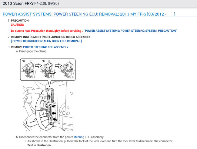

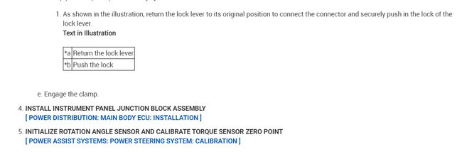

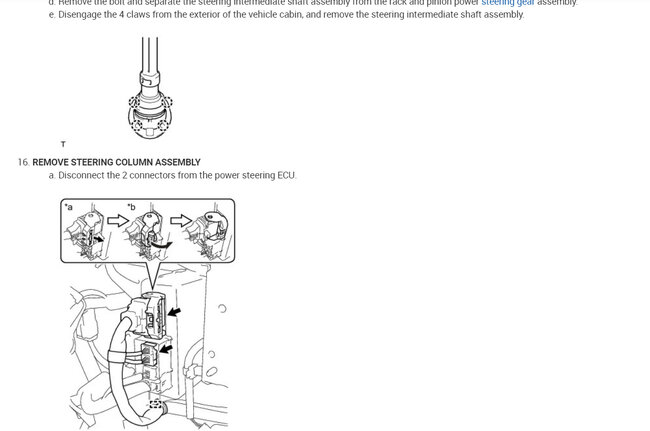

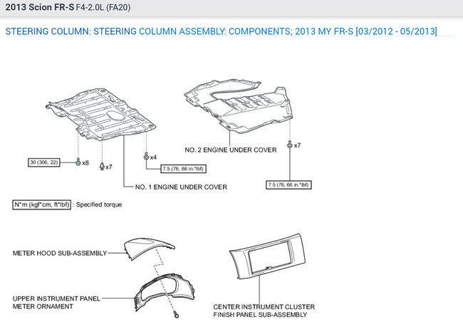

So it looks like the the steering motor has gone out and it may have affected the steering ECU, I would try replacing the motor first because they had problems with these and it could cause problems for the ECU. Here is how to replace them both. You can get a rebuilt steering ECU by searching google or ebay. Check out the images (Below). Please let us know what happens.
