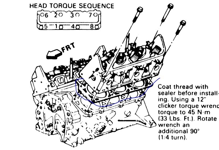

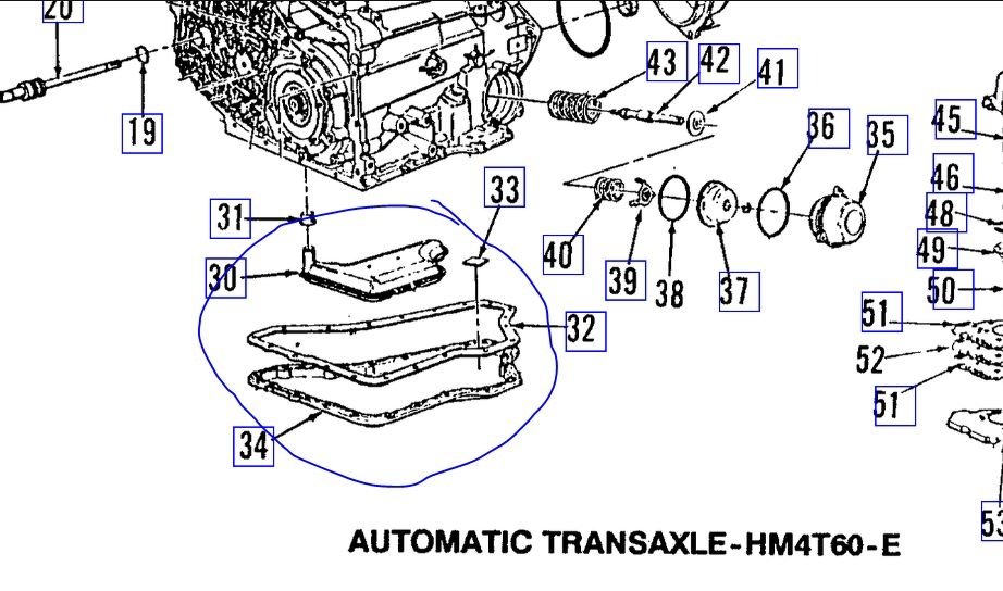

I would change the fluid and filter in the transmission. The filter may be partially clogged causing these issues.
As far as the smoking, does the car overheat? White smoke is an indication of a head gasket failure.
