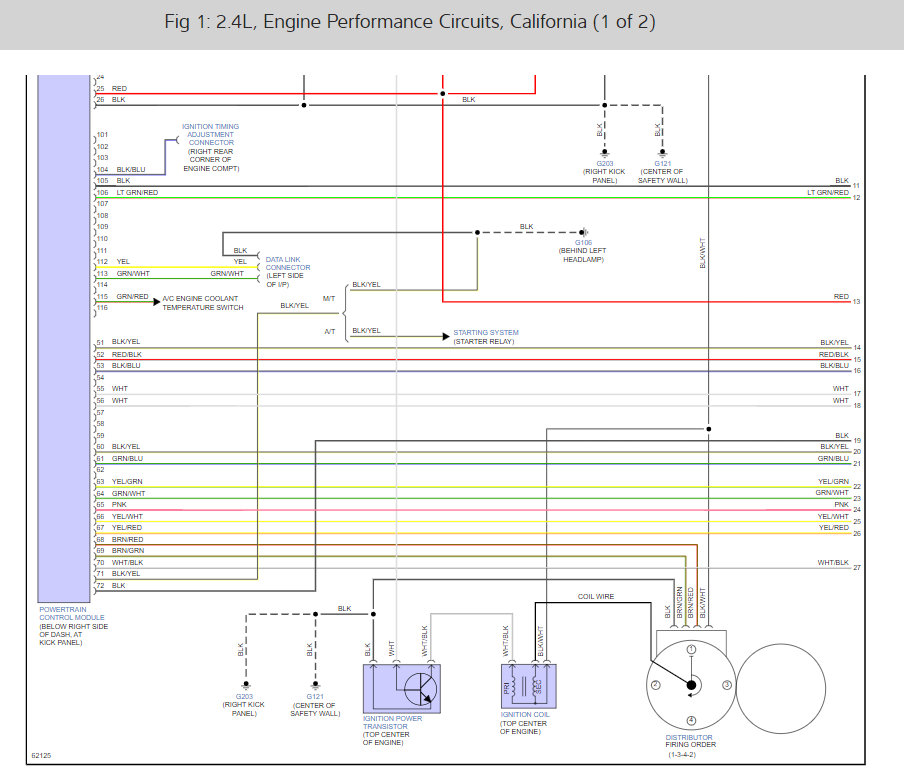

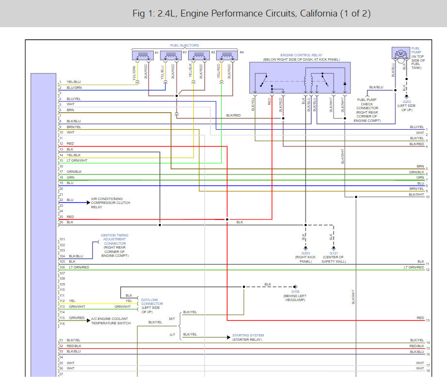

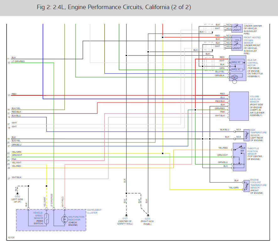

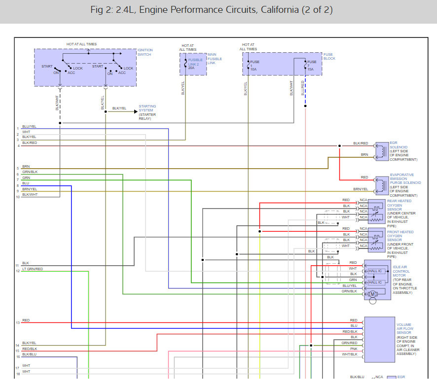

Here are the engine wiring diagrams which included the MAF sensor and I have included a guide to help you check the connections.
Check out the diagrams (below). Please let us know if you need anything else to get the problem fixed.

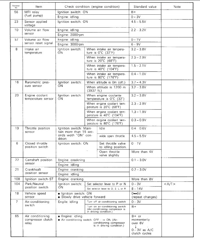

I need the specs of the connector pins/terminals such as the 5v/12v/MAF signal wire/ and others on the 7 pins.
Aug 11, 2022 at 1:31 PM
CERTIFIED EXPERT
53,855 POSTS
Sure, here you go. Check out the diagrams (below). Please let us know if you need anything else to get the problem fixed.
