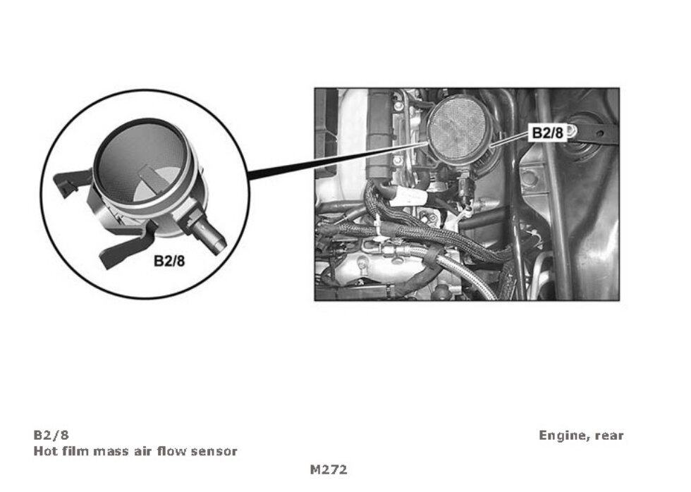

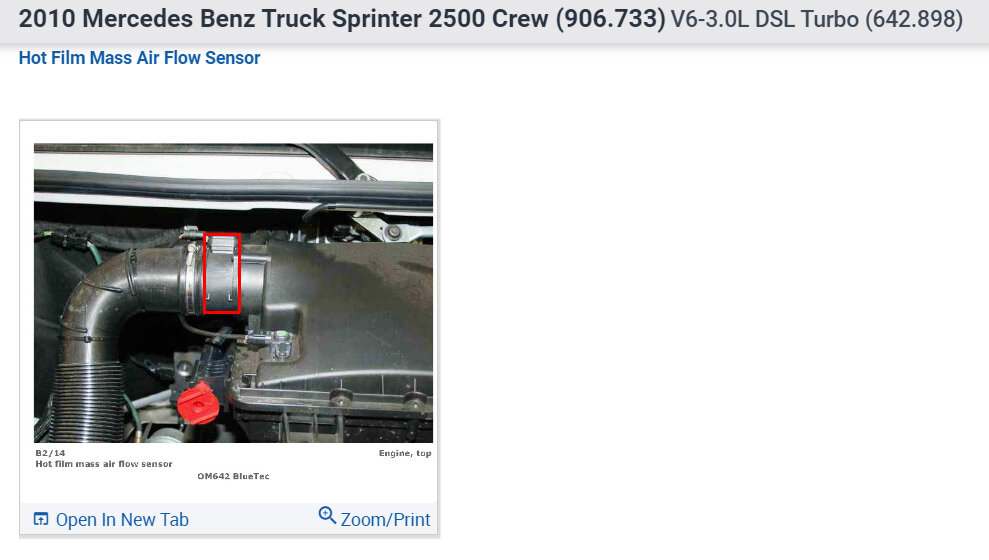

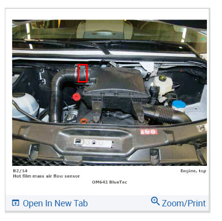

Each application will vary slightly due to engine wear and idle speed. What is the voltage with the old sensor? 1.84 volts pretty close to me but if you think this is a problem try and replace the MAF sensor and compare. Check out the images (below). Please let us know what happens.
