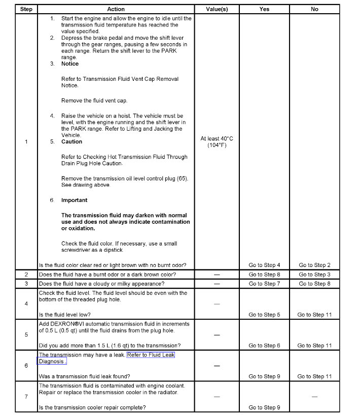

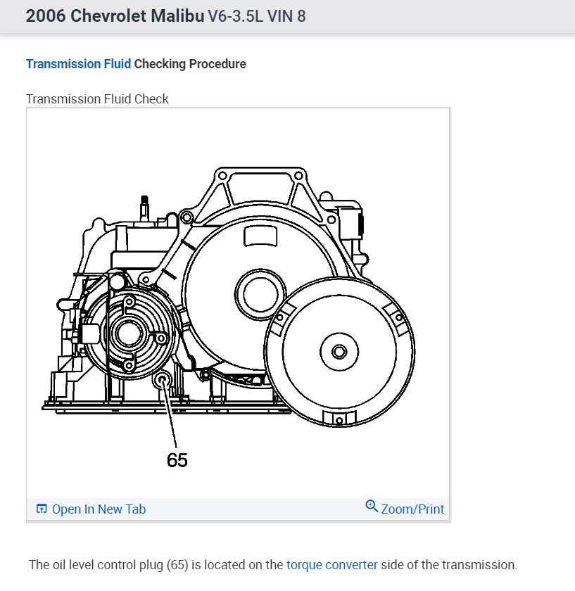

It sounds like the fluid level is low which is an easy check. Here is guide to help you with instructions in the diagrams below to show you how for your car:
https://www.2carpros.com/articles/how-to-check-and-add-transmission-fluid
AUTOMATIC TRANSMISSION 4T45-E
Bottom Pan Removal .................... 6.5 liters (6.9 qts)
Complete Overhaul .................... 9.0 Liters (9.5 qts)
Dry .................... 12.2 Liters (12.9 qts)
Measurements are approximate
This guide can help as well:
https://www.2carpros.com/articles/automatic-transmission-problems

Looks like there's too much fluid.
Jun 7, 2022 at 4:54 PM
Remove the plug and allow it to drain out to the proper level, this can cause the transmission fluid to get air bubbles in the fluid which can cause the transmission not to work. Make sure the engine is running while checking the fluid level.
