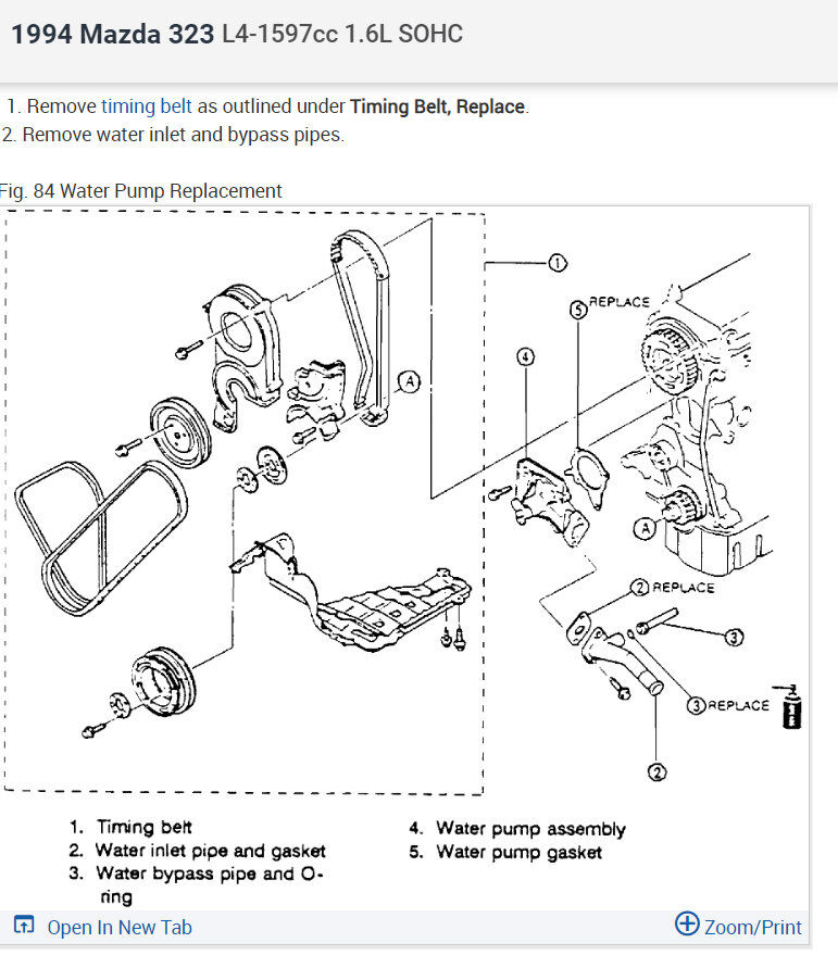

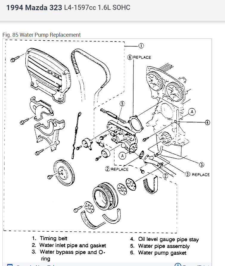

sound like it is coming from the water pump to me! to find it follow the belt routing. one of the pully's goes to the water pump.
Dec 8, 2007 at 6:16 PM
Yep, the water pump is behind the timing belt cover which I would replace as well. Here is the location of the water pump so you can change it out. Check out the images (below). Let us know how it goes
