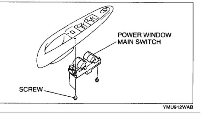

MRADAM
Electrical problem 6 cyl Two Wheel Drive Automatic 145000 miles
My wife rolled down the pass side sliding door window, and all the window controls stopped working, even the switches on the pass side. I checked ALL fuses and they are all fine.
Also, on the driver door window controls, the driver window button makes a buzzing sound when pressed. I removed the switch module and the sound is coming from the two small square modules mounted on the switch board. This sound only happens for the driver window switch.
I pulled the pass side sliding door panel and wired 12v to the motor to get the window back up (rain was coming), but am at a loss on what to do now.
Thanks for any and all help!
Adam
Jul 7, 2017 at 6:07 PM (Merged)
It sounds like the main switch has failed which is where all of the windows get their power from.
Here is a guide that will help you get the problem fixed.
https://www.2carpros.com/articles/electric-window-repair
Here is a diagram (below) of what it is on your car.
