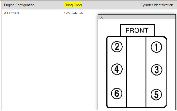

I would like to know the firing order of my vehicle listed above, GDI 6g74 engine. And how the injector harness is connected?

I have attached a picture of your firing order. Not sure what you are asking of the injector harness? Hope this helps and thanks for using 2CarPros.

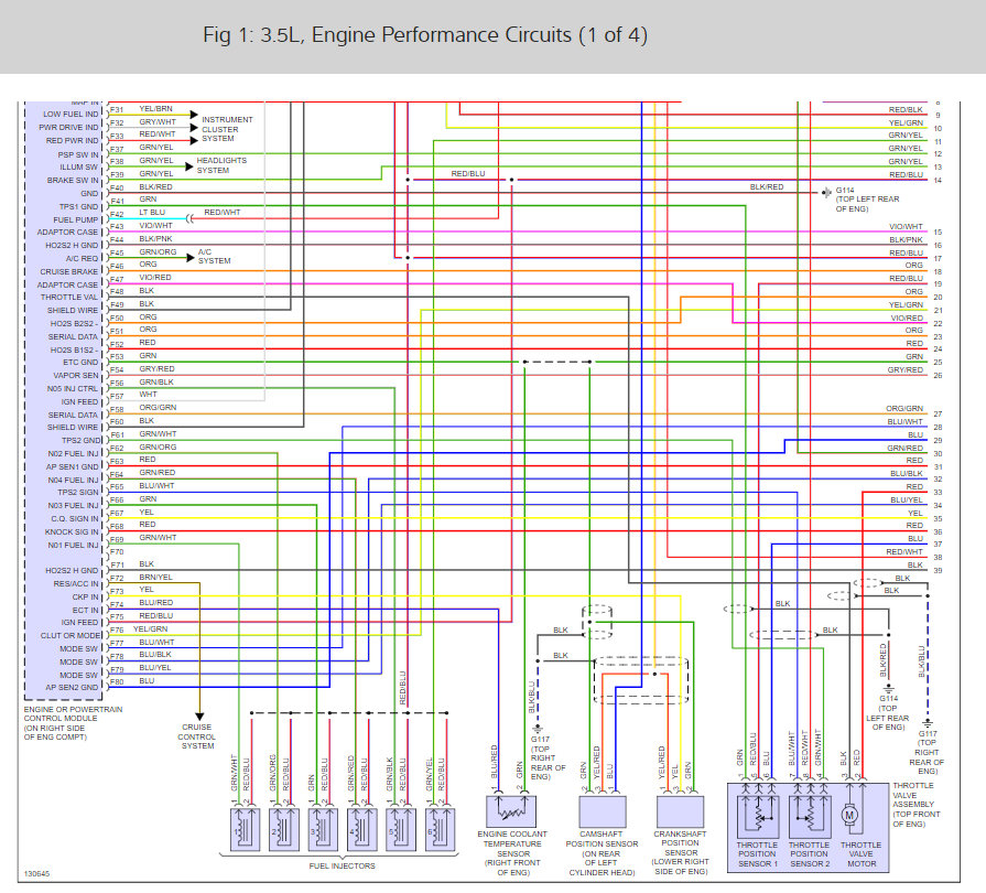

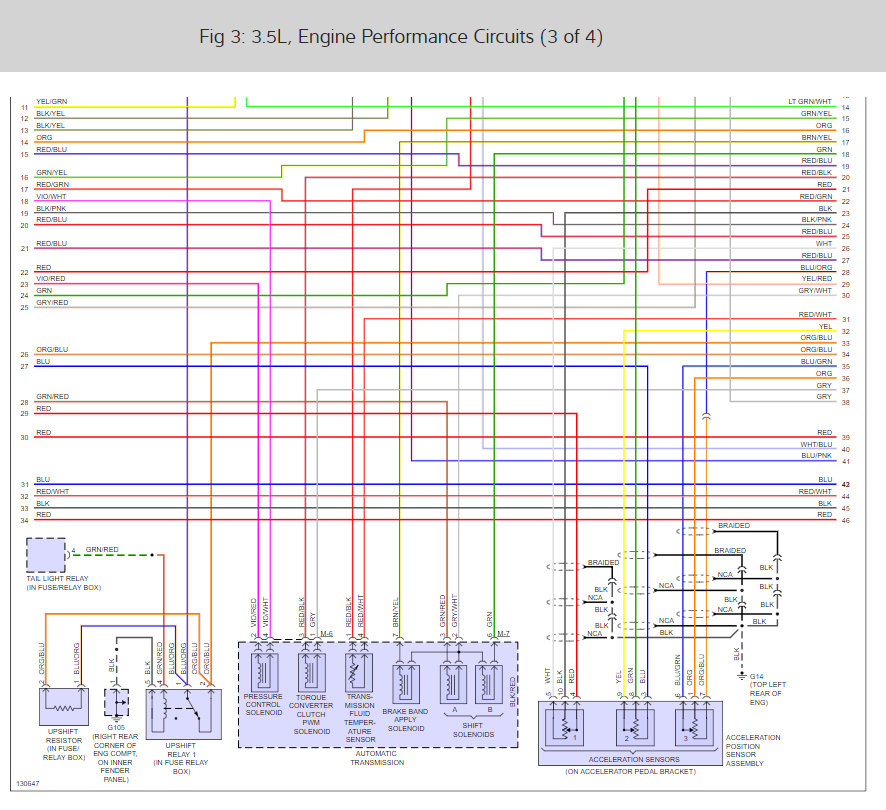

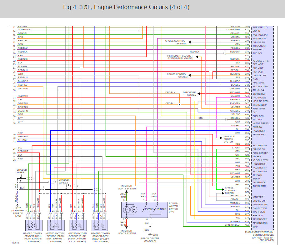

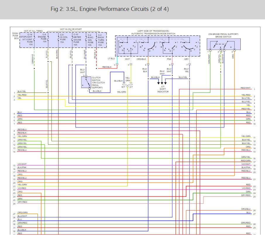

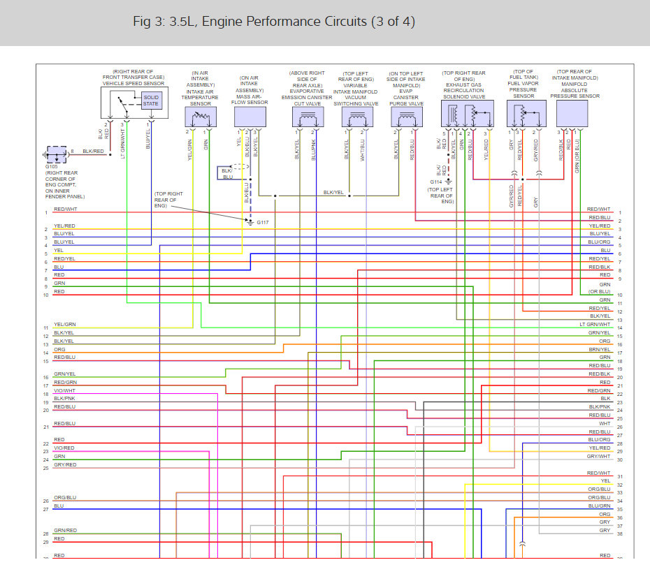

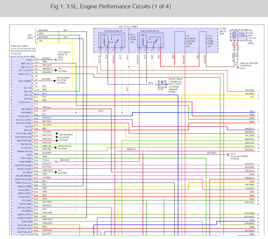

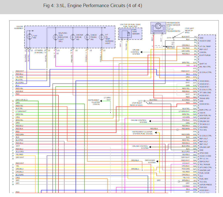

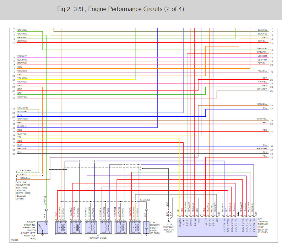

I found the engine wiring diagrams for you so you can see how the injectors are wiring up. This guide will help you test the wiring:
Check out the diagrams (below). Please let us know if you need anything else to get the problem fixed.
