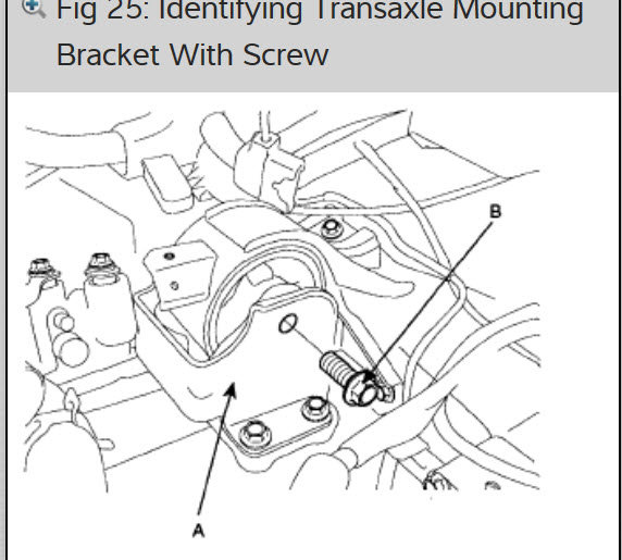

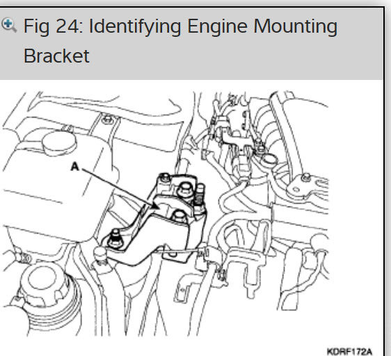

how many total mounts are there and what is the name besides mount, ie: lower , rear, etc?
is there a diagram with the approximate location of each mount?

there may be three our manual is not real clear on this as I only show two one is front and other is trans-axle. See pictures.

I finally broke down and called Hyundai and they told me there were three plus the one for the transmission so I guess that's actually four, anyway that's what I did because we found two for sure broken probably a third, I said replace all. still waiting for two of the mounts to be shipped.
