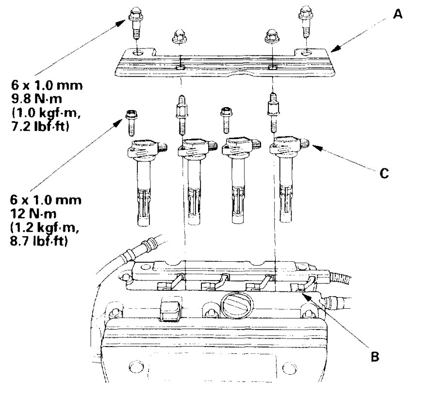

It is common for the ignition coils to go out, but I need to ask if you have run the codes to see if any are stored?
This guide can help:
Here is how to change the ignition coils out correctly. Check out the images (below). Please let us know what happens.
Image (Click to enlarge)
