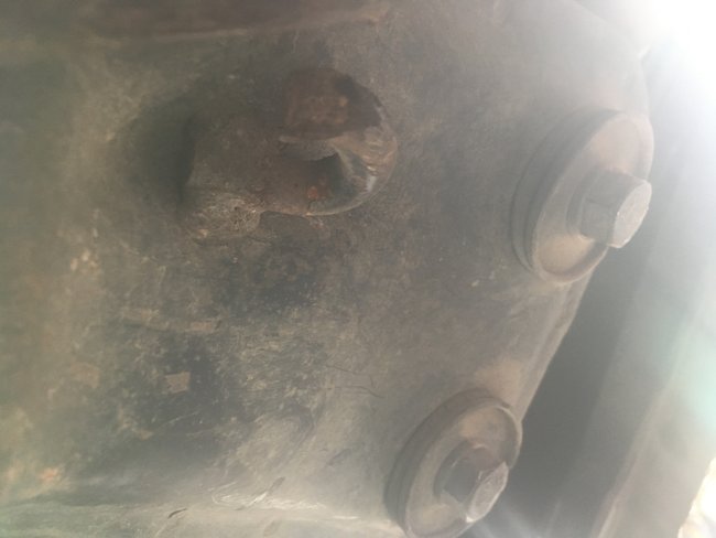

Easy replacement. I agree with my fellow techs to replace the pan for piece of mind.

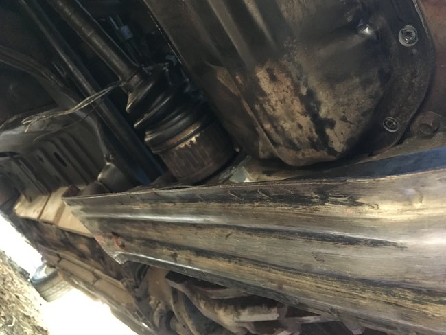

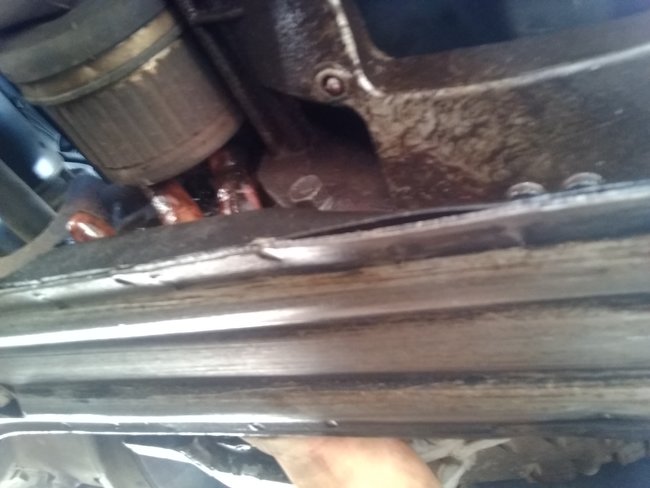

I attached a picture of most likely what you see.

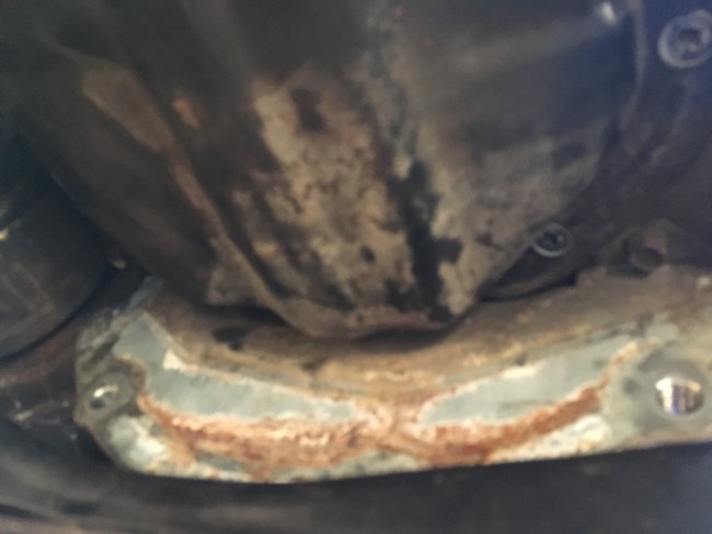

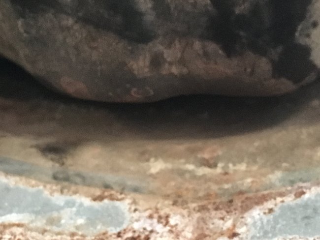

Okay, so I have started taking the oil pan off but the last two bolts I cannot get to because my socket will not fit in the space they are in. In the picture could you tell me what am I supposed to take off next to be able to reach the bolts?
May 2, 2018 at 3:36 PM
Remove the cover for the torque converter. that is the plate back by the rear of the oil pan.
Then you may need to remove the cross member if you do not have flex sockets for the bolts.
May 2, 2018 at 3:41 PM

This does not have a torque converter.

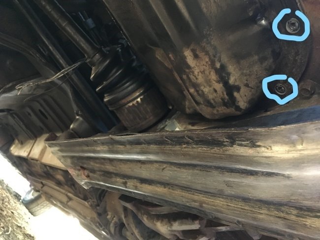

Can you circle them so-called bolts you are trying to get to?
I see either bolt holes or maybe allen head bolts but I cannot be sure, I even zoomed in on the photo.
Are these them?
May 2, 2018 at 5:40 PM
ROSE AKASHORTY CONLEY
  • 30 POSTS
No they are in the crack at the end of the oil pan. I have already gotten the shield off.
May 2, 2018 at 7:51 PM
  • 30 POSTS
I have already gotten the shield off but my socket still will not fit. You cannot see the bolts because of the angle they are in.
May 2, 2018 at 7:55 PM
Do you have sockets that can change angles? If not, then the cross member will have to be removed.
May 3, 2018 at 3:44 AM

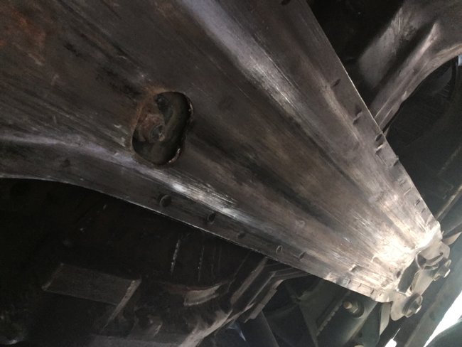

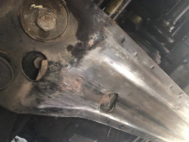

I want to make sure I am taking off the right thing, this is the cross member, right? And these are the only bolts I have to take off?
May 3, 2018 at 6:27 PM
That is correct. That is the cross member.
May 4, 2018 at 4:13 AM

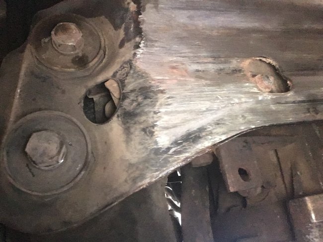

So I just wanted to make sure one more time that this is the cross member and I am supposed to take it off because when I got the four main bolts undone it looked like the engine was going to drop on me. am I taking off the wrong thing?
May 7, 2018 at 12:01 PM
That is the cross member. You should support the engine. Put a jack under the transmission to prevent it coming down.

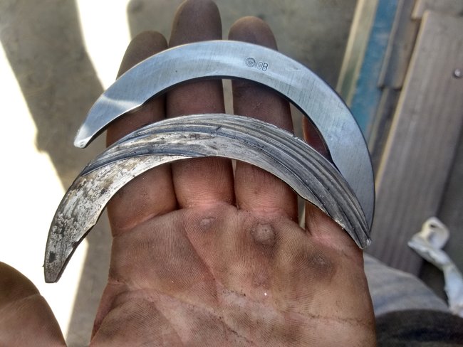

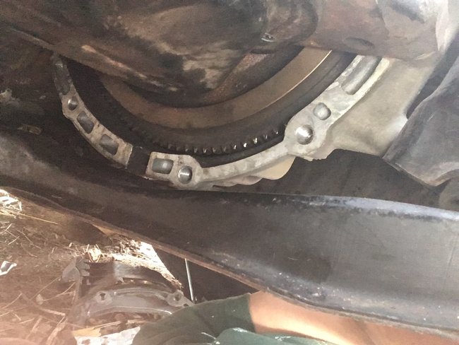

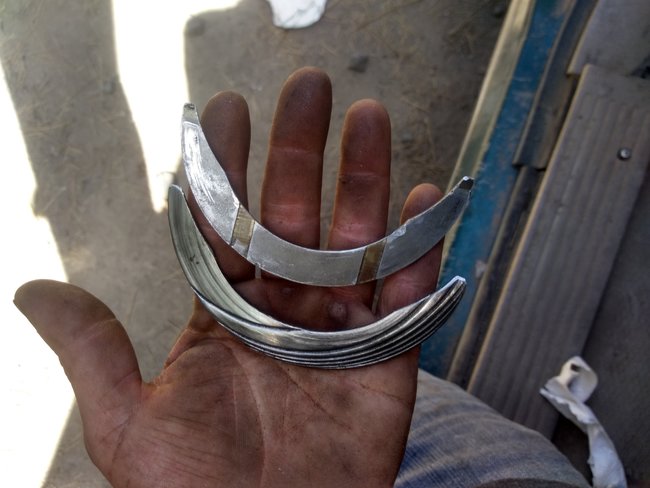

About two months ago I changed my oil pan, when I dropped it I found these laying at the bottom, can anyone tell me what they go to why they broke off and are the important? Also, now about a week ago on my way home, not only did my wheel break but oil started pouring out from the right side (if your looking at the car) above the oil pan, can anyone tell me what to look at first?

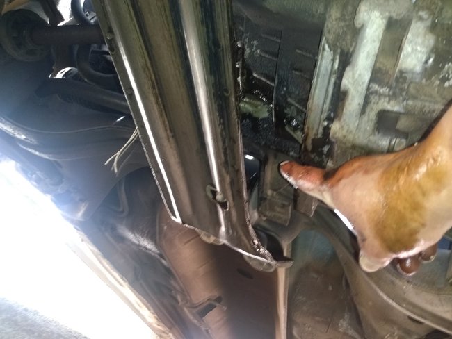

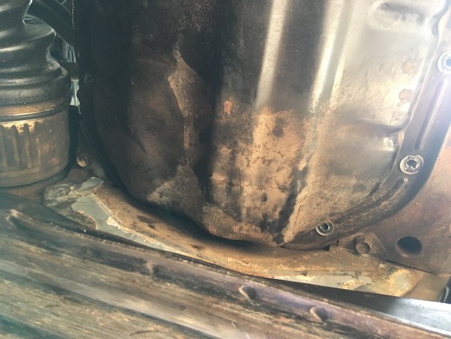

Here is where I can feel the oil leaking from when I jacked it up oil started leaking out from there.
