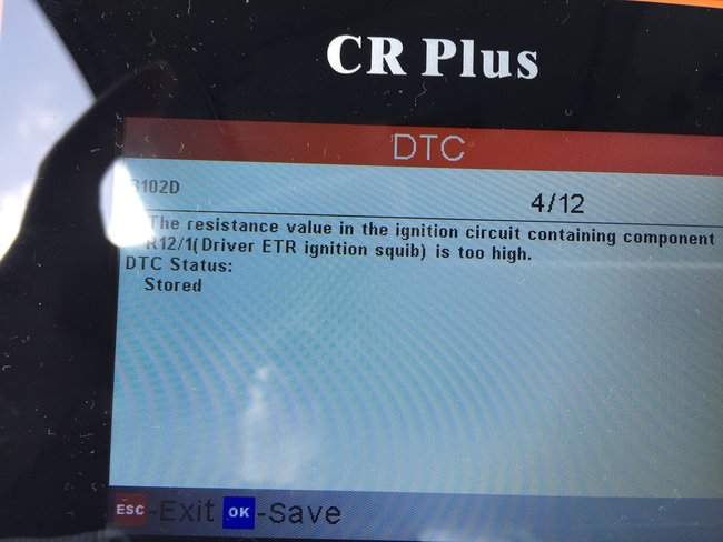

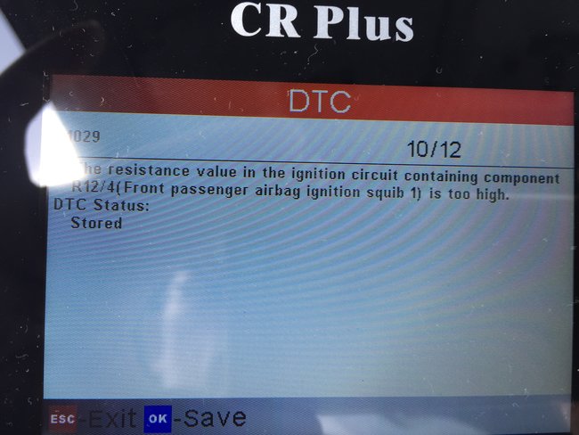

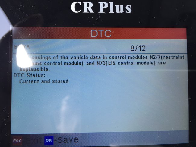

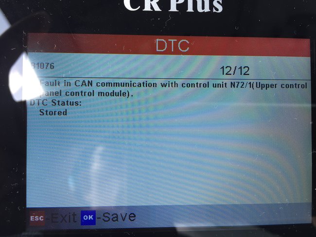

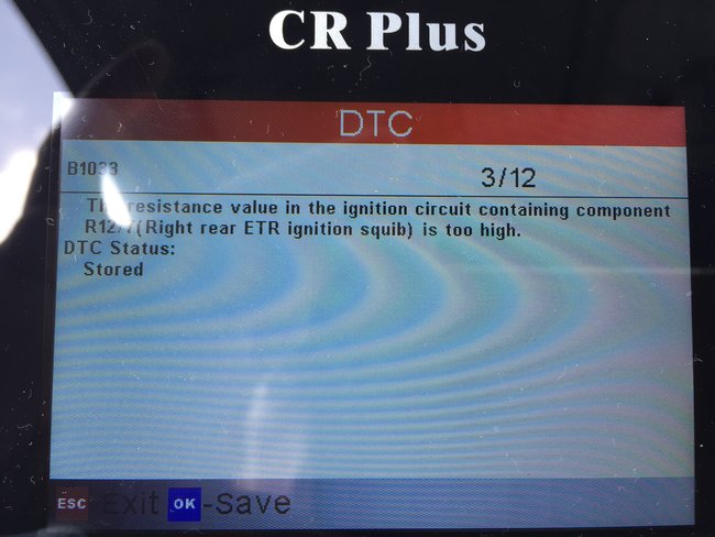

The scanner shows DTC as follows;
1. B102B
2. B102D
3. B106C
4. B107A
5. B107B
6. B1003
7. B1025
8. B1027
9. B1029
10. B1031
11. B1033
12. B1076
Sir, please help me to know exactly what is to be done/changed.

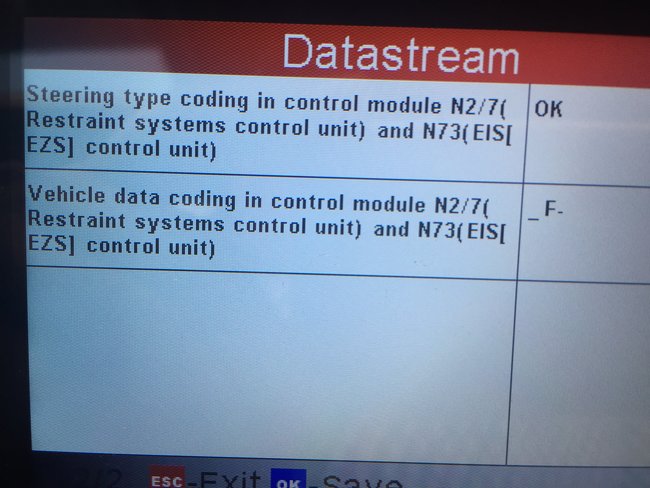

Aug 14, 2019 at 10:55 AM
VIVEKHB
  • 91 POSTS

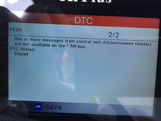

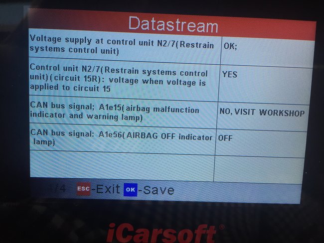

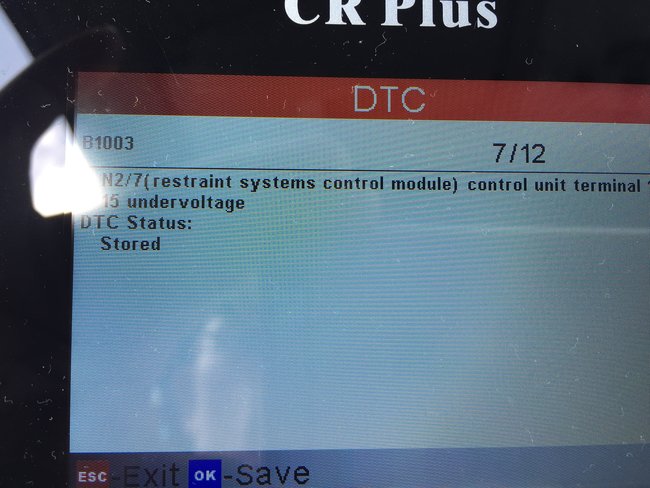

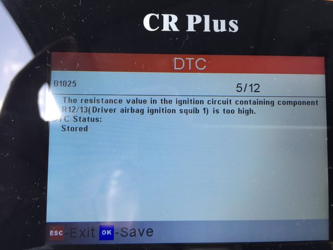

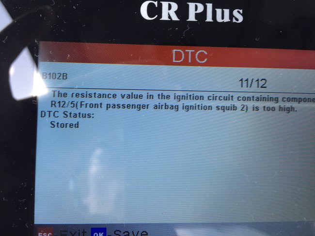

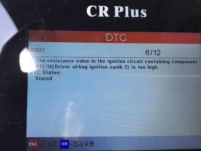

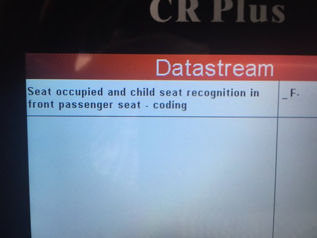

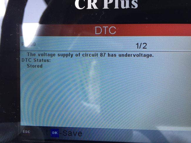

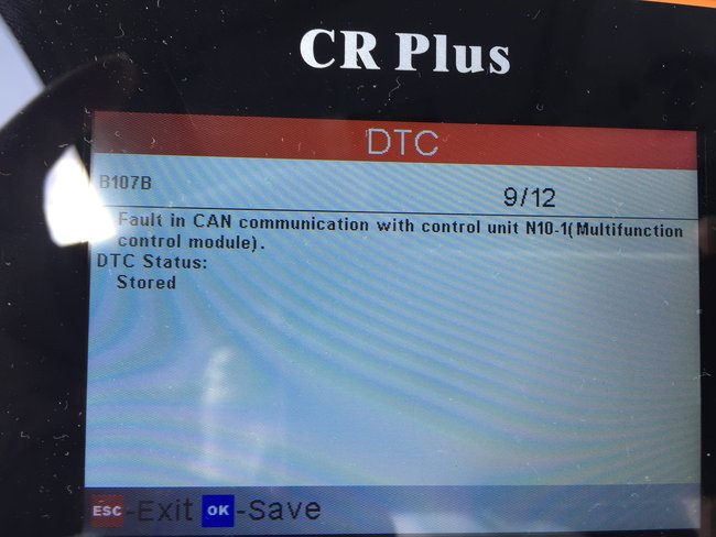

Sir,after I tried but the codes could not be erased.The data stream shows as follows ,
Aug 17, 2019 at 4:59 PM

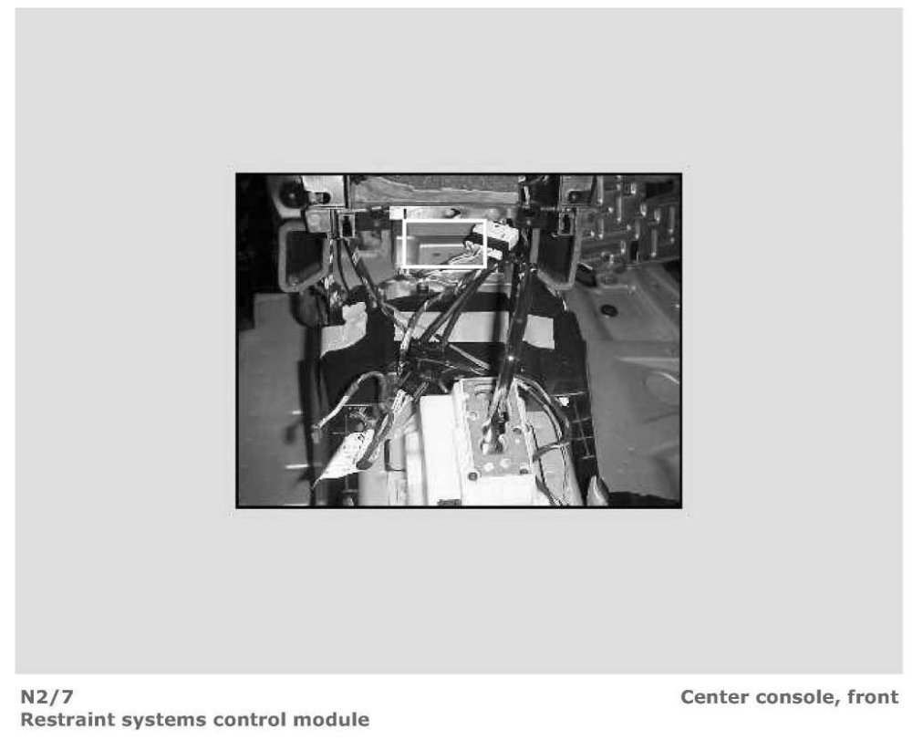

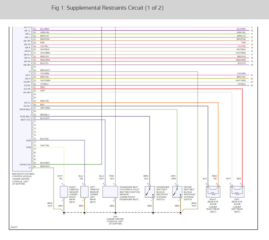

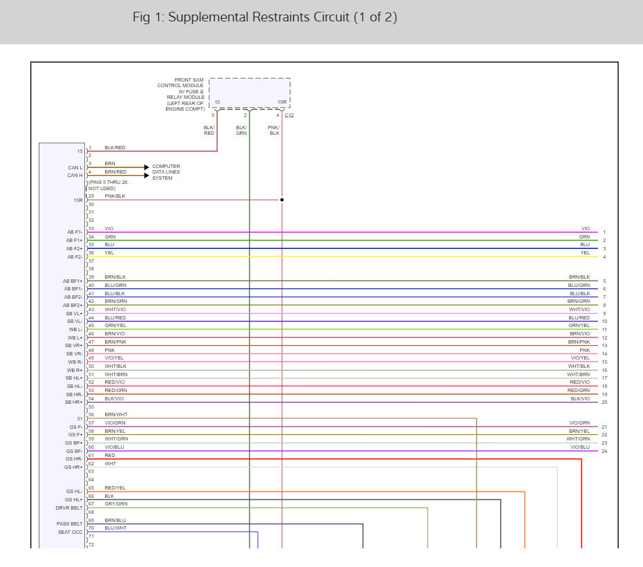

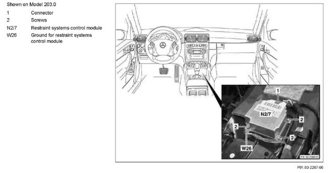

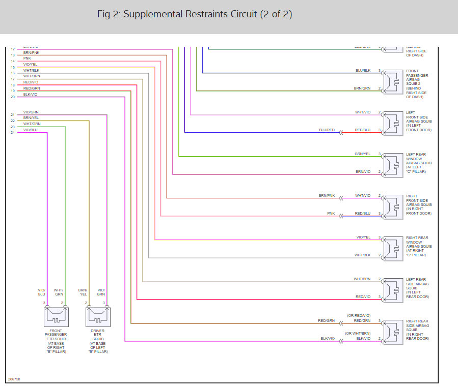

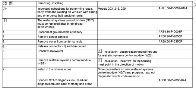

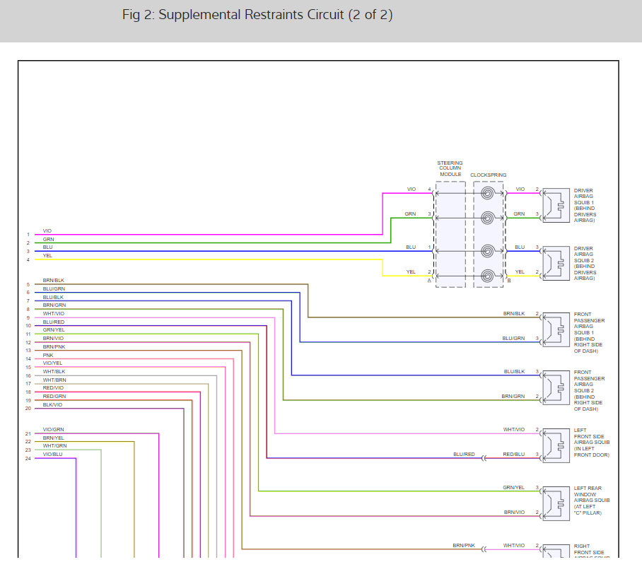

Okay, it looks like the CAN is not working due to the failure of the airbag control module. To be sure here are the airbag wiring diagrams so you can test for power and grounds with the airbag module replacement instructions:
Check out the diagrams (below). Please let us know what you find.
