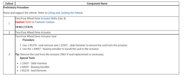

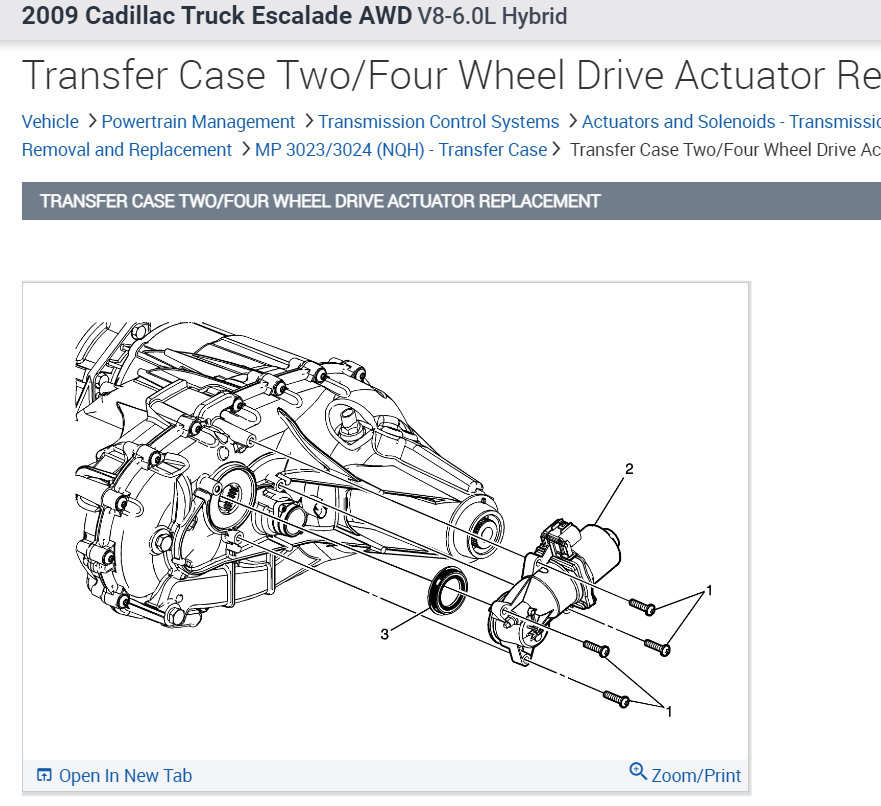

Yep, this happens 9 times out of 10 the transfer case actuator motor has failed but we should run the codes to see what comes up, I also have included the actuators' location so you can replace it in the diagrams below.
