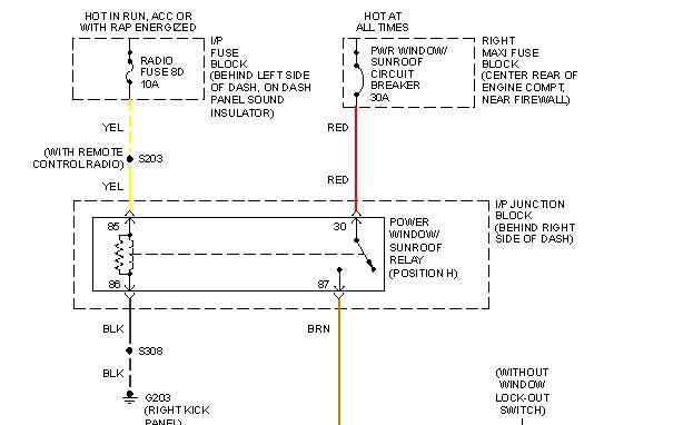

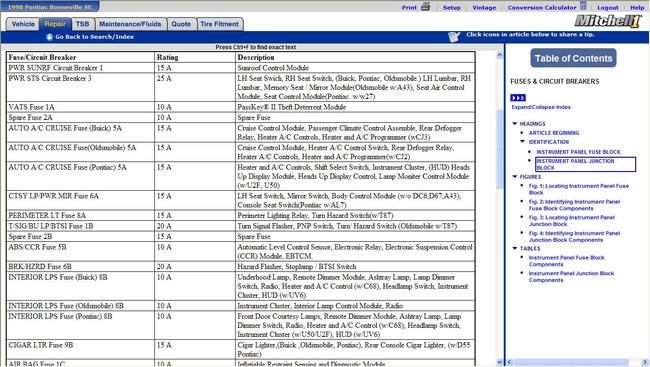

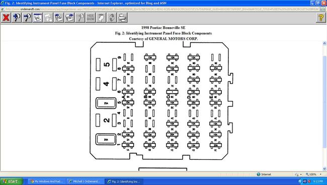

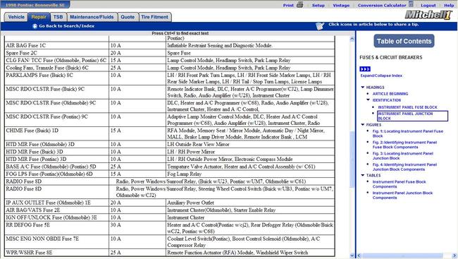

OK....SO LIKE I WENT INTO "MITCHELL I" AND GRABBED YOU .....RATHER MADE YOU 3 SCREENSHOTS
LEMME KNOW IF THEY HELP

check all three in pic........
