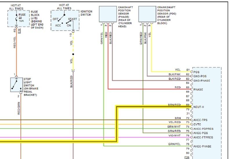

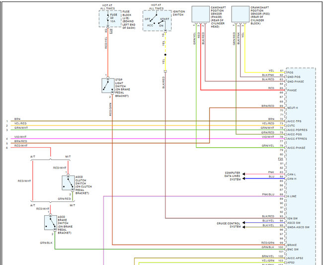

I was very disappointed to find such a lack of information for this model. There are no original manufacturer diagrams. This first diagram is an aftermarket version, but being much too small to see, I posted just an enlarged section with the cam and crank sensors. They also didn't provide any connector views. I found this second drawing in the sensor testing information. At least it shows the positions of the three terminals.

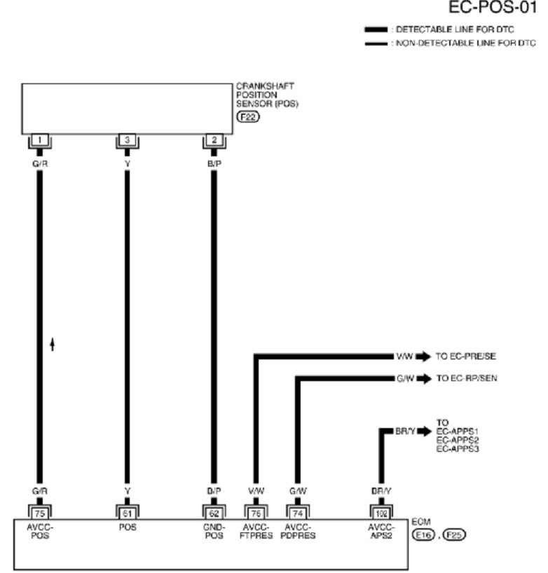

I don't think there is a 12-volt power source, only 5-volts, ground and signal. This is the wiring diagram for your car. Check out the images (below). Please let us know what happens.

my connector and sensor have 3 wires not 2, on the diagram you sent me what does avcc pos mean, then gnd pos.and then pos,,thats where the 3 wires lead to on your diagrm for vcrankshaft position 1,2, and 3..is position 1power? ,position 2 ground?and position 3 signal?

There's two versions; one for vehicles sold in California and one for everywhere else. I posted the one for everywhere else, but the differences are not likely to involve the crankshaft position sensor. Ken found the same diagram. What I posted was a cropped and expanded version for just the two sensors so it's easier to read. As I mentioned, I was surprised and disappointed to find no manufacturer diagrams on the service manual site we use. Their aftermarket version is all they have for your model.

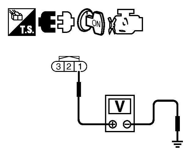

The way to pursue this is to look at the three wires for the crank sensor. They show them as yellow, black / pink, and green / red. That means black with a pink "tracer" or stripe, and a green wire with a red stripe. Next, it shows they go into terminal locations 3, 2, and 1 in the connector. I found the second drawing in the testing section that shows the orientation of those terminal numbers. Nissan uses a lot of non-standard terminology, but if I'm reading this the same as from other manufacturers, that connector is viewed as from the terminals toward you, (the wires away from you), and the locking tab is on top, then the numbering is as shown, 3, 2, 1, from left to right.
The wire in your new connector in cavity number three gets spliced to the vehicle's yellow wire. The wire in cavity number 2, (in the middle), is spliced to the vehicle's black / pink wire. The last wire in the new plug, cavity number one, goes to the vehicle's green / red wire.

Here's another diagram that shows this circuit.

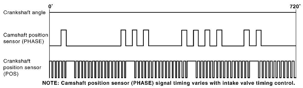

For your viewing pleasure, here's the drawing that shows the signal waveforms for the two sensors. You'll note there's no voltages shown because they aren't critical to this story. The computer looks for the "rise time" or the "fall time" for each pulse, and the relationship between the pulses for both sensors. The computer also counts the number of pulses to figure out where the camshaft and crankshaft are at any time. From that, it calculates when to fire an ignition coil and an injector. This waveform is for two crankshaft / one camshaft revolutions.

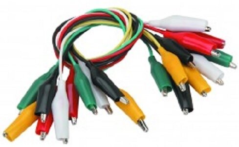

Forget the meter. That is going to make this too confusing. All you need to look at is the vehicle's wire colors and the three locations in the connector. If you still aren't 100 percent certain, use three "clip leads", (jumper wires) to make the connections, then see if the engine runs.

If you feel safer using the clip leads first to be sure you have the wires in the right spots, you can find a pack of about 10 at Harbor Freight Tools for less than $5.00. The photo below shows what they look like. Of course, it's just as easy to strip off a half inch of insulation from each wire, then just twist the ends together for a temporary test.

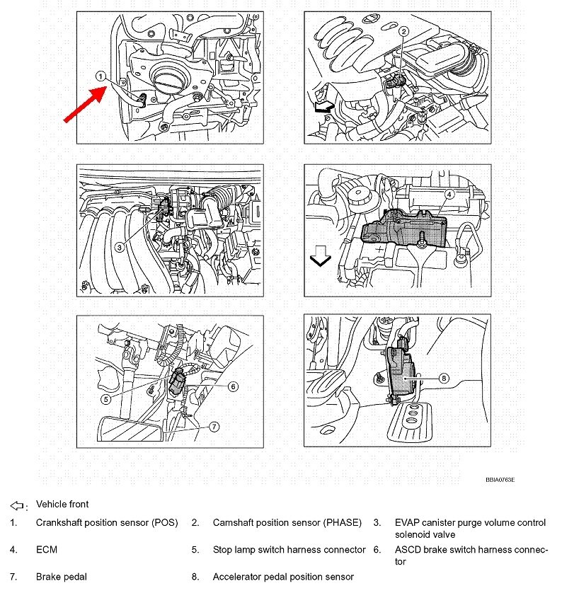

I did finally find the manufacturer's diagrams for Powertrain Management, but no wire colors were shown, so they're rather useless. Next, I searched through the aftermarket diagrams that I picked the previous section from, and can't find anything with three brown wires. I did find brown wires related to an ignition coil, the mass air flow sensor, and the intake air temperature sensor, but all of the brown wires have stripes on them, and no two go the same component.
Take a look at this drawing to be sure we're looking at the same thing. The blue arrow is pointing to the crankshaft position sensor.

yes, i'm positive it's the crankshaft sensor,located in the back of engine,it was really hard to access it. i had to put the 8 mm socket on bolt by feel to remove the small heat shield,and then the 10 mm socket on the sensor bolt by feel, i had to go under the car to get to it;.and it has 1 darker wire and 2 lighter brown wires with no stripes on any of them,and i cut thetube back that holds the wires in case the heat had turned them brown,but they were same colrs in tube.
