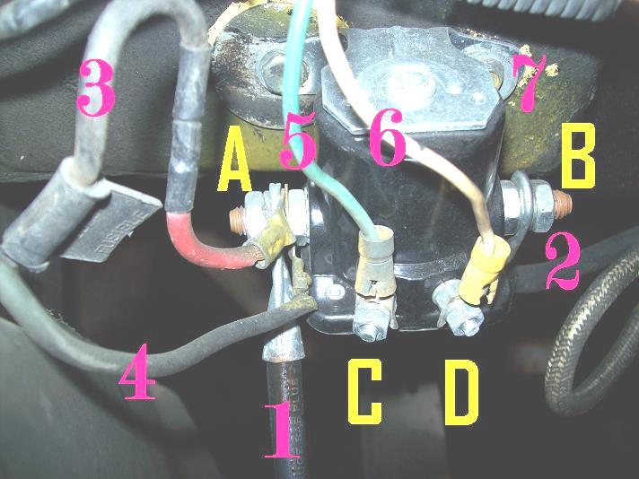

YOU ARE GONNA HAVE TO FIND WHERE YOUR WIRING DRAWS IT'S POWER FROM THE BATTERY
ON THE JEEP IT'S AT THE SOLENOID, WHERE THE POSITIVE BATTERY CABLE IS STACKED TOGETHER WITH A WIRE TO THE ALTERNATOR AND THE OTHER TO THE FUSE BOX
IN MY PIC (OF MY '46 WILLYS, WHICH I COMPLETELY WIRED TO CLOSELY MATCH A 1979)
"1" IS THE POS CABLE FROM MR. BATTERY
"3" RUNS TO THE ALTERNATOR (HAS A TAG ON IT)
"4" RUNS TO THE FUSE BOX (NO MARKING AT ALL)
THE 1st FEW INCHES OF BOTH OF THESE WIRES ARE FUSIBLE LINKS (THEY ARE RATED IN "GAUGE" SIZE) BASICALLY THEY ARE SACRIFICIAL WIRES, LIKE FUSES. THEY ARE AT THE BEGINNING OF THE WIRE TO BE PROTECTED, AND COULD BE IN OTHER LOCATIONS.
IN THE PIC, IT ALMOST APPEARS THAT 3 AND 4 ARE THE SAME WIRE IN A LOOP, THEY ARE NOT!
WHEN A FUSIBLE LINK "GOES", THE WIRE USUALLY DISINTEGRATES
YOU CAN TEST WITH A 12 VOLT TEST LIGHT FROM STARTING AT "GOOD 12V" THEN STABBED INTO THE WIRE AND GET NO VOLTAGE (OR VOLTAGE)

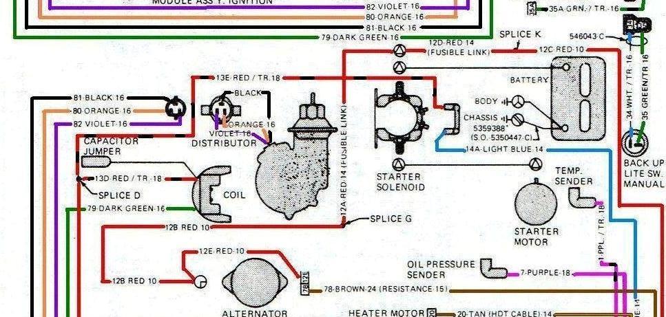

MY SECOND PIC IS A LITTLE CHUNK OF A 1979 JEEP CJ DIAGRAM. I SORTA ZEROED IN ON THE SOLENOID (MY OTHER PIC HAS MY WIRES REVERSED FROM THE WAY THE DIAGRAM SHOWS)
WHAT'S IMPORTANT IS THE BATTERY CABLE STACKED BESIDE THE "FEED WIRES" ON THE SAME BIG TERMINAL, AND THE STARTER CABLE ALL BY ITSELF ON THE OTHER BIG TERMINAL
2nd DIAGRAM SHOWS THE FUSIBLE LINK "VALUES/ GAUGE" THEY SPLICE ONTO THE REGULAR WIRES AT "SPLICE G" AND "SPLICE K"
IT APPEARS THAT THESE 2 WIRES CONNECT AT THE CIRCLE W/ TRIANGLE INSIDE, ACTUALLY, THE CIRCLE THINGEE IS 2 STAKE-ON RINGS STACKED TOGETHER.

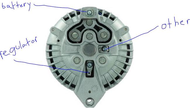

So is the system working? If not, lets clear up the wire colors. On cars, the fat output wire from the alternator is a black wire bolted to its terminal. The two smaller wires plug into the brush terminals. The 12-volt feed is dark blue, and the control wire going to the voltage regulator is green.
The dark blue 12-volt feed wire was often a red wire on trucks. When you mention the red wire, is it one of those smaller brush terminals which is also found in the regulator's plug, or is it the fat output wire?
Dec 26, 2017 at 2:34 PM
TROUBLE0
  • 15 POSTS
ok on mine the 12v lead is red. otth

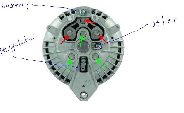

Is that the fat output wire that's bolted to the large terminal on the back of the alternator or one of the two smaller ones that slides onto one brush terminal?
Dec 29, 2017 at 4:27 PM
TROUBLE0
  • 15 POSTS
Have to start new thread having issues with this message board lag. And yes, to answer your question

Are you purposely trying to make this confusing? I asked which wire is red and your answer is "yes"?
The lag in replies is because I had a major house fire a few years ago, and I don't have internet service. I have to trudge outside where it's 9 degrees below zero, hope my van will start, drive 21 miles round-trip to find someplace to connect to a wireless service, and hope I don't have to do that from inside my van with an inoperative heater, all so I can try to help people solve their car problems. I can't stand the cold for more than a few hours, so I head back home where I can squat in front of a little space heater. If you don't reply back within those few hours, I won't see it until the next day. This is why I'm not skipping any days. I'd rather stay holed-up in my garage where I'm warm.
There is no one who knows more about this charging system than me. That isn't hard because there isn't much to this system, and very little that can go wrong with it. If I'm standing next to the vehicle, with a voltmeter in hand, I can have it diagnosed within 30 seconds. Since I'm not by your truck, you have to be my eyes and hands. I'm driving to town every day for your benefit in spite of asthma attacks triggered by cold air. The only variable that is making this diagnosis so difficult is your less-than-complete answers.
This charging system, in my opinion, is by far the world's best system ever developed, and is extremely easy to understand and diagnose. It is the system I always used first when teaching charging systems to my students because once they understood basic electrical theory, it only took ten minutes for them to understand this system and become proficient in repairing it.
This entire system can be diagnosed by taking voltage readings from the three wires on the alternator. The only thing that might be different, since this is on a truck, is the wire colors. Three wiring harnesses were used. One has two red wires on the alternator. One has only one red wire, and the cars had no red wires. If you won't tell me the exact colors of the fat output wire and the two small plugged-in wires, I will most likely unintentionally add even more to the confusion. This conversation has gone on for over a week. We should have had it solved in one night.
The person who started this conversation said the voltage went to 19 volts, then to 8 volts, and he drove home with no trouble. Those do not agree. I’d call 8 volts a problem. 13.75 to 14.75 volts is “no trouble”, but he didn’t say the voltage went back to normal.
The alternator does not have any control over its output voltage, yet he removed it for testing. That is the least-effective way to test it as you’re not including the rest of the system in the tests. A failed alternator would never put out 19 volts, so we know it was okay.
Chrysler’s electronic voltage regulator was the first one used by any manufacturer, and is extremely reliable. I’ve owned dozens of these cars since 1972, and have only had one failure. Replacing one because it’s old doesn’t make sense. A new one has a much higher chance of failing than an old one that has proven itself over time.
The resistor he mentioned is part of the ignition system, not the charging system. That should be a dual ballast resistor. Among all the other innovations Chrysler developed, including the alternator , (1960), and electronic regulator, (1970), they were the first with fully-electronic ignition, (1972 on Dodges and 1973 on Chryslers and Plymouths). He mentioned breaker points, but that truck did not come with that out-dated system. If he has a breaker-point distributor, it is because Chrysler was famous for great parts interchangeability, and someone popped in the older distributor because they couldn’t figure out how to diagnose the simple electronic system.
This all started with a grounded wire that was found. If it went to the ballast resistor, it was the 12-volt feed wire coming from the ignition switch. That same wire feeds the electric automatic choke heater and one of the small wires plugged into the alternator. That wire is always dark blue on cars and on SOME trucks. If I knew which color that wire is on your truck, it becomes real easy to describe how to diagnose the system. If I call it “blue”, and you don’t have a blue wire, what are you going to do?
The next point of interest that most people don’t know is an alternator is physically incapable of developing more current than it is built and rated for. It can not overheat and burn a wire unless someone replaced the output wire with one that is too small in diameter. We know he wasn’t running alongside the truck to replace that wire, and since the system had been working fine for years, that wire is not the wrong gauge. Knowing those things, we know something else besides the alternator is the problem.
The biggest clue that I overlooked is the “Volts” gauge dropping to 8 volts. All Chrysler products through the early ‘80s, and some models through the late ‘80s used a more-informative “Amps” gauge. I suspect he has an after-market “Volts” gauge. If so, that would be tied in to that same wire that feeds the ignition resistor / alternator field. If the charging system quit due to a defect within that system, the voltage would not drop to 8 volts. It would instantly drop to 12.6 volts, then slowly continue to drop as the battery ran down. That could take as much as an hour. The only way system voltage could drop to 8 volts instantly is if the battery had two shorted cells AND the charging system failed, or if something after the ignition switch was shorted to ground. That is what was found; something was shorted to ground.
This boils down to the engine is running now that the grounded wire was repaired, but the charging system is still dead. All indications are the wire feeding the alternator’s field got overlooked where it was spliced to the wire feeding the ignition resistor. That can be verified by measuring the two voltages on the two smaller plugged-in wires on the back of the alternator. If I’m right, you’ll find 0 volts on both of them. If that is not what you find, tell me the three voltages on the three wires, first with the ignition switch off, then with the engine running, and please be sure to state the exact wire colors.
You can't fault the originator of this question for making mistakes. I wasn't here yet with my wondrous wisdom, and there are fewer and fewer people around who are so familiar with this system. Now that I AM here, there's no reason we can't figure this out, but if I have to drive there to look at something, you're taking me out for lunch!
