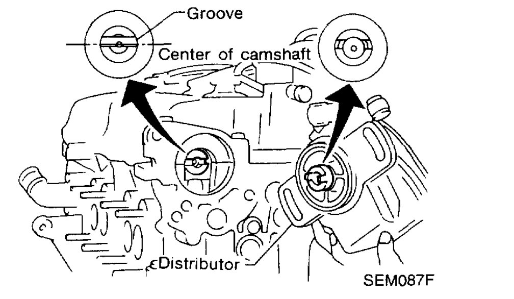

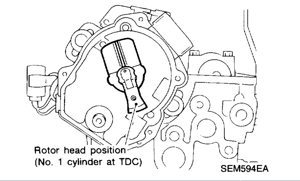

Good morning,
I attached pictures of setting the distributor in the correct way with the rotor.
make sure you have the engine at top dead center compression stroke. remove number 1 spark plug and hand crank the motor until you feel pressure coming out of the spark plug hole.
then match the pointer on the crank to 0 mark. then set the distributor as shown in the picture. the wires are also shown for the correct position.
The ignition timing is 0 degrees with a timing light.
The firing order is 1-3-4-2

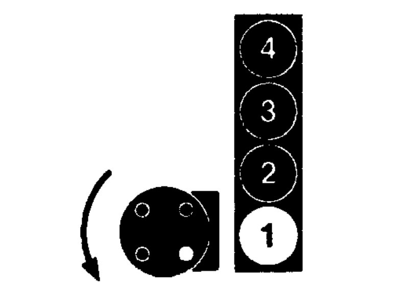

WRENCHTECH
  • 20,761 POSTS
Rotor turns counter clockwise. Check out the diagrams (Below). Please let us know if you need anything else to get the problem fixed. Firing order 1-3-4-2.

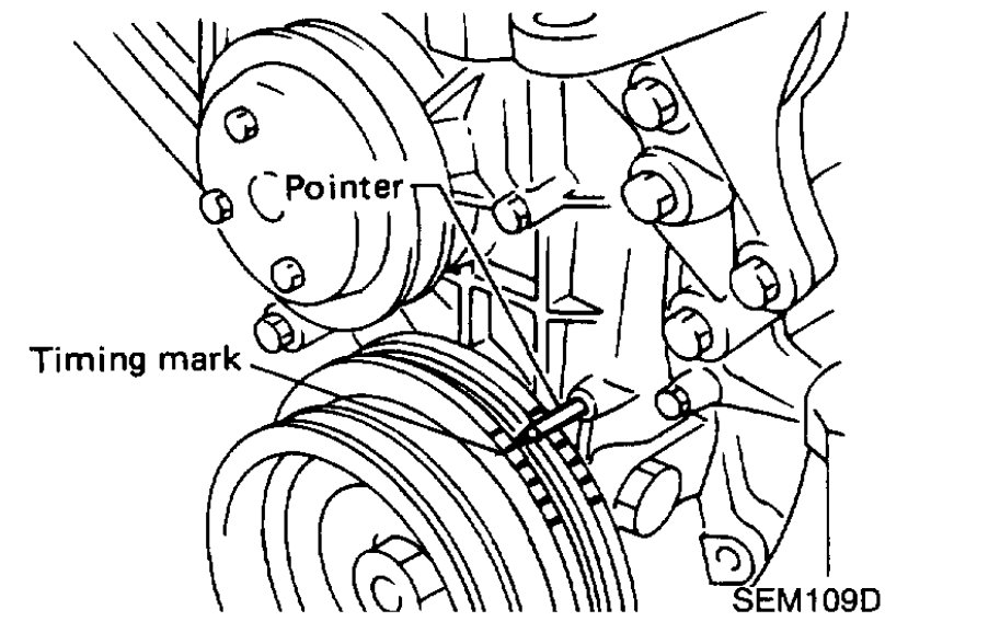

timing spec 10 degrees btdc 550-650 manual 575-675 auto. pics included. Check out the diagrams (Below). Please let us know if you need anything else to get the problem fixed.
