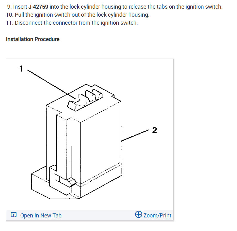

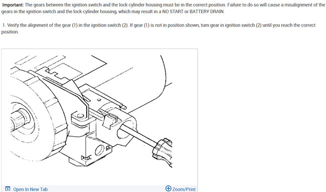

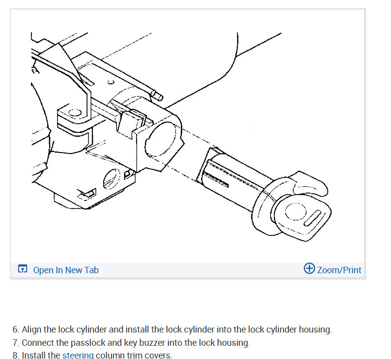

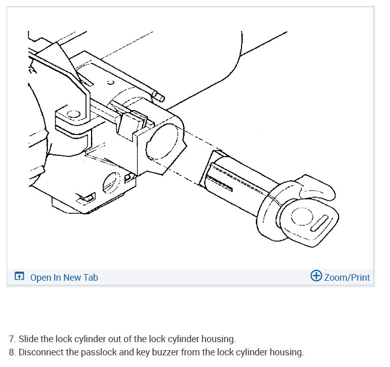

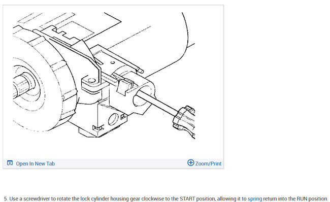

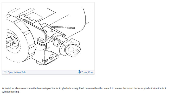

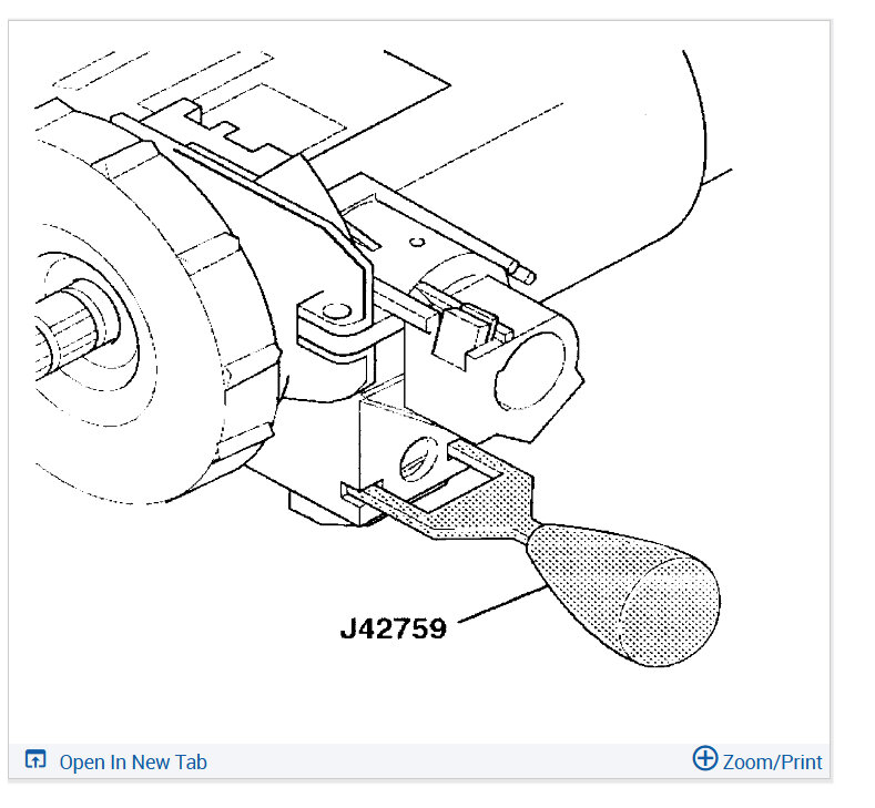

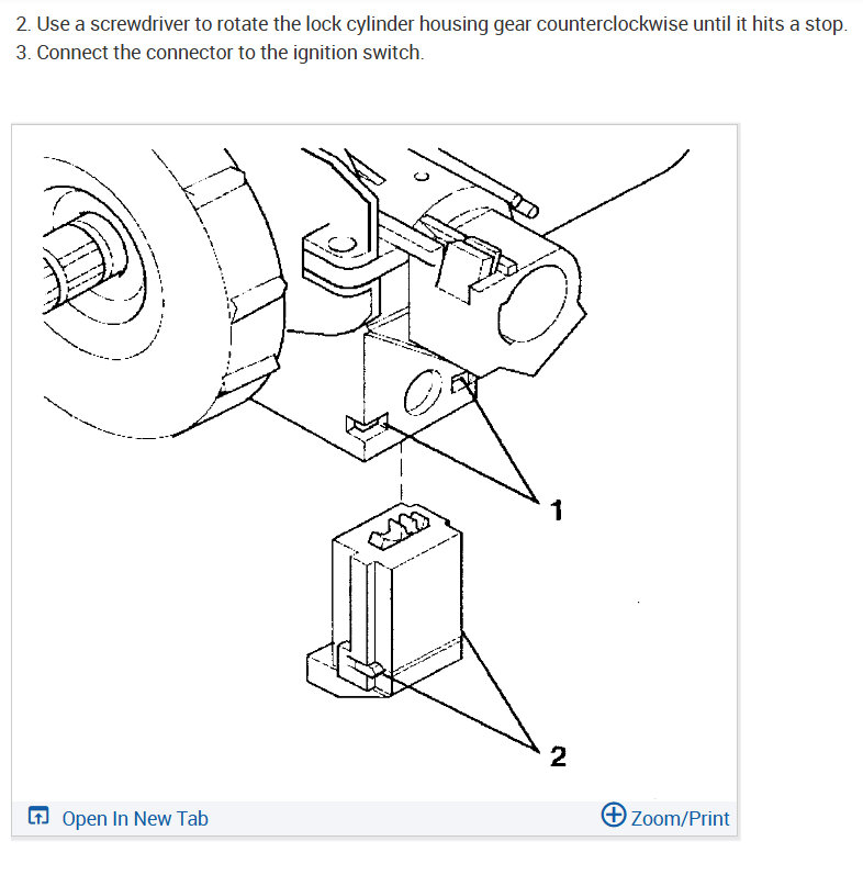

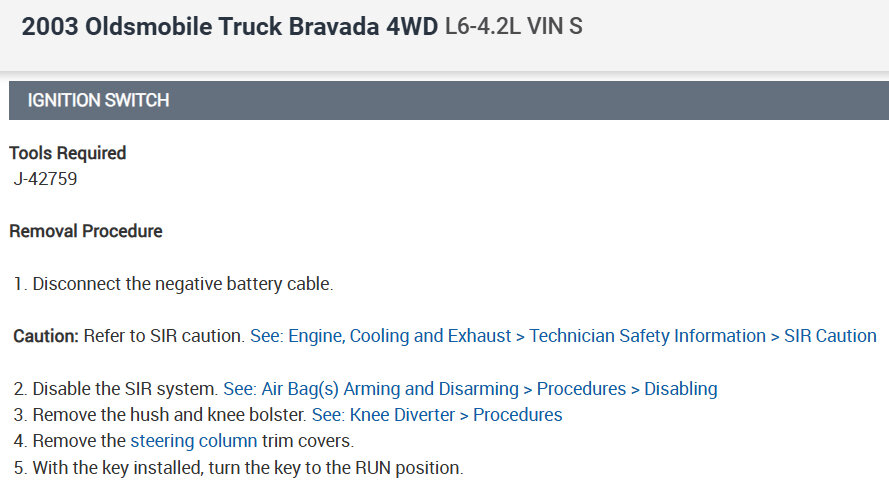

The fuses are probably good but do they have power going to them? This guide can help us see, and if not, it sounds like the ignition switch has gone bad.
I would test the orange wire from the ignition switch for power with the key on. If no power is present the switch is bad. Check out the images (below). Please let us know what happens.
