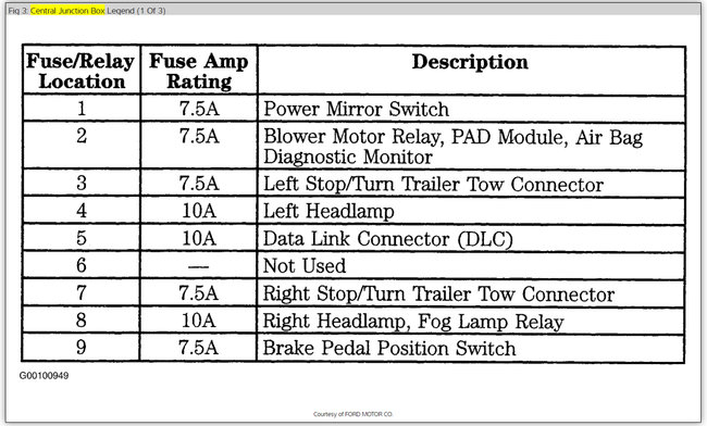

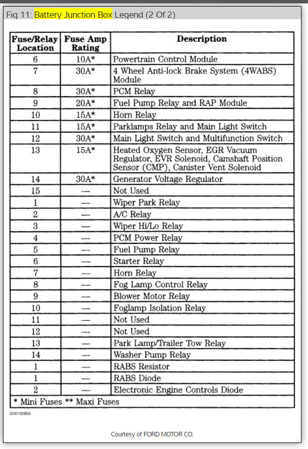

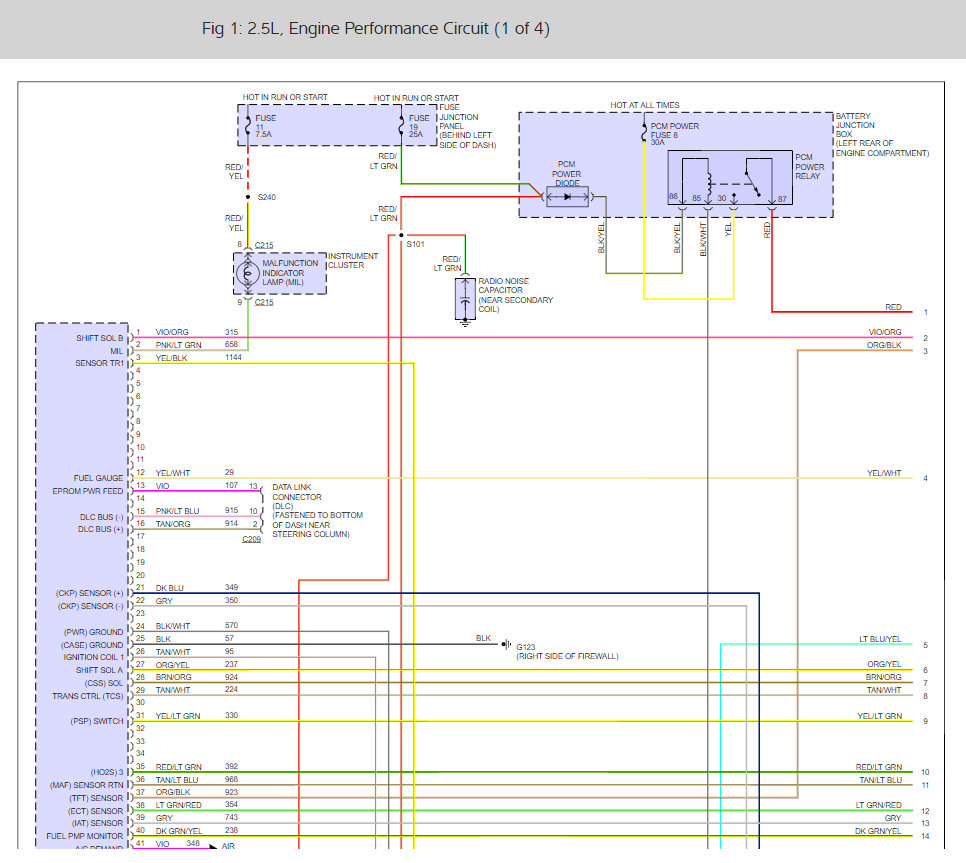

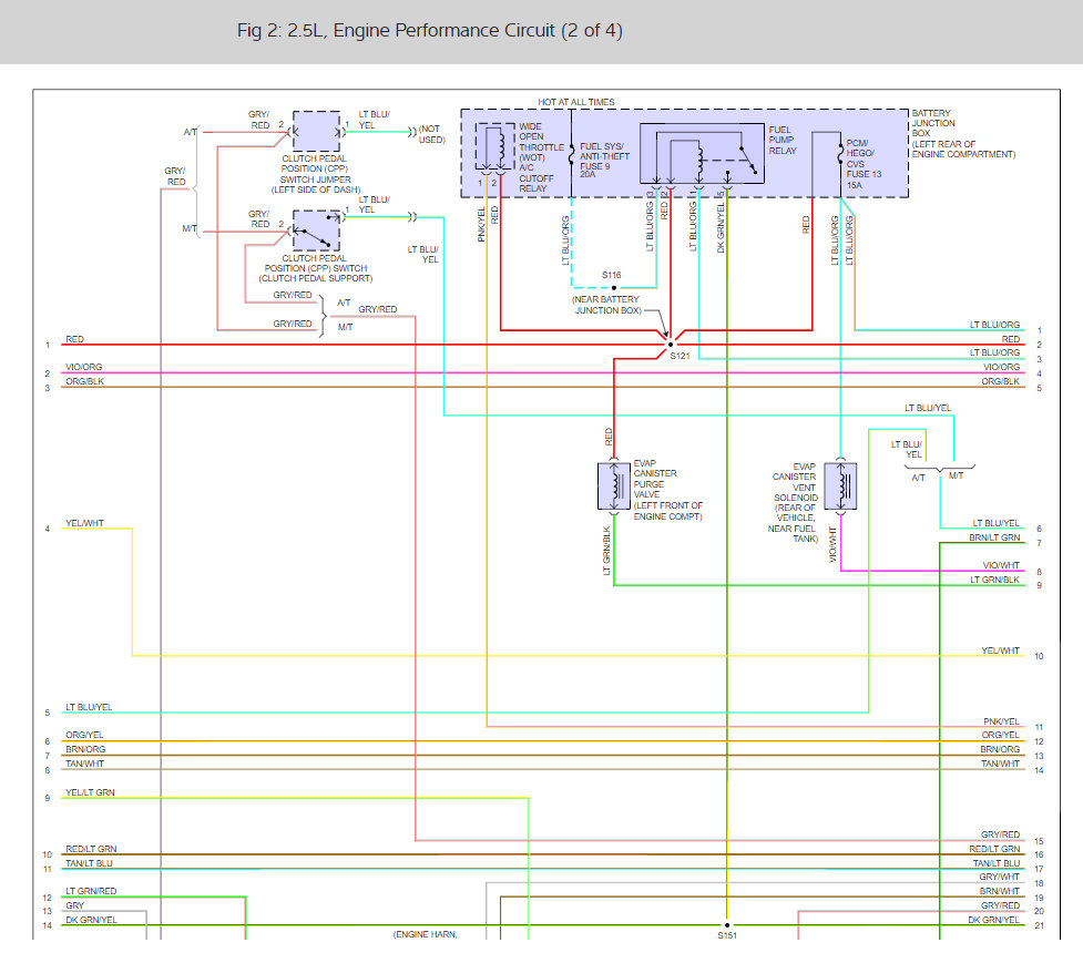

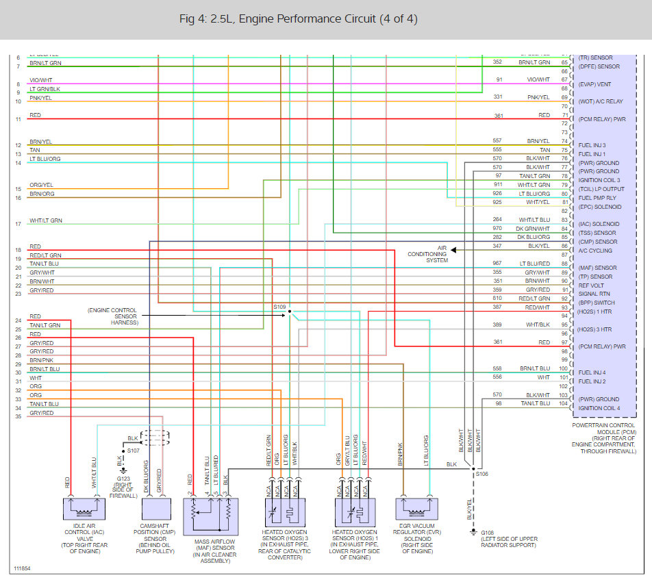

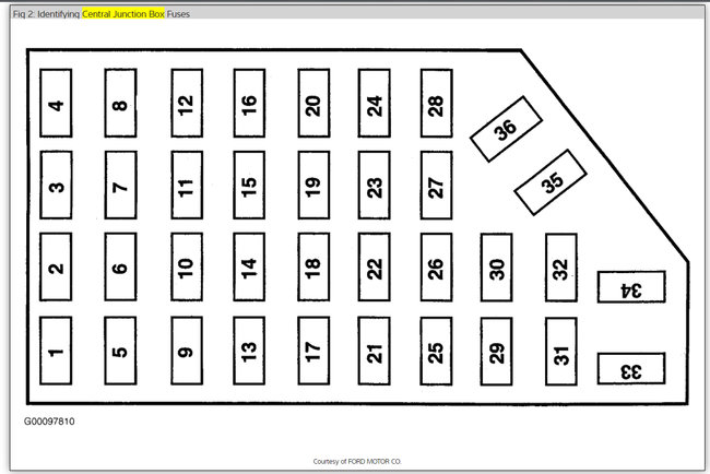

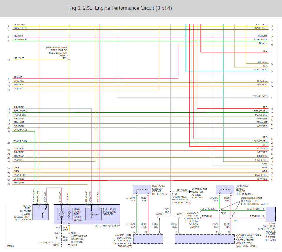

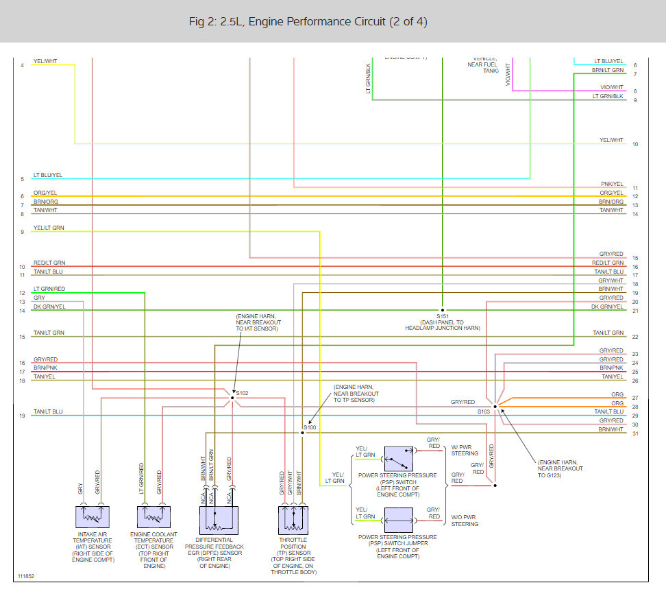

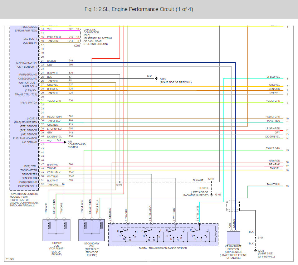

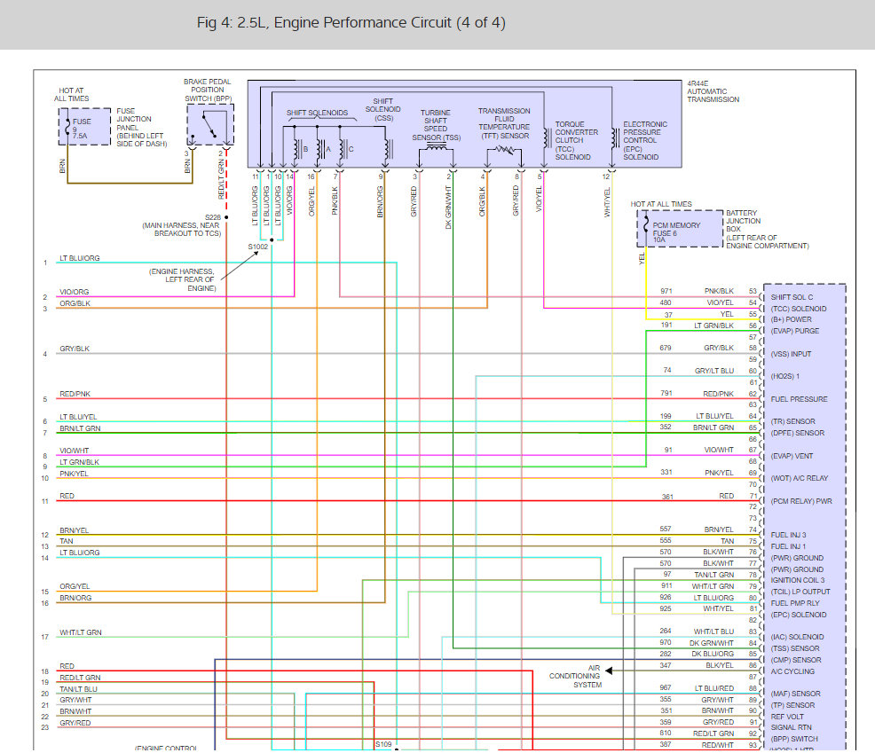

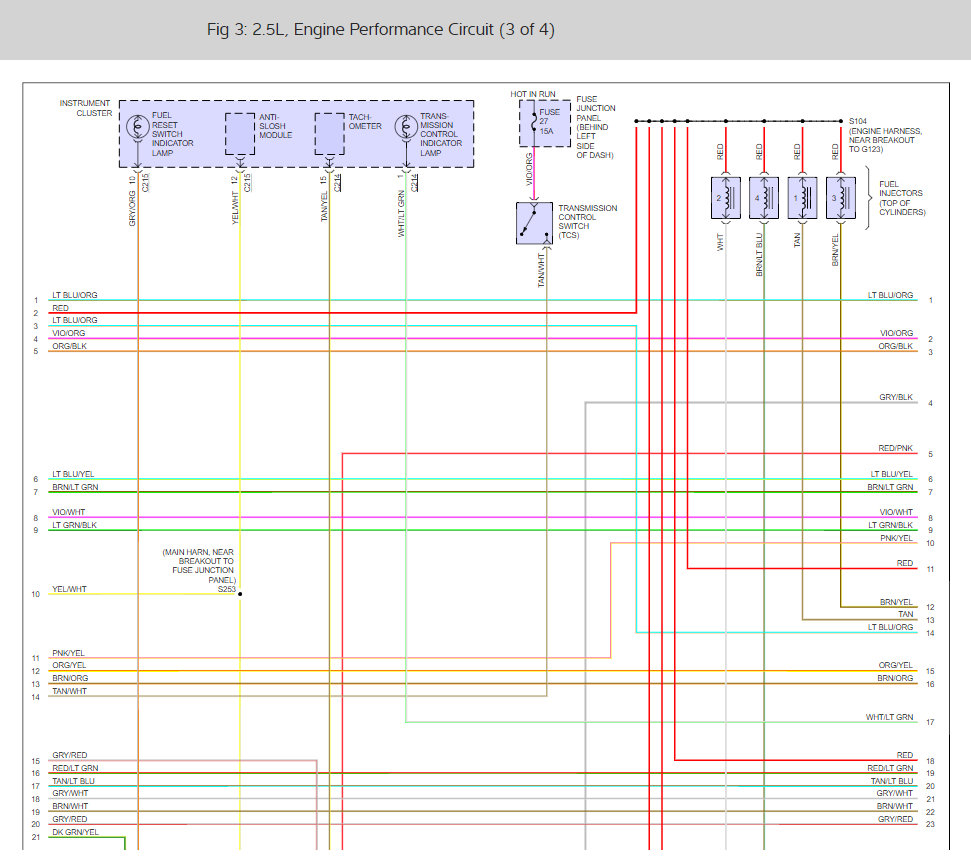

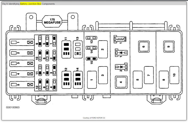

It sounds like it could be a PCM relay or ECM that is going out. Here are some wiring diagrams and guides so you can test to make sure the computer is getting power.
and
Please let us know what happens so it will help others.
