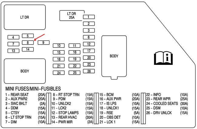

These system get their power from the BCM which has fuse: RT STOP/TRN which is located in the fuse panel at the left side of the fuse panel. Here is a guide to help and the location of the fuse in the images below.
Check out the images (below). Let us know how it goes.

I said that I had already checked the fuses and replaced them still having same problem?

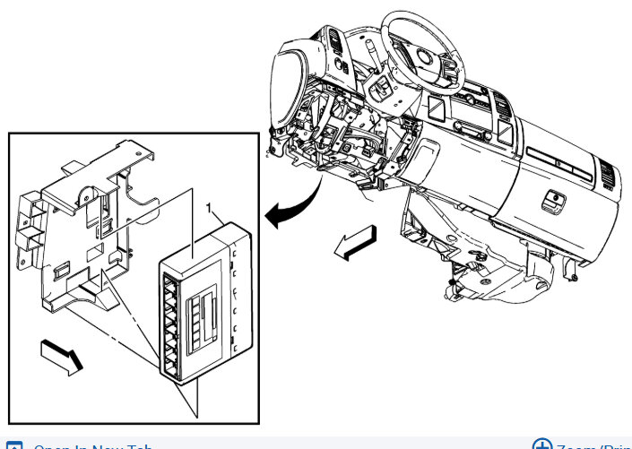

Here is the location of the BCM which you can get a preprogrammed unit by searching Google or Ebay. Check out the images (below). Let us know what you find.
