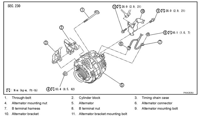

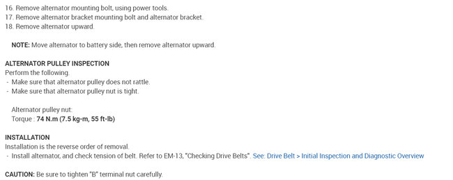

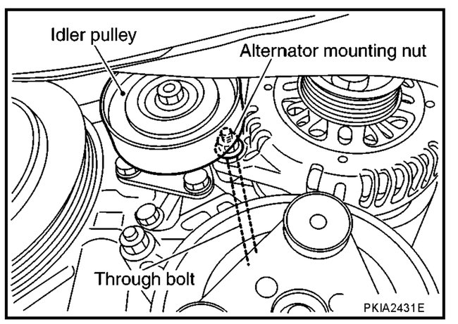

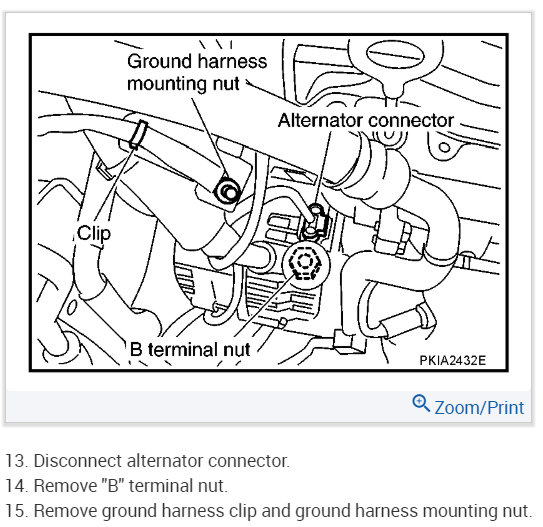

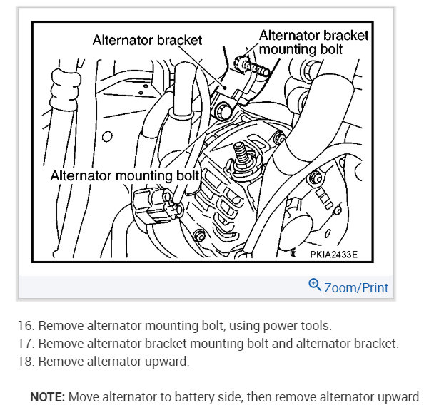

Yep, I would use a Denso rebuild. Here is a guide to help you with the step by steps and diagrams below that show you how on your car:
https://www.2carpros.com/articles/how-to-replace-an-alternator
Aug 20, 2018 at 8:53 AM
