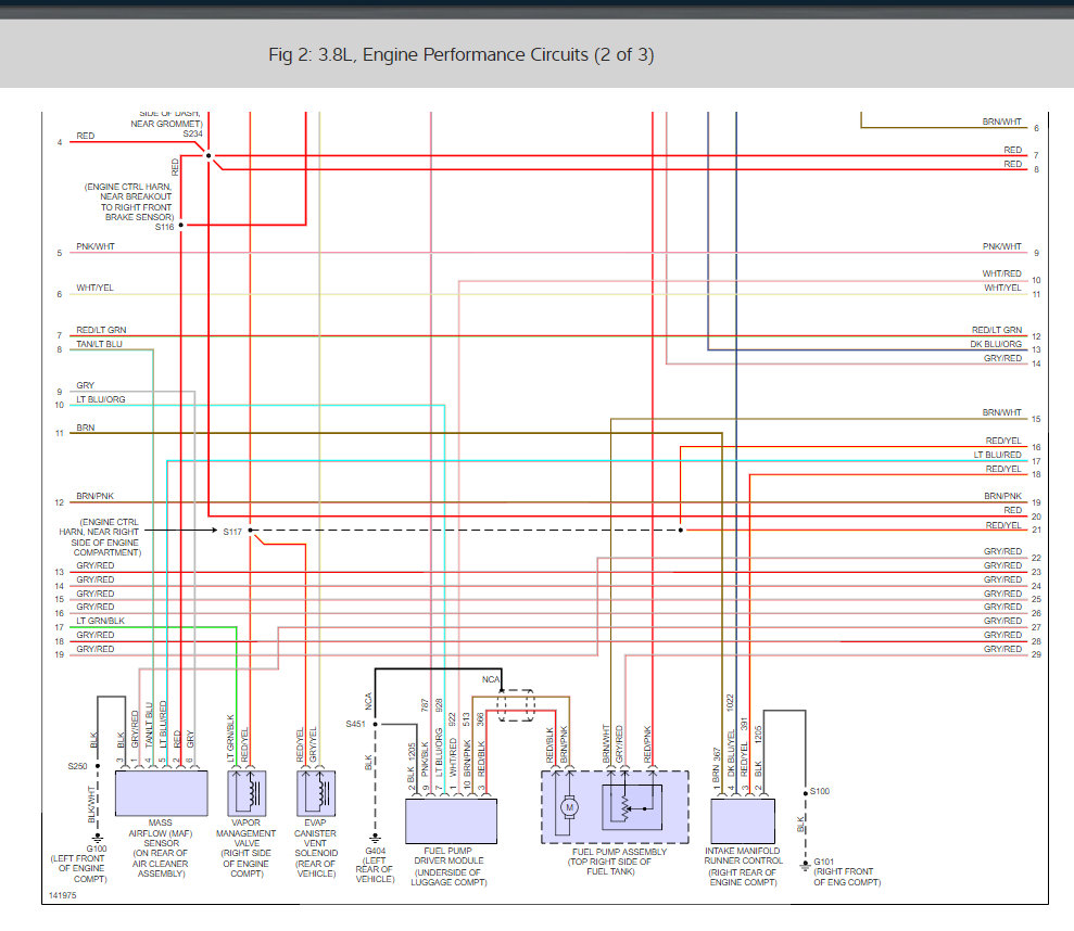

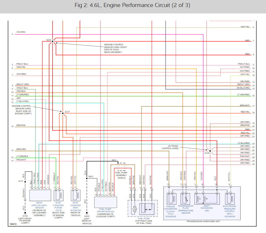

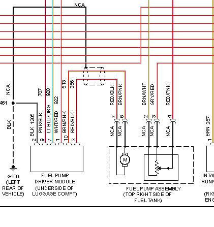

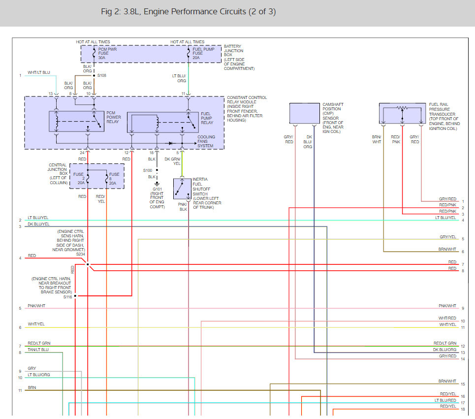

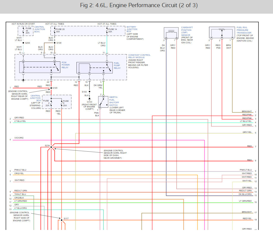

i have power to inertia switch if fpdm is unplugged,when plugged in power is lost. What are the lt/bl & wt/rd wires from fpdm. pump runs when jumped so no it's not bad. tryed new fpdm, same problem. I have 6.04 volts on light blue/ orange wire. have nothing on white/red wire
May 29, 2013 at 11:32 AM
HMAC300
  • 48,601 POSTS

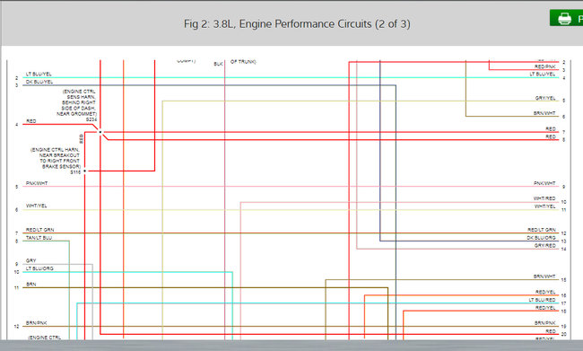

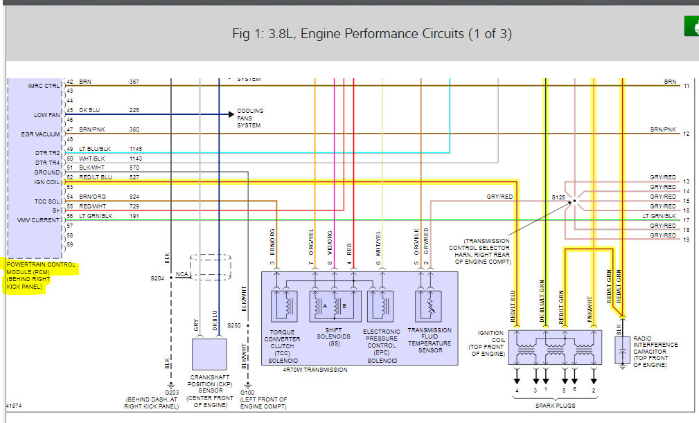

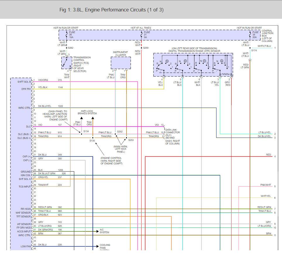

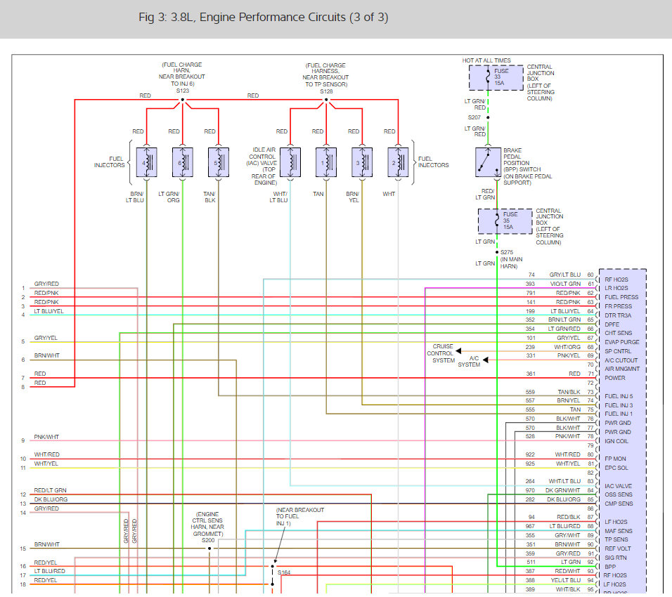

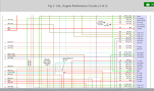

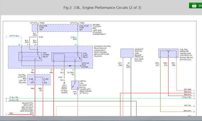

lt blue and white/red go to pcm it may be a bad module why you loose power to inertia switch. i'm sending a pic along.try cleaning the ground for the module at left rear of car. the white red wire may not have anything only at certain times or the module Is bad. Scan it and see if anything pops up. Here are the fuel pump and engine wiring diagrams with a guide to help you test
Check out the diagrams (Below). Please let us know what happens.
May 29, 2013 at 12:43 PM
HMAC300
  • 48,601 POSTS

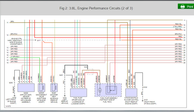

the inertia switch is supplied by the fuel pump relay it should be a dk/grn/yell wire going to switch with a pinkblk going out. that goes to a module that then powers the pump. (pic shown of module/pump.) it cold be a bad module. or an inertia switch that causes your power loss whe nteh fp what ever the hell connection you are talking about is plugged in. the ltblue and red both go to the pcm. one may be power and the othe maybe return to show module is activated in pcm.

fpdm is fuel pump drive module. already replaced ,no change. how much voltage should be coming from pcm to module? on the light blue/orange wire i have 6.04 volts.

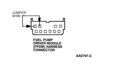

Connect a jumper wire between the FPDM PWR (VPWR for Continental) pin and FP PWR pin at the FPDM harness connector.
Key on.
Measure voltage between the FP PWR circuit at the fuel pump harness connector and the battery negative post.
Is voltage greater than 10.5 volts, AND within 0.5 volt of the reading in KB72?
Yes No
KEY OFF. REMOVE jumper. VERIFY previous test steps. CHECK related connectors for corrosion, etc. If all checks are OK, REPLACE FPDM. KEY OFF. REMOVE jumper. CHECK for causes of high resistance in FP PWR circuit.

try those first two steps I forgot the pic on where to put jumper it's on this reply.

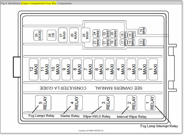

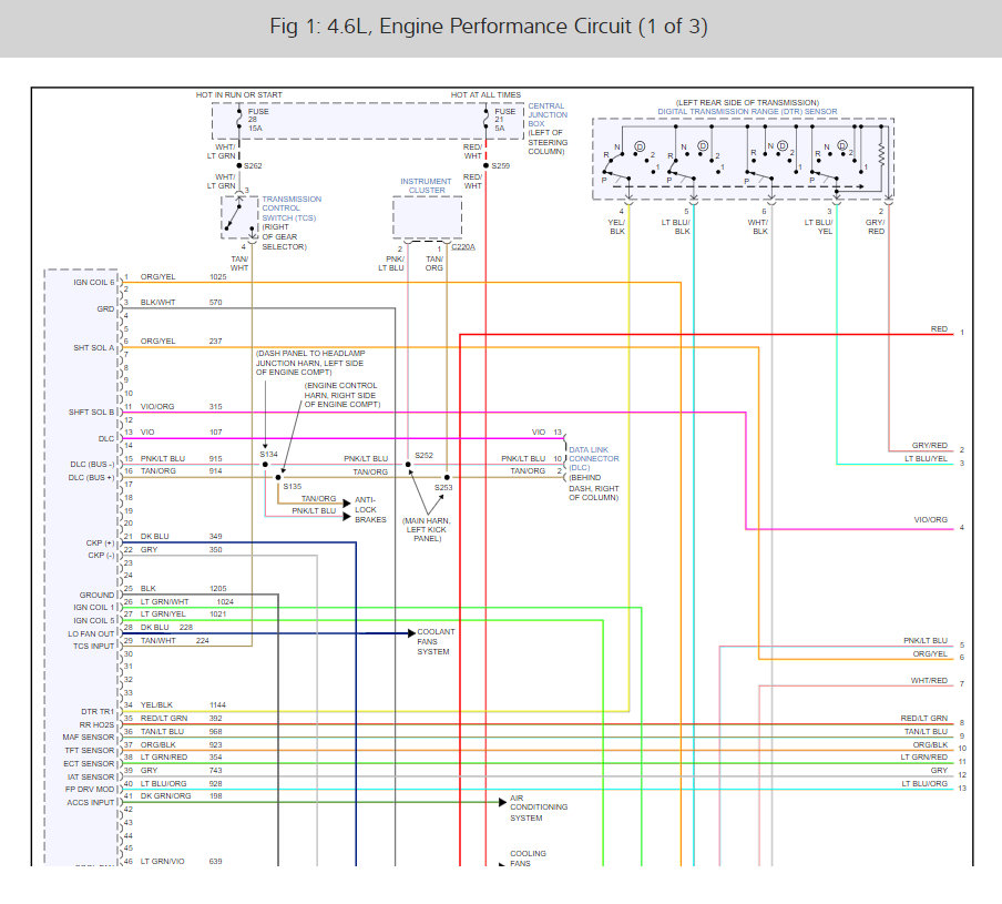

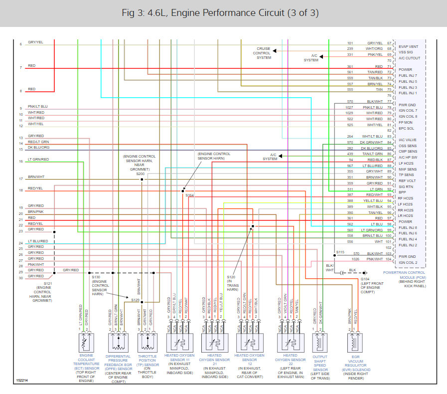

My sisters 99 Mustang is having a problem with starting from time to time. It can go a full day without doing this , or part of a day then it won't start. It turns over but will not start. We are thinking the fuel pump because we don't hear it run, but we was also told to try the fuel pump relay first. Could someone tell me where I can find the fuel pump relay before I change the pump. Thank you .
Feb 5, 2021 at 8:25 AM (Merged)
Yes it does sound like a relay or fuel pump problem. Here are some guides and diagram (below) that will help you see which is the problem.
and
The fuel pump has a module that why I have the test light guide
Has a video on how to replace the pump
Please let us know what you find.

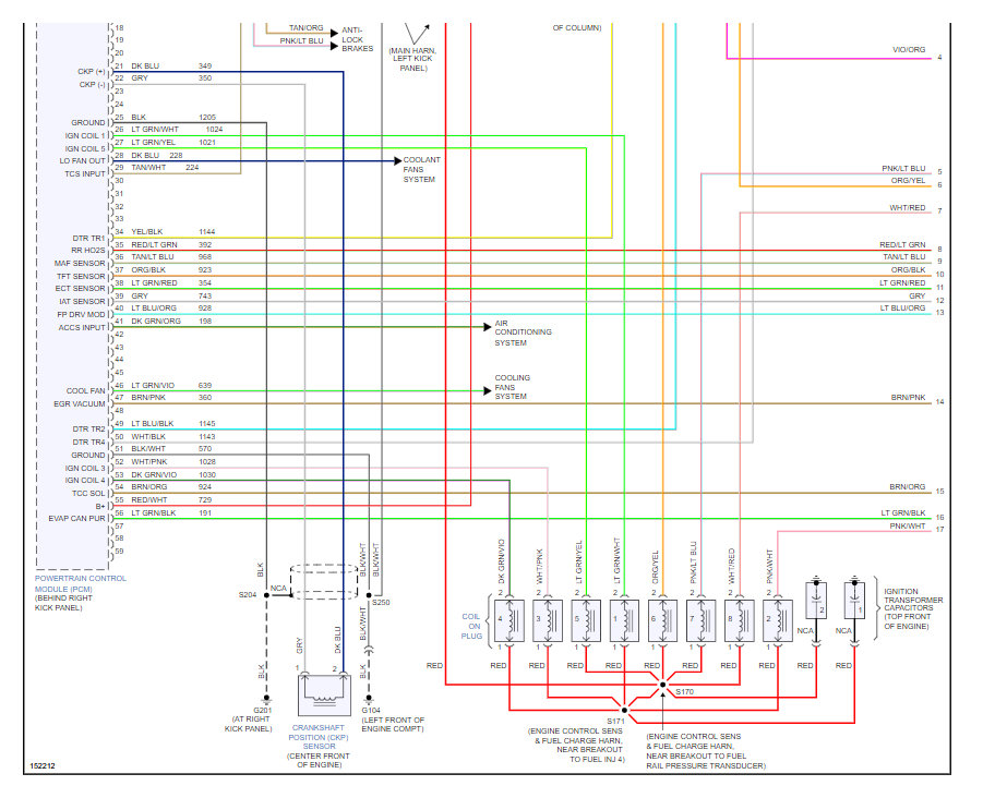

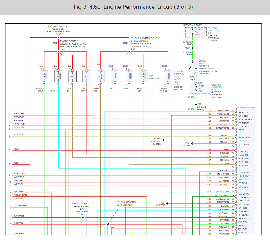

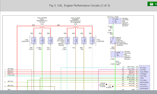

My PCM control module burnt out so i have to change it over I need the engine wiring please?
Apr 14, 2021 at 11:01 AM (Merged)
SCGRANTURISMO
  • 4,897 POSTS

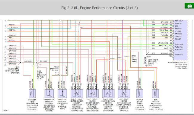

I have included a description of how this works from Ford in the diagrams down below. I have also included the wiring diagrams for the Engine Performance of your vehicle as well in the diagrams down below also. This guide can help you test the wiring with the engine wirindaigarms below.
