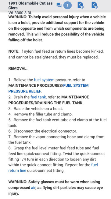

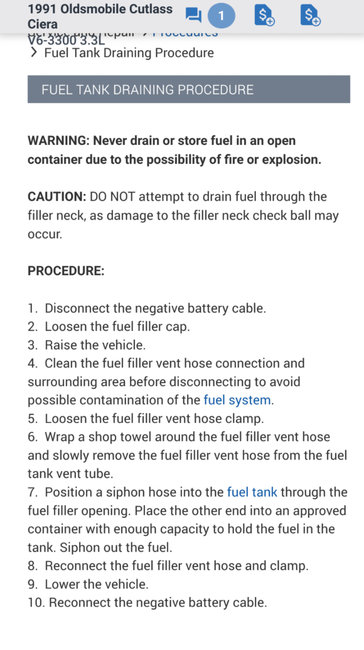

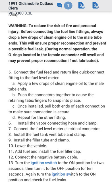

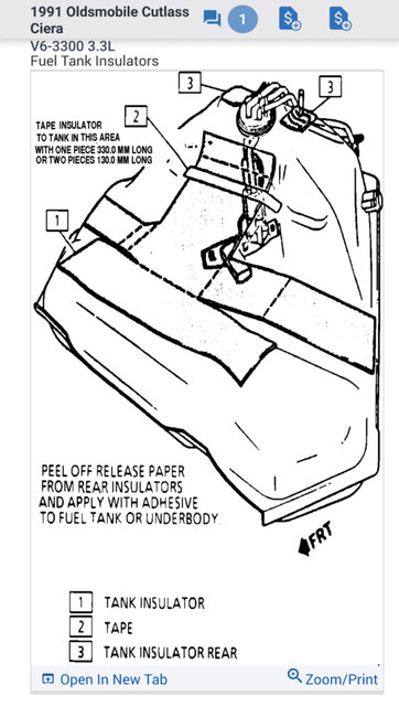

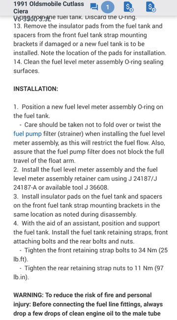

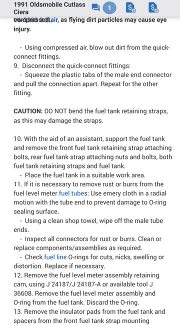

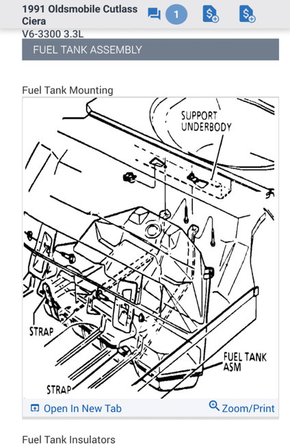

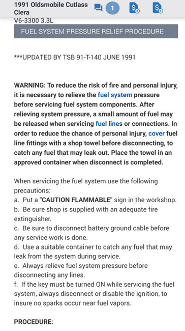

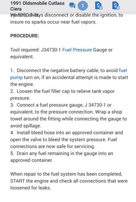

And I'm including AllDatas information on how to remove and reinstall the fuel tank (so you can change the pump) in the attached images.
