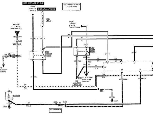

RELICREPAIR
Which connector is the spout. I know which wire is spout at the ignition module. I could use a wiring diagram if you can get one. Will an led test light work to check spout?
Sep 15, 2017 at 2:40 PM
RELICREPAIR
So really this ignition system can run on its own. Only needs computer for advance. Confusing how computer seems to be stopping the spark.
Sep 15, 2017 at 3:08 PM
It does sounds like you have a wire that is grounded here is a guide and some wiring diagrams so you can do some testing.
Please let us know what happens and upload pictures or videos of the problem.
Sep 17, 2017 at 12:14 PM
RELICREPAIR
Did some checking while waiting for a diagram. Found a burnt fusable link by starter relay. Touched it back together with key on and it gets hot. Did tracing and came down to the ecc relay if unplugged while turning key on the fuseable link doesn't get hot. Thats as far as I got and need time to get back at it and look at the diagram you sent me. Thank you
Sep 18, 2017 at 8:42 AM
No problem, please let us know what happens :)
