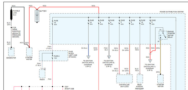

That can be, but how did he test it? I have seen the ignition switch go bad and cause this as well. I would use a test light and check these fuses for power, this guide can help with the image below to help you see which fuses to test.
Check out the images (below). Let us know how it goes
