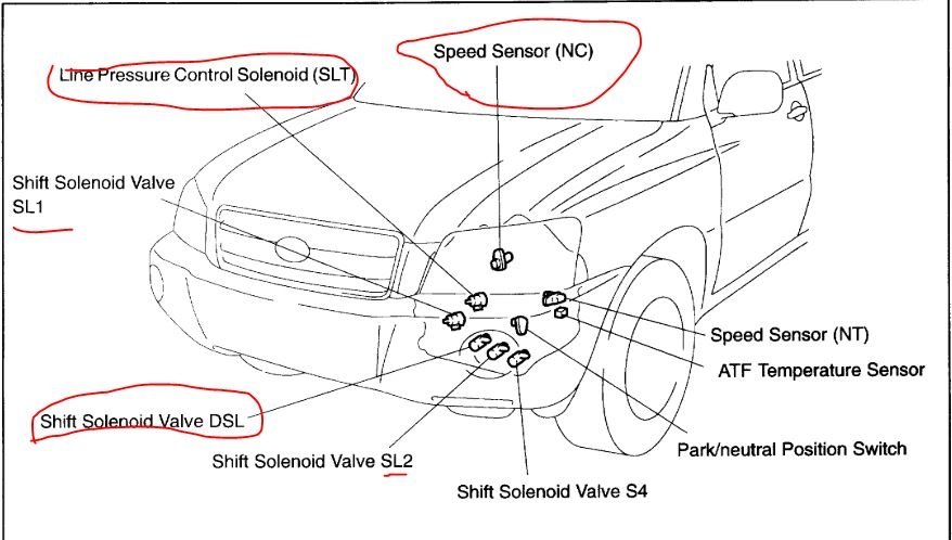

There are a number of solenoids that be causing an issue, but if the fluid is clean and full I would recommend checking line pressure.

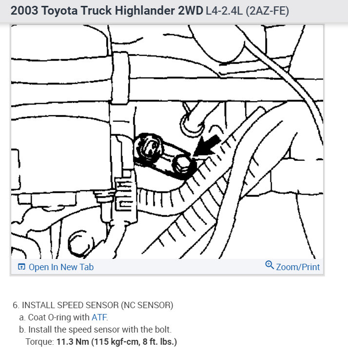

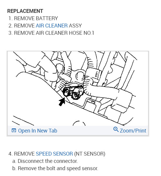

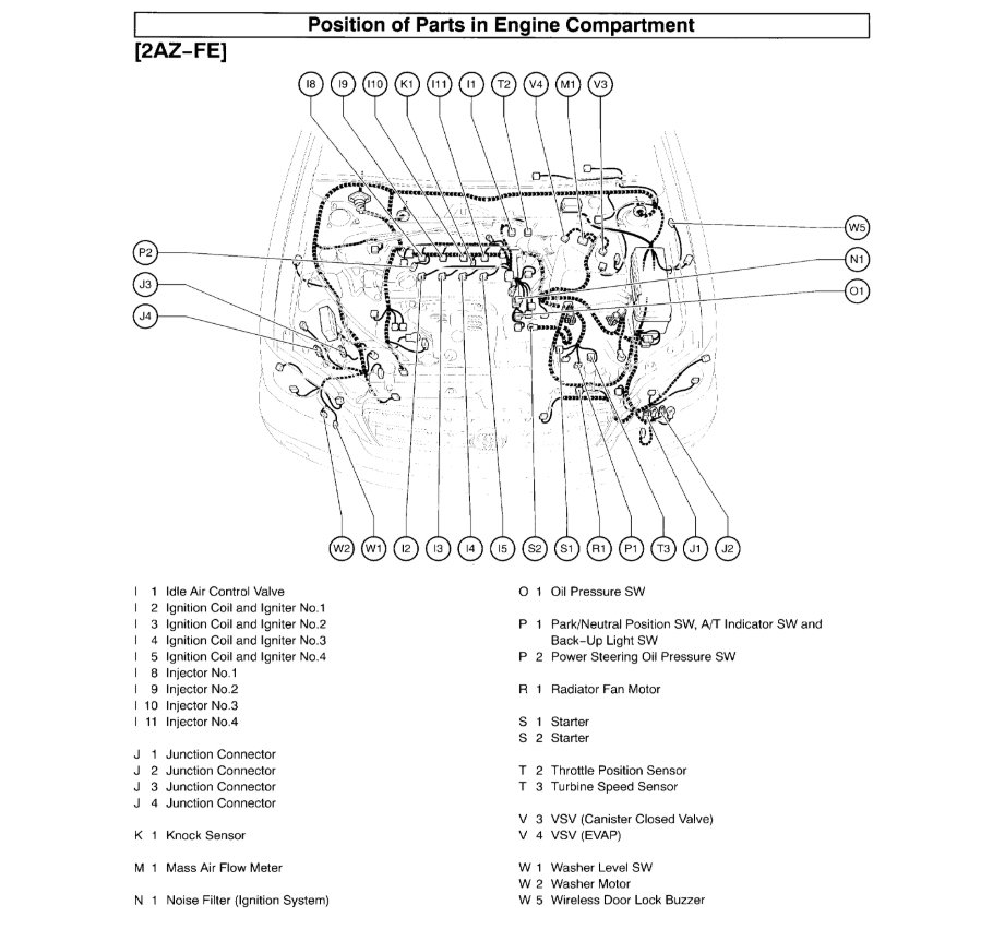

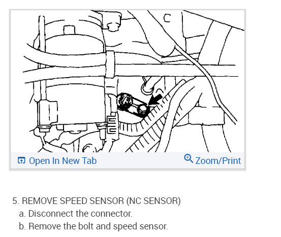

Even thought here are no codes I have seen the input (turbine) shaft speed sensor cause this issue . Here is the location so you can check it out and replace it.
