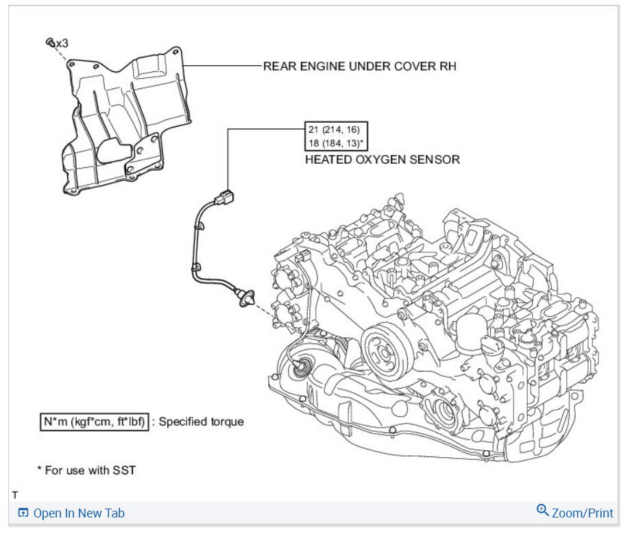

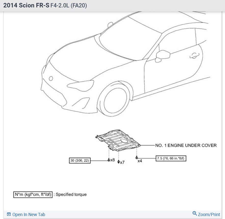

These are all for the downstream oxygen sensor, here is a guide to help you change it out, also check for exhaust leaks which can cause this issue as well. Please check out these guides:
https://www.2carpros.com/articles/repair-lean-mixture-codes-p0171-or-p0174-on-some-manufacturers
and
https://www.2carpros.com/articles/how-to-replace-an-oxygen-sensor
Here is more information on the problem:
The codes you provided, P2096, P0137, and P013A, are related to the oxygen sensor in a vehicle. Here's a brief explanation of each code:
P2096: This code indicates a post catalyst fuel trim system too lean in bank 1.
P0137: This code points to a low voltage condition for the downstream oxygen sensor (sensor 2) in bank 1.
P013A: This code indicates a slow response from the oxygen sensor in bank 1, sensor 2.
Check out the images (below). Let us know what happens and please upload pictures or videos of the problem so we can see what's going on.
