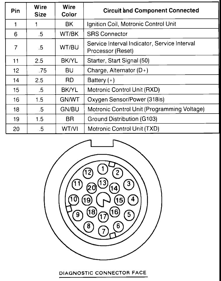

Could you please send me the correct pins in the diagnostic plug to retrieve the codes via the check engine light?

For others researching this topic, this article may help:
https://www.2carpros.com/articles/bmw-obd1-1995-and-earlier-code-definitions-and-retrieval-procedure
Image (Click to enlarge)
