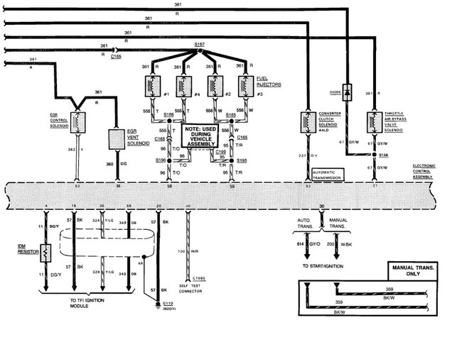

It sounds like you are losing power somewhere. Here is a guide to help you run the codes:
https://www.2carpros.com/articles/ford-lincoln-mercury-obd1-1995-and-earlier-diagnostic-trouble-code-definition-and-retrieval

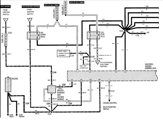

Check the ECC relay.

I made sure that the timing belt was put on correctly. I started following chasing the electricity coming out of the computer has nine to any of the sensors, it has nothing to the injectors or has none anywhere. so I am picking up a new one they should be here in a couple of days. The only thing I can think of because there is nothing else it could have been. I have replaced some parts which are a believer unnecessary, but I do have compression. I have change the wires have checked all the grounds the only thing. it could be is that.
PCM

Did you ever check the ECC relay also can you check to see if the computer is getting power and has its grounds? Use the wiring diagrams above.

I checked the ECC it is powered up all the way through followed all the instructions it is good found out that my number two on. My fuel pump relay is not reading correctly I have .76 on voltage. I am going to borrow Antonio to find where the wire goes try and find where the break is hopefully I will be able to I will let you know something. I do appreciate your guidance!

I checked out the easy sheet it is all good. I went to their fuel relay and it has a box of wanted to drop or number three pan and a half hours a week, lied on number one Penn. I am getting closer to watch wrong it was not doing this before but so off I go chasing. Do you have any ideas on where to go and see where the power drop? We also checked my key and I get a 10% let’s see it is 1230 both ditch with the key off and it drops off. 40 after I turn the key on.

Did you install the new PCM? It sounds like you, did but I want to make sure. If so you will need to check all power and grounds to the unit.
