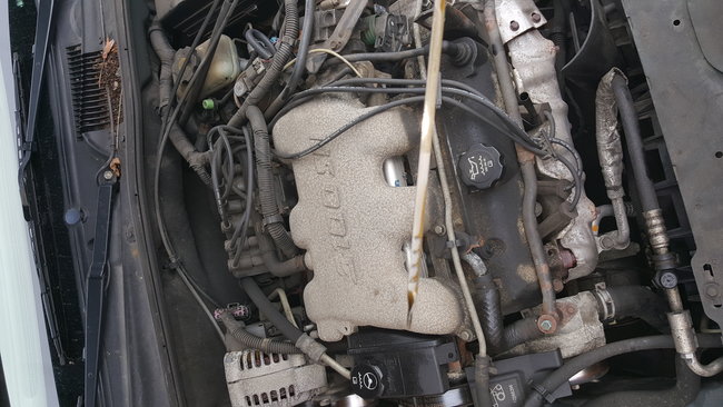

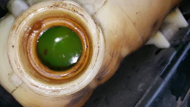

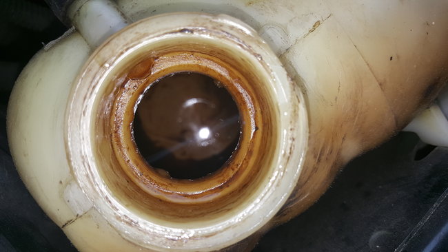

This is what it looks like the darker view is before I added the coolant and the dip stick looks fine.
Apr 29, 2017 at 6:31 AM
STEVE W.
  • 15,116 POSTS
Not good. Are you adding coolant and not seeing any leakage on the outside of the engine or elsewhere? That is not good either. I would do a couple things, Pressure test the cooling system. That will at least tell you if you have a coolant leak. Then have the cooling system flushed, that vehicle should run Dexcool, it is not green and adding conventional green can cause a nasty sludge that looks like oil. If you are in an area that is not going to freeze soon you could do the flush and only put in clear water. Then take it for a drive and see if it still shows oil.
