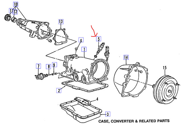

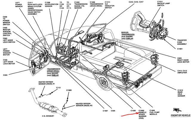

The Vehicle Speed Sensor is located at the LH rear of the transmission. The ABS sensor system will not affect the PCM reading. It should have a gry/blk and pnk/org wires going to it. Check out the images (below). Please let us know if you need anything else to get the problem fixed.
Oct 6, 2023 at 10:42 AM
