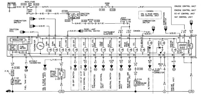

99% of the time my overdrive won't engage at highway speeds yet the light showing it's engaged on the dash works when button pressed in on the shifter...any suggestions or wiring to check? Even a wiring diagram would be great as well. I appreciate any help. thank you!
Aug 12, 2023 at 5:15 AM
I would check the transmission fluid and service the unit if the fluid is dirty/burnt. Here are the wiring diagrams you have requested. Check out the images (below). Please let us know what happens.
Aug 12, 2023 at 3:44 PM
