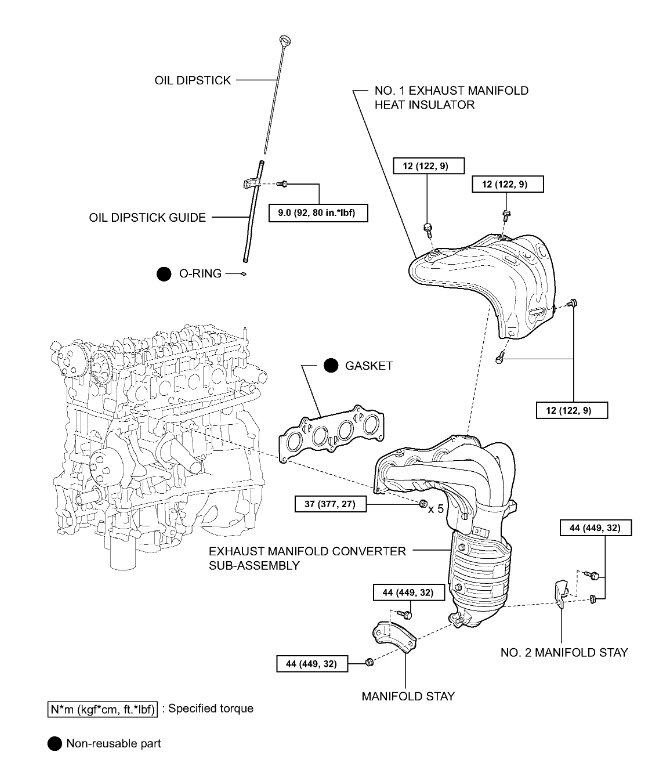

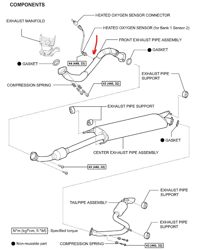

Code P0138 in the context of a 2007 Toyota RAV4 (or many other vehicles) refers to "O2 Oxygen Sensor Circuit High Voltage (Bank 1, Sensor 2).
So, with the voltage high it means there is air getting into the system so I would check for an exhaust system leak,
If no leaks are found the next step is to replace the catalytic converter or I have seen people install a spark plug extender where the oxygen sensor goes to help confirm the bad cat. Check out the images (below). Please let us know how it goes.
