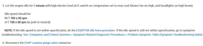

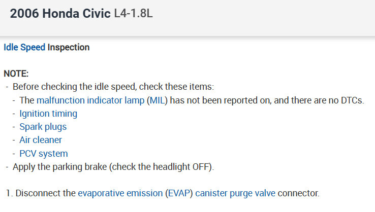

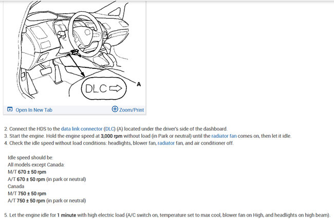

So, I have included the correct way to set the idle speed so we can be on the same page
P0507 - Idle Control System RPM Higher Than Expected:

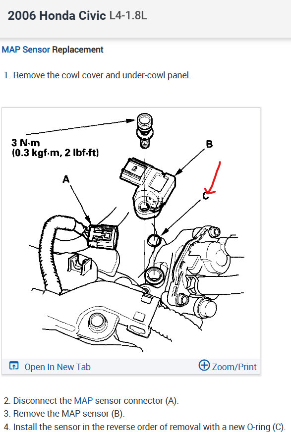

This indicates there is a vacuum leak around the sensor, can you double check the O ring seal that help mounts the sensor?

Thank you Ken L, I had some doubts about that O ring.; I remember now that, when I put it together, i had some difficult putting (inserting) the MAP sensor back in its place - I will let you know by Monday, after I also find another O ring to replace it (should have done it from the start).

Yes, if the vacuum is leaking it can affect the engine idle and cause the P0507 code. Have a good weekend :)
