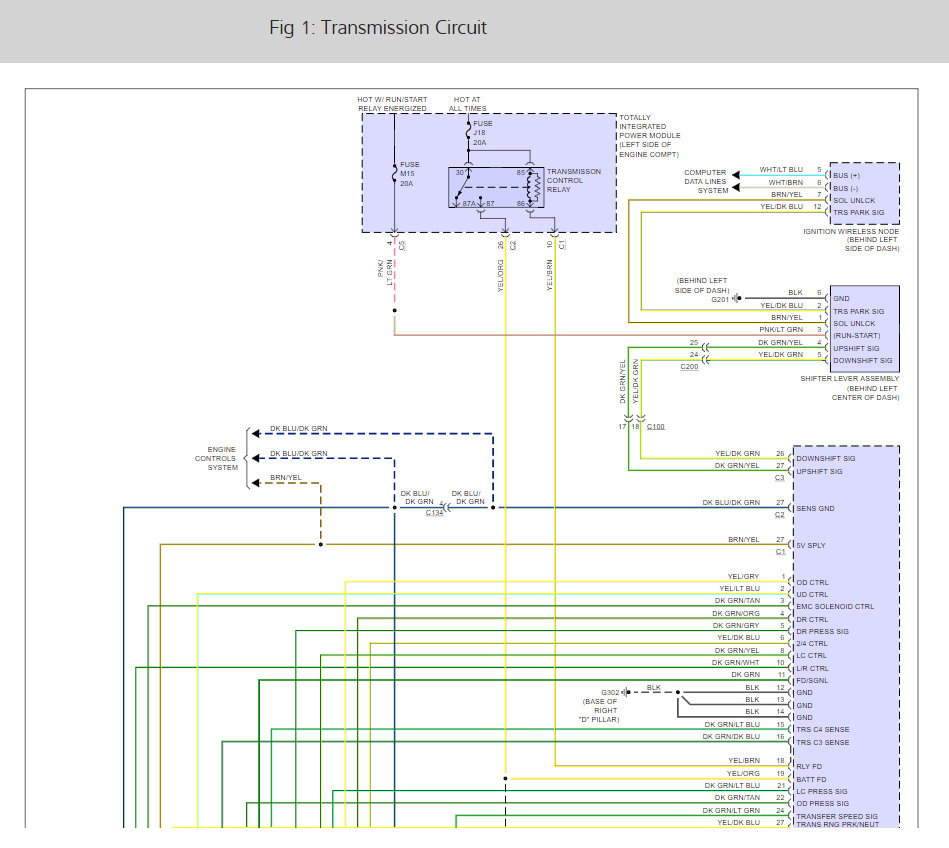

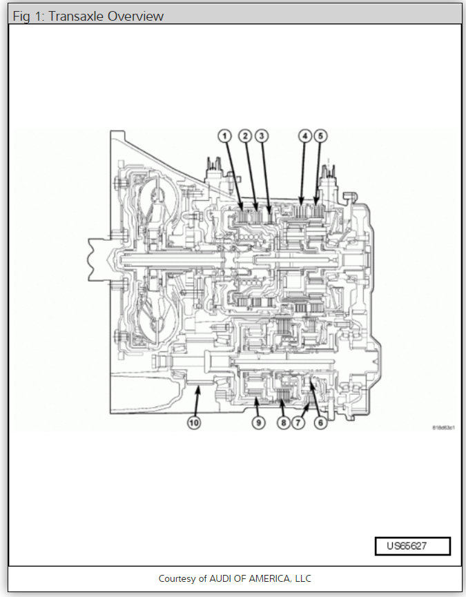

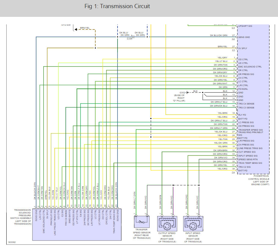

It sounds like you have torque converter control solenoid that needs replacement. Here is a guide to help you see what you are in for when removing the pan:
Check out the diagrams (below).
