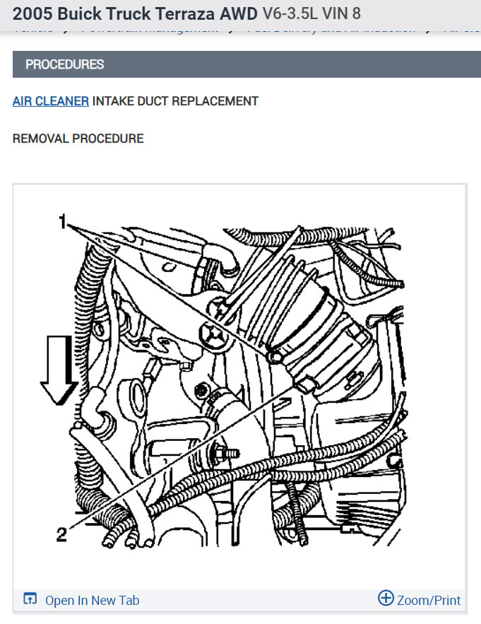

What is the tube that comes from the air flow filter?

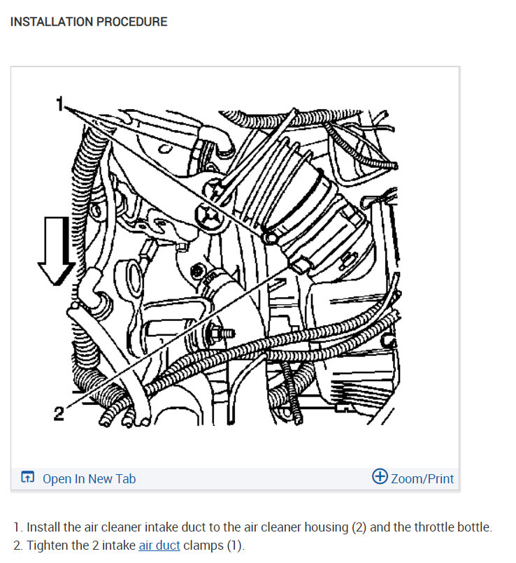

It is called an air intake duct. Here are images which show the part and the name, please confirm this what you are talking about. Check out the images (below). Let us know if you need anything else.
