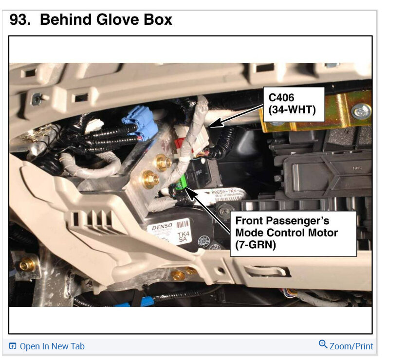

I didn't see the video. It sounds like the front passenger mode control actuator is not working here is the location so you can swap it out. Check out the images (below). Please let us know what happens.

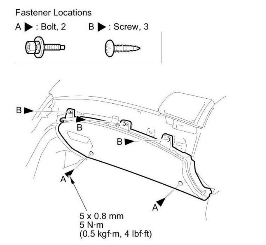

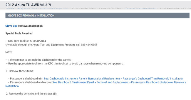

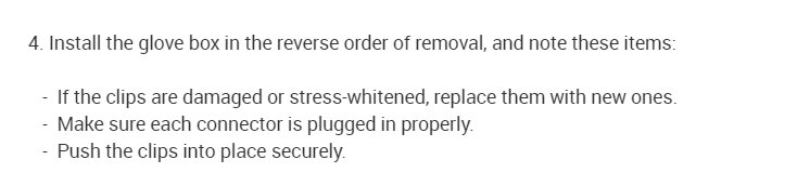

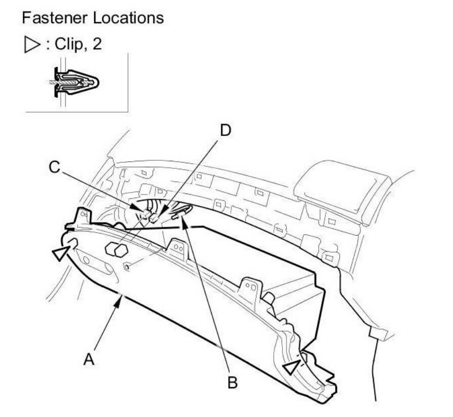

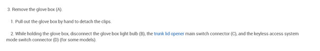

Here is how to remove the glove box so you can access the blend door actuator. Check out the images (below). Please let us know if you need anything else to get the problem fixed.
