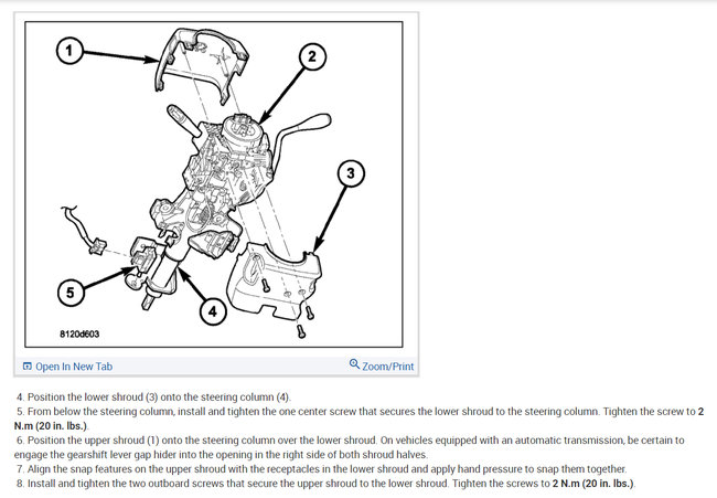

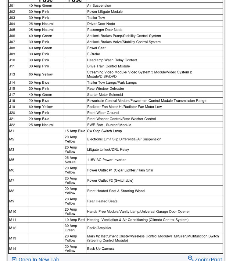

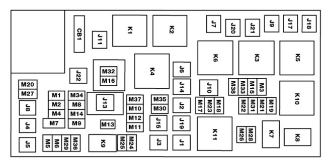

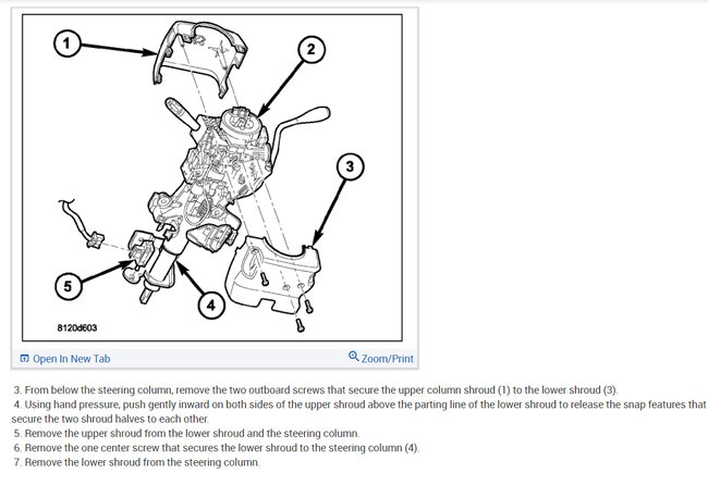

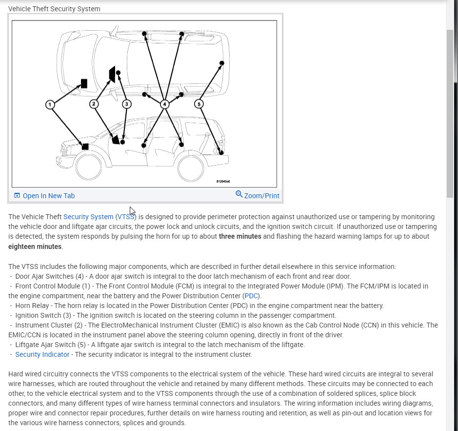

let's scan for codes and then also we need to check all the key-less functions and see what does not work. lets do a CAN scan which is the future of automotive repair you can get a CAN scanner from Amazon for about $50.00 here is a video to show you how.
https://youtu.be/u-4syLc-ifQ

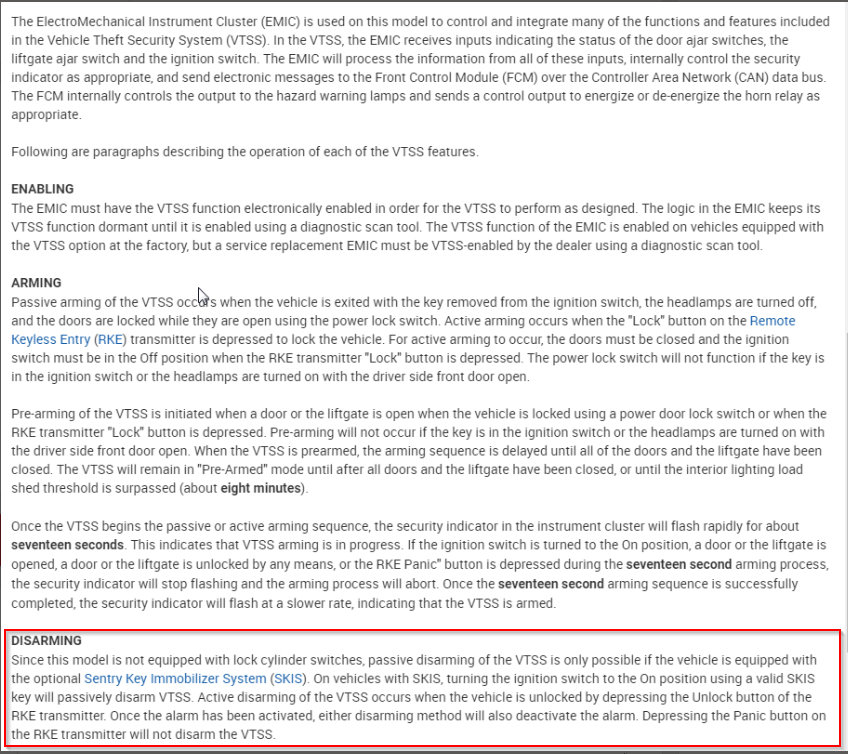

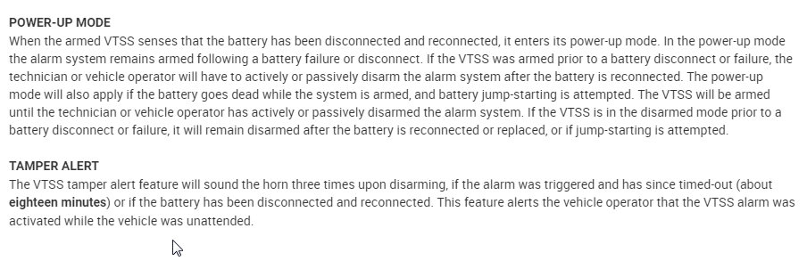

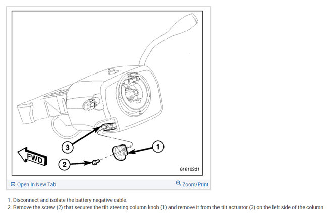

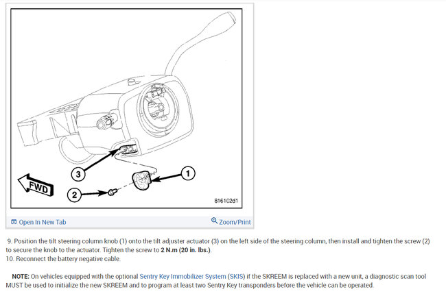

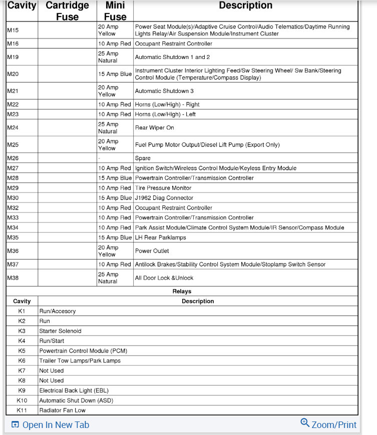

Here is a guide to help you reset the system with the security alarm fuse location in the diagrams below.
https://www.2carpros.com/articles/how-to-reset-a-security-system
Check out the diagrams (Below). Let us know what happens and please upload pictures or videos of the problem.

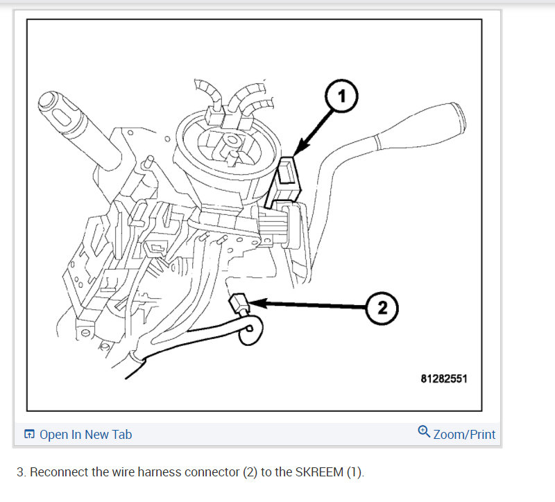

CURTIS LONG
The wire for the key-less antenna was unplugged when I plugged it back in it started acting like it was crank with the fob and would not go into gear. once I unplugged the wire again every thing worked right but the passive entry and the service key-less system message came back on. So I checked outt he guide and that did it, back going again. thank you

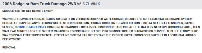

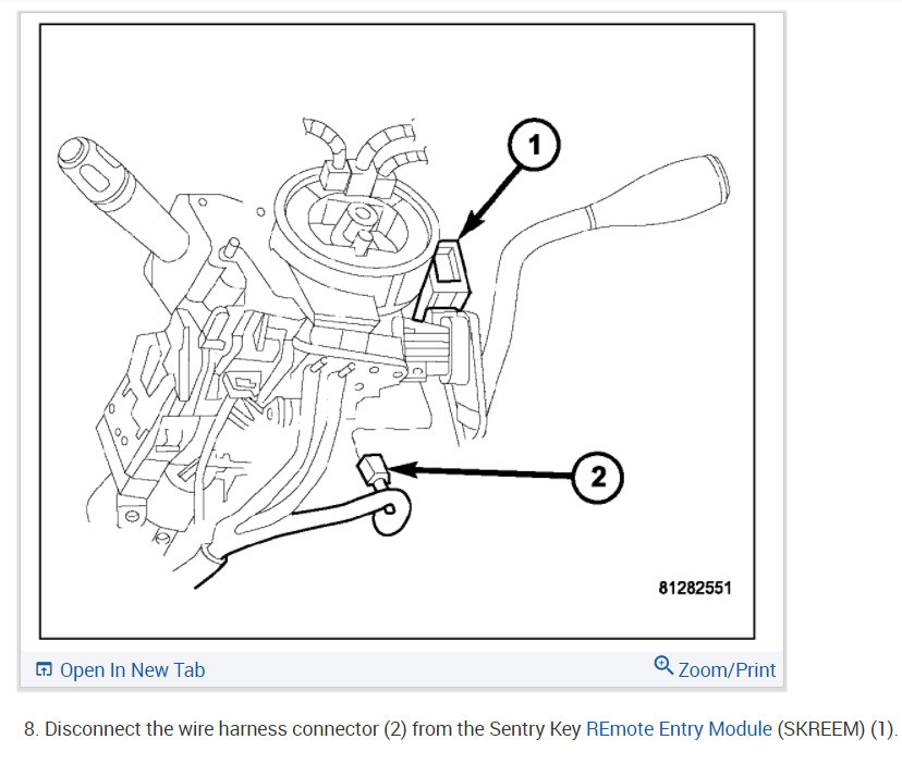

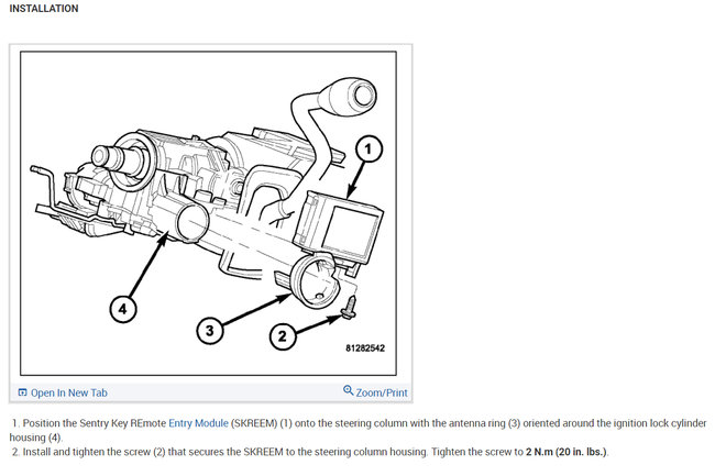

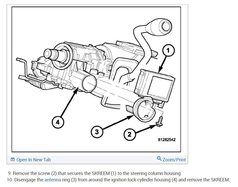

It sounds like the security module needs to be replaced. does the engine start up and run? Here is the location of the module and the replacement instructions below. Check out the diagrams (below). Let us know what happens and please upload pictures or videos of the problem.
Mar 21, 2021 at 10:30 AM (Merged)
RAYNA WARNER
Yes, the vehicle starts and runs.
It sounds like the security module is bad. To be sure let's check out this video which will help confirm the issue:
https://youtu.be/InIlnsjOVFA

Step one will be to get a new SKREEM module and lock cylinder, that is the part with the antenna that circles the switch. Now visit a locksmith or have one come to you, with your title and registration and drivers license. With those they can contact the factory and get the proper key codes to cut the new keys. Then the replacement cylinder can be pinned to match the lost keys. That way you don't need to replace the rest of the locks. Those parts get installed and they can program the replacement SKREEM module and the keys into the system. I would call a few places as well as the dealers and see who has the better deal. Remember that the smiths will usually charge more to come to you but that with the dealer you are looking at tow bills.

You cannot bypass the alarm easily, have you tried a hard reboot of the system? Remove the negative cable from the battery and hold it to the positive battery terminal for one minute. This will discharge the capacitors and let the system reboot. Here is a guide that can help:
