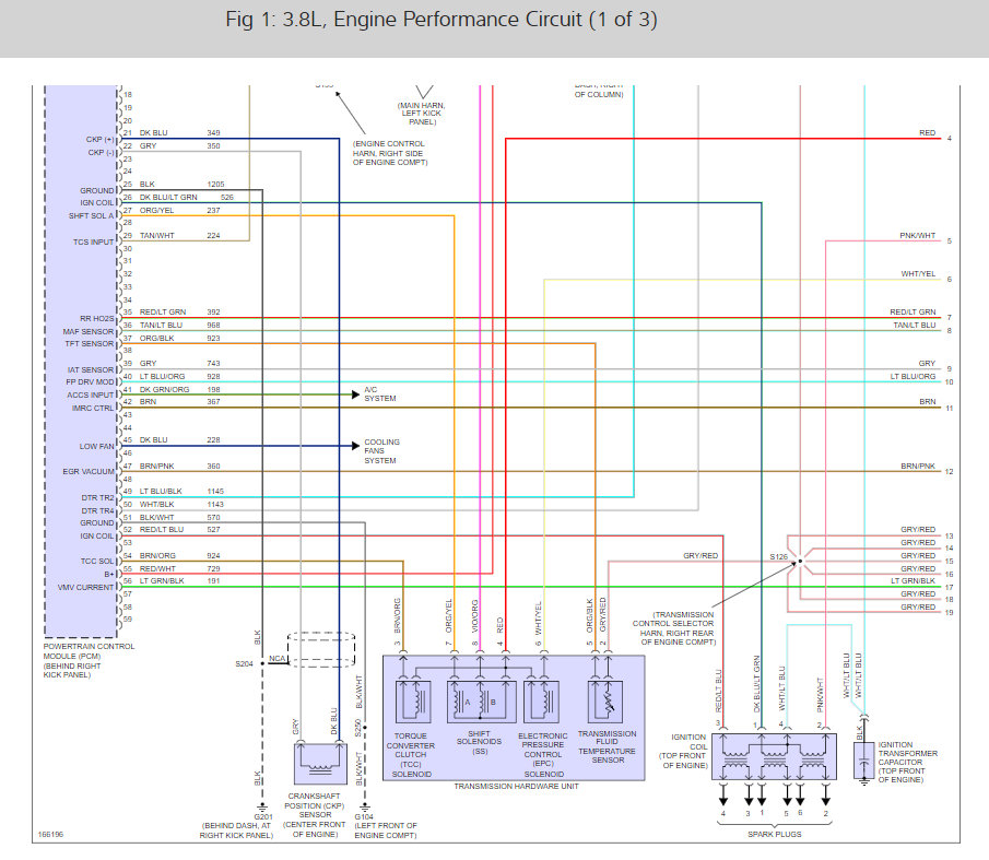

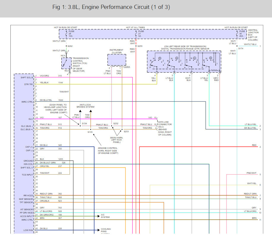

Two towers not firing on coil. I discovered there is no ground signal at the coil for those two towers that fire cylinders three and four. I want to check continuity from PCM to coil before buying a new PCM.

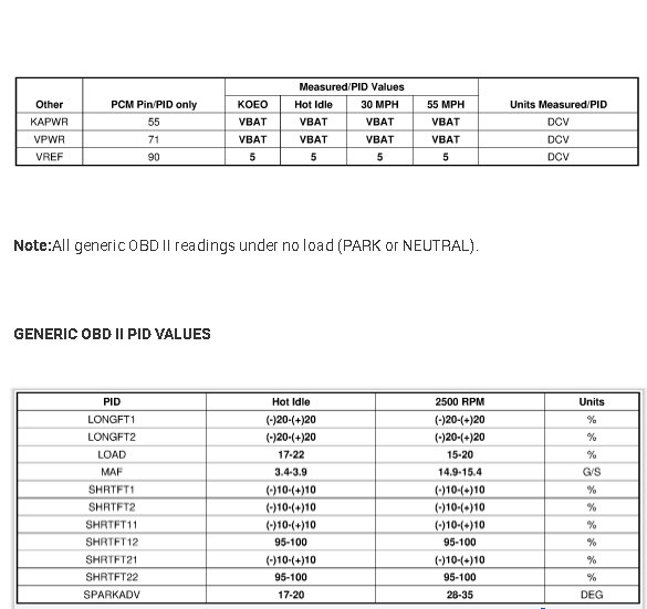

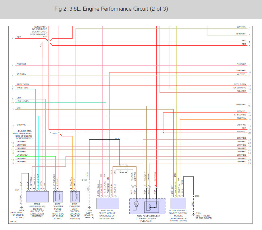

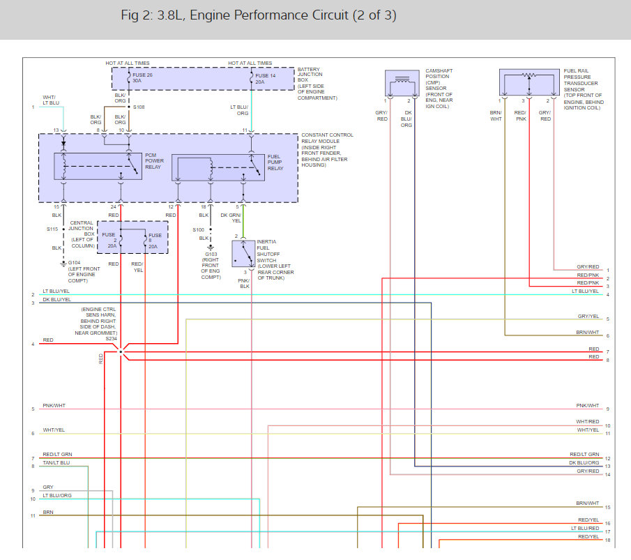

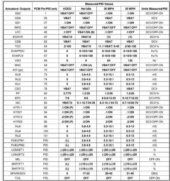

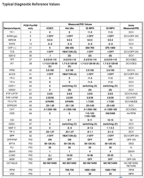

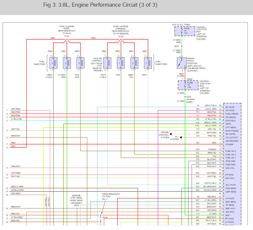

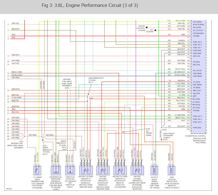

I have attached several diagrams based on the vehicle information you provided.
Let me know if you need any more info or more diagrams!
William

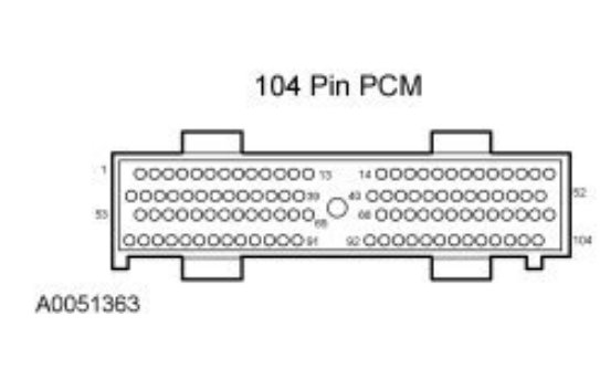

Pin 78 was in a different location then the diagram had it but I figured it out beings the connector was numbered.
I been a tech for over 35 years whatever happened to books good Lord its an act of God to repair these dang cars even with a $5,000.00 snap on scanner without diagrams your just out of luck (lol) all three coil drivers wires from PCM to coil have continuity so it is PCM time.

Here are the engine wiring diagrams so you can see how the system works. Check out the diagrams (below). Please let us know if you need anything else to get the problem fixed.

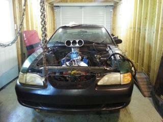

I dropped an old school 5.0 into a 1997 Stang. I'm attempting to hook up a tach adapter off my HEI distributor. I'm trying to locate where the signal wire is on c104f connector, I believe that is connector where engine harness plugs into. I'm hooking up a Glow Shift HEI adapter. The car originally had a 3.8L.
