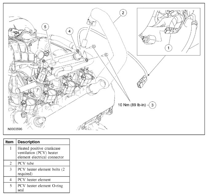

Where to all the hoses connect to?
Dec 19, 2025 at 5:27 PM
The PVC hose runs from the valve cover to the back of the intake on the drivers side, it is a little difficult to get to FYI. Here is an image to help yo see what is going on. Check out the images (below). Let us know if you need anything else.
