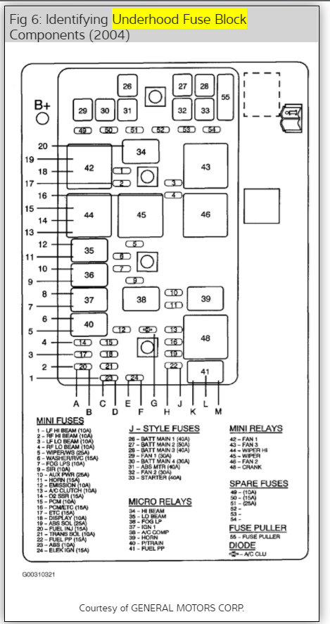

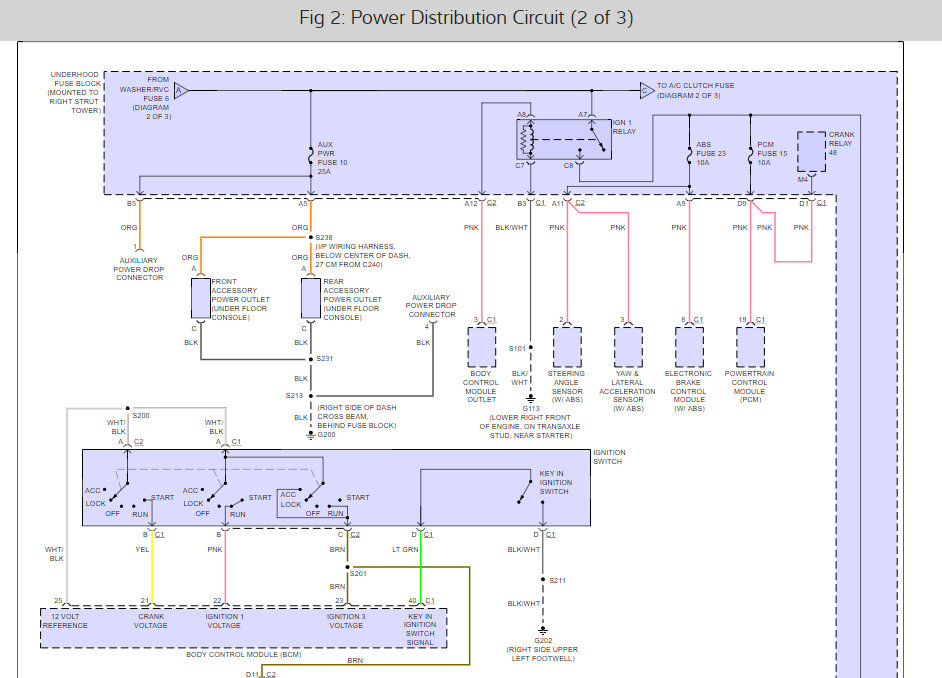

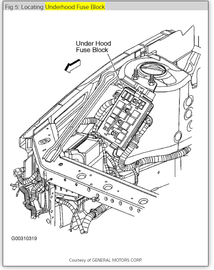

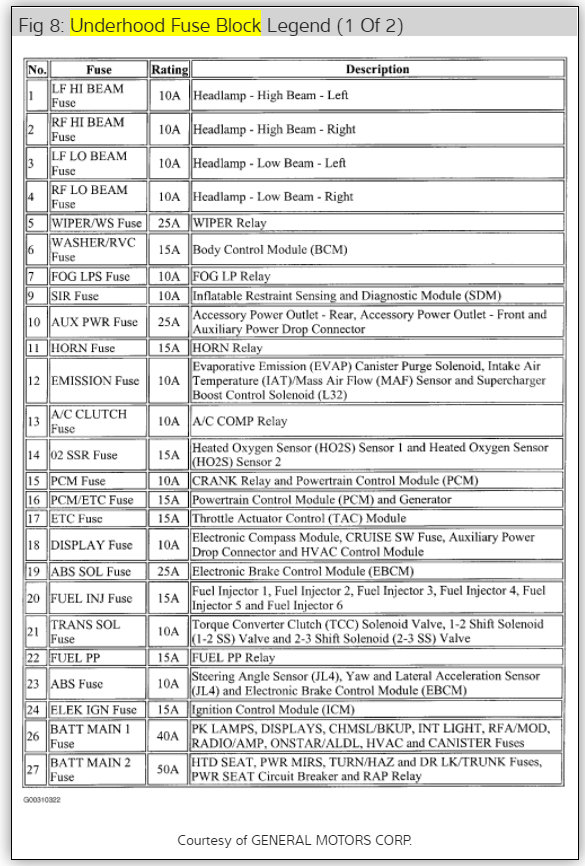

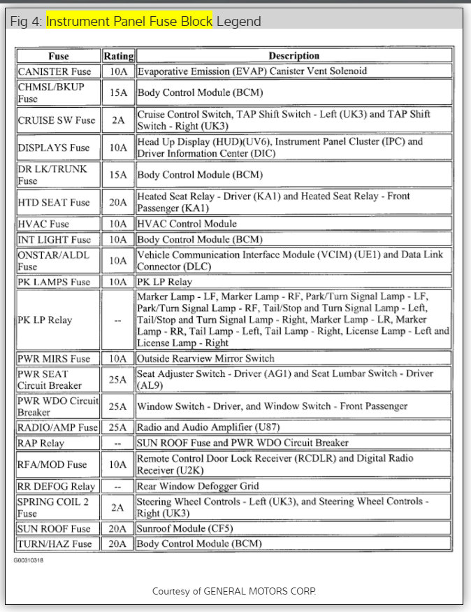

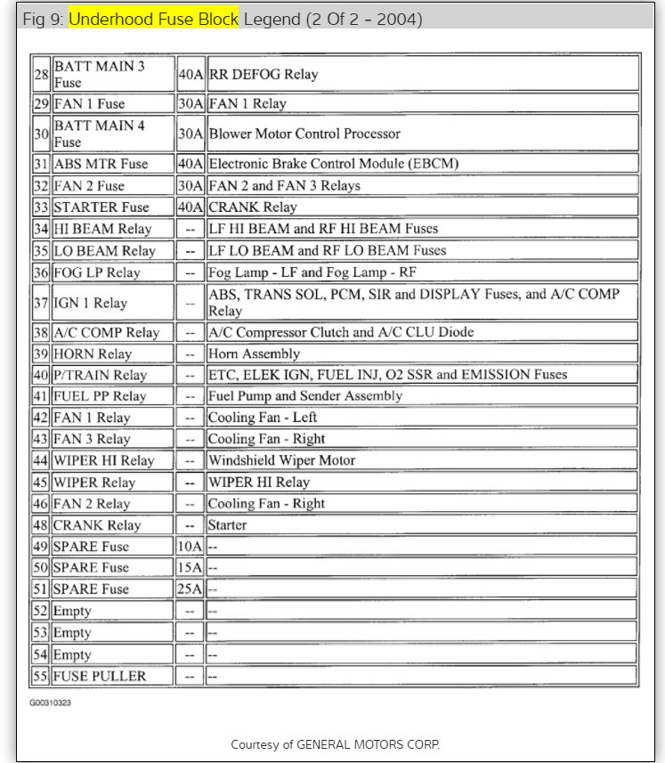

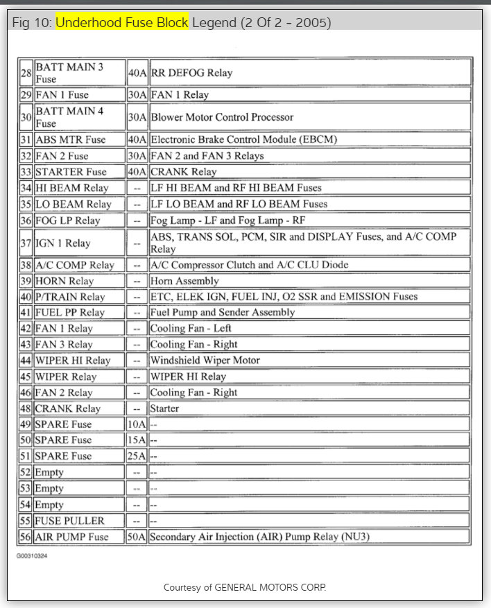

The fuse in question is fuse #10 which is a 20 amp fuse in the underhood fuse panel. Here is a guide to help you test it.
Here are the fuse panel diagrams to show you where #10 is. Check out the diagrams (Below) Please let us know if you need anything else to get the problem fixed.
