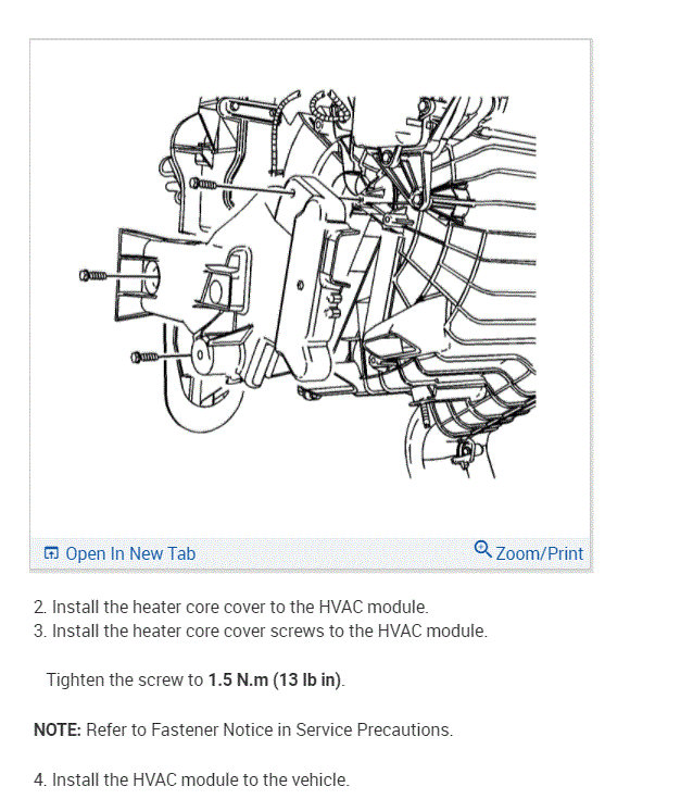

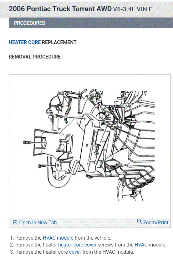

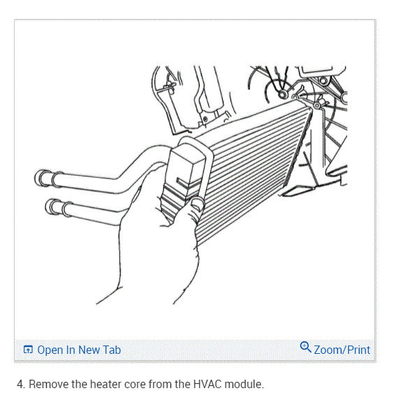

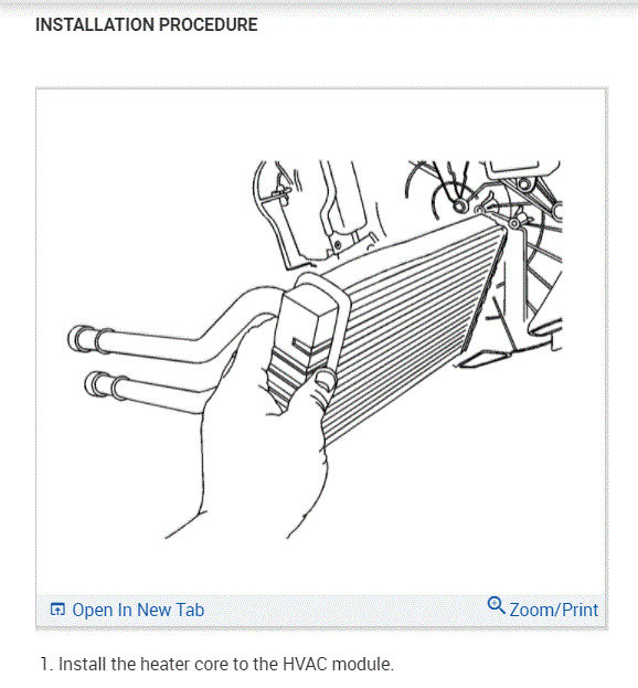

My heater went out and I was told by a mechanic that the heater core is really bad and needs to be replaced. Where can I find a detailed diagram showing where the heater core if located? Is it a common problem for 06 Pontiac Torrents heater to go out?
