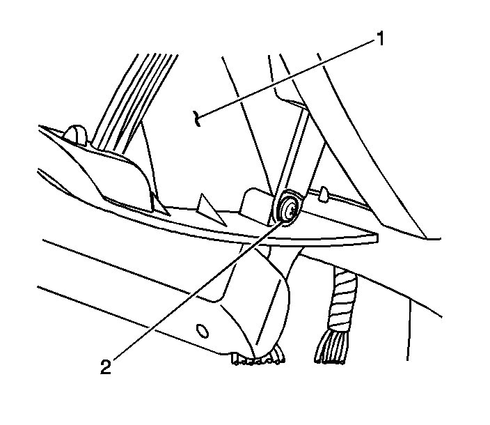

Welcome to 2carpros.com:
As mentioned, if the cabin air filter is blocked, it could cause a problem. Here are the directions for removal and replacement. The attached pictures correlate with these directions.
____________________________
Passenger Compartment Air Filter Replacement
Removal Procedure
1. Open the instrument panel compartment.
Pic 1
2. Remove the screw (2) from the right side of the compartment door (1).

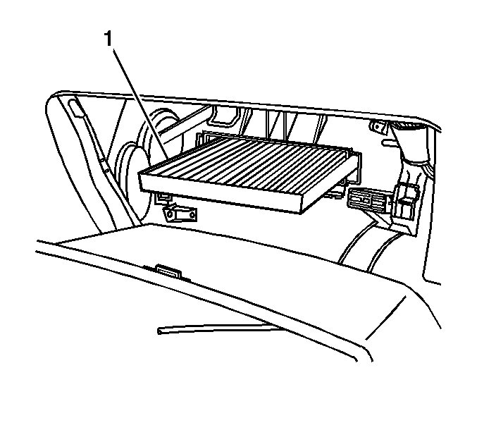

3. Push in on each side of the compartment door and lower the door.
Pic 2

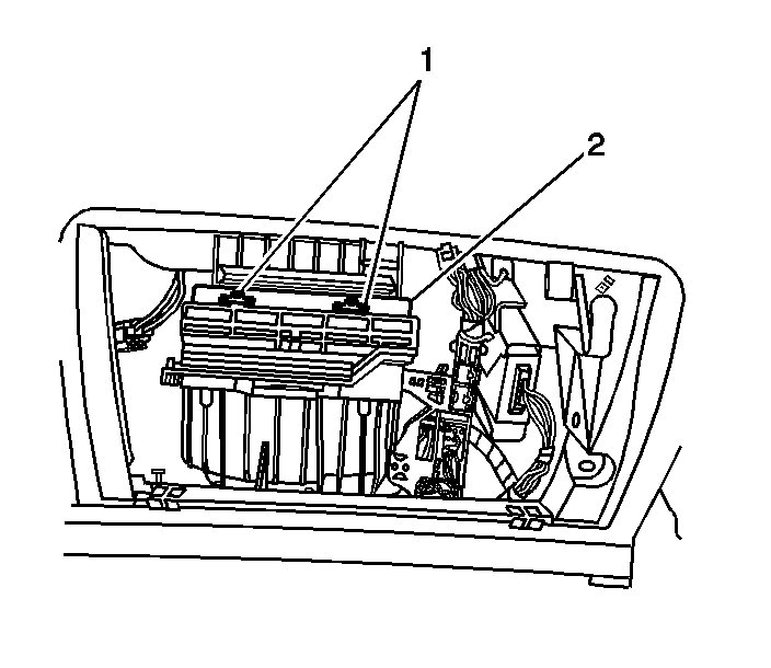

4. Push down on the tabs (1) and open the filter door (2).
Pic 3
5. Remove the filter (1).
