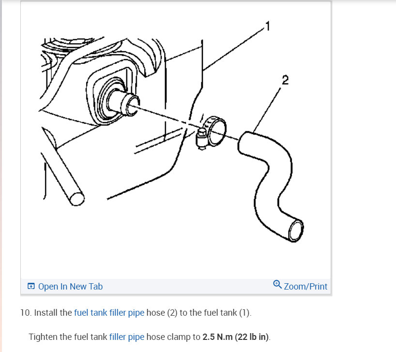

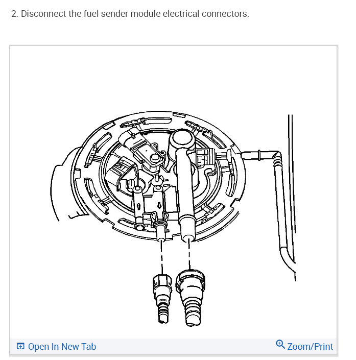

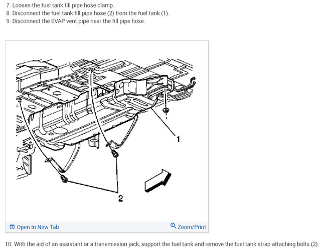

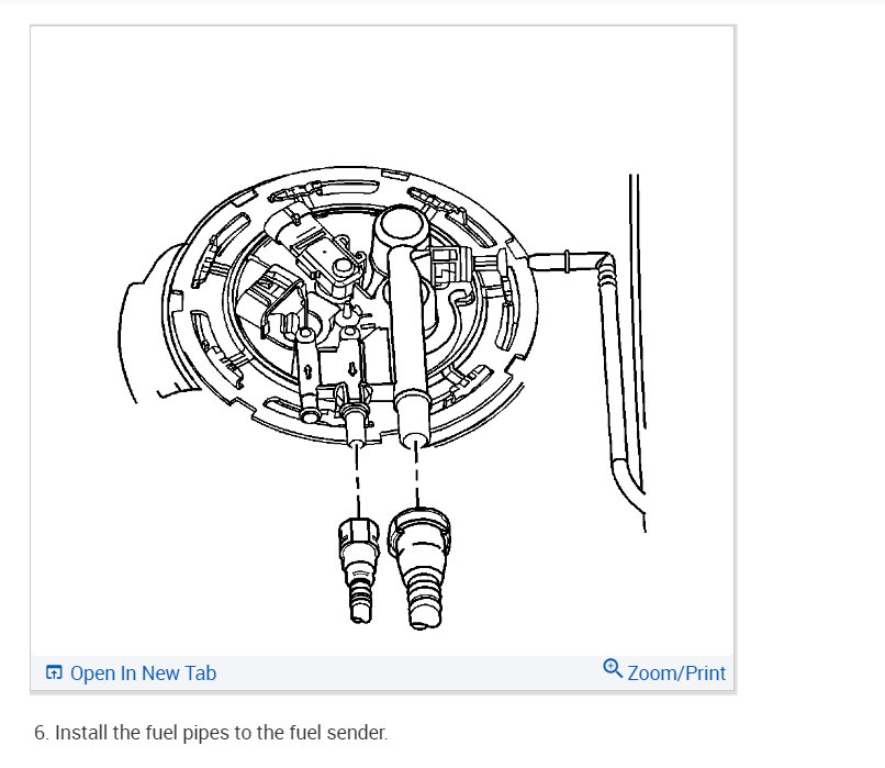

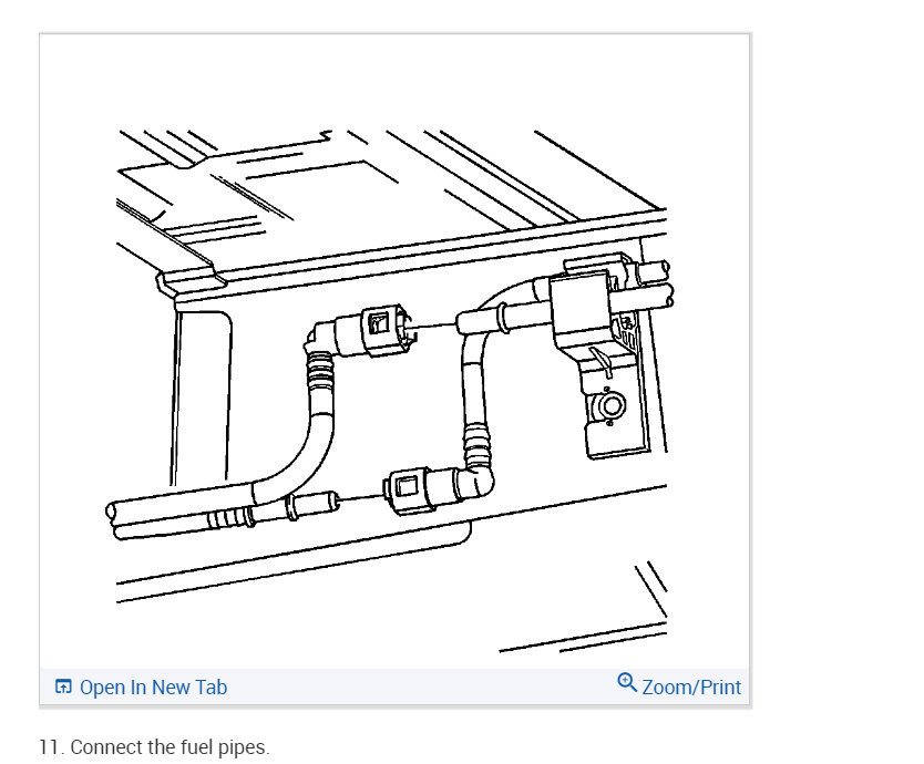

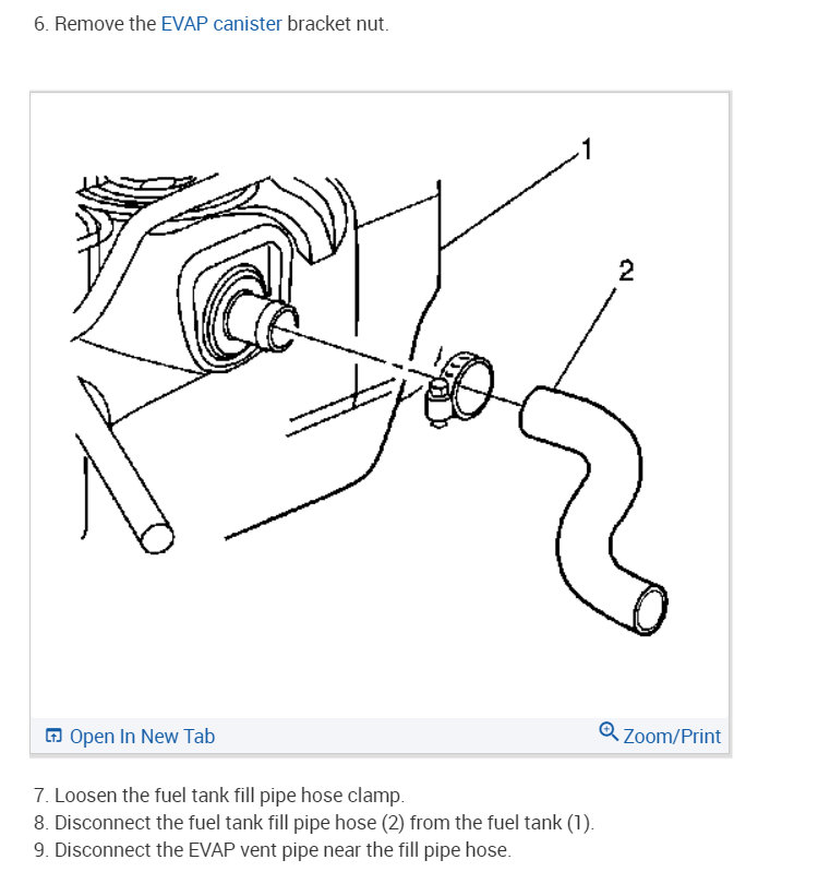

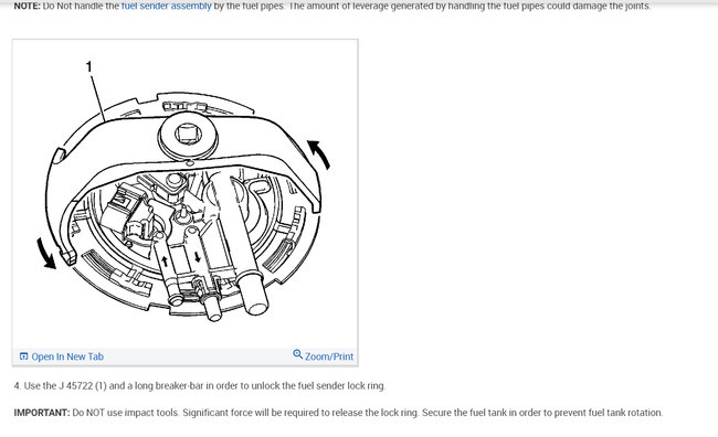

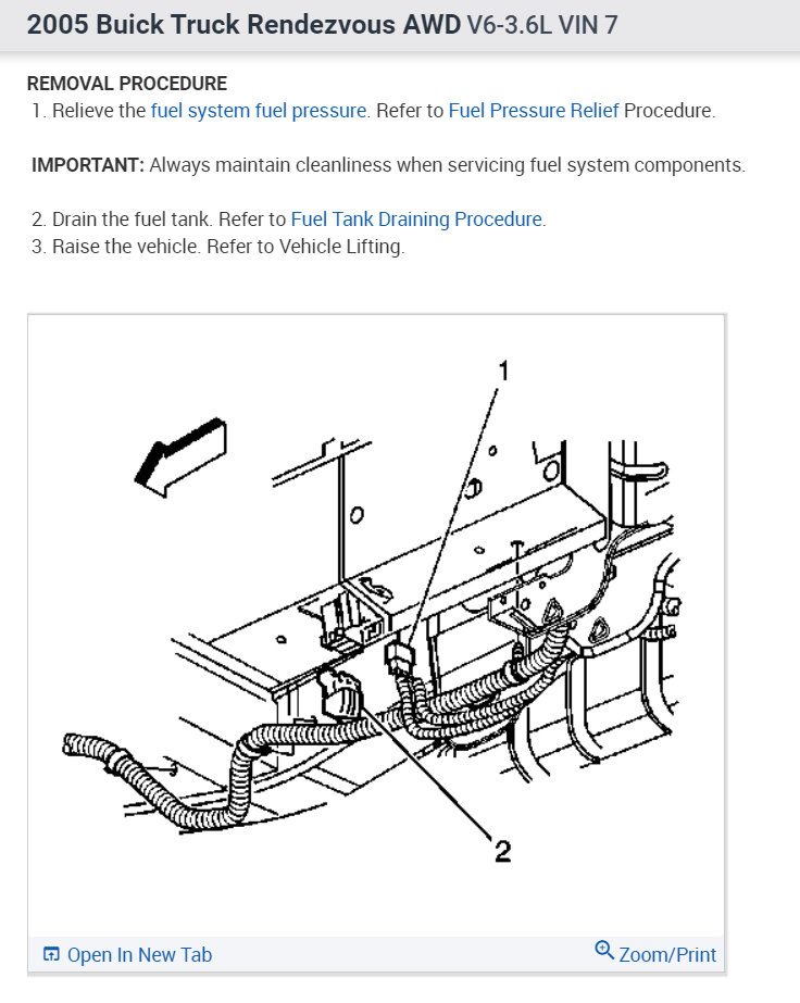

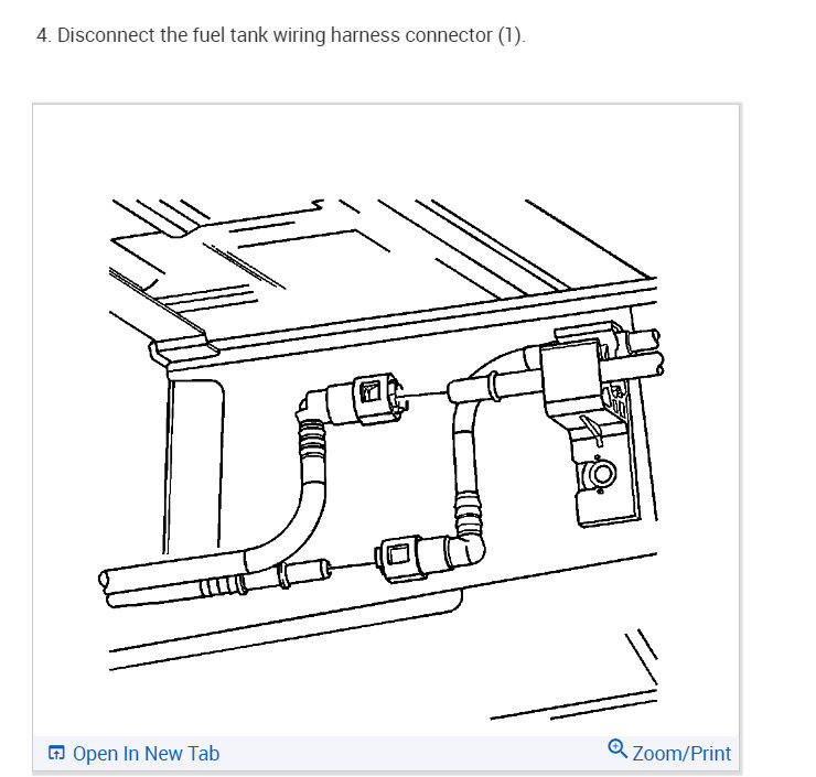

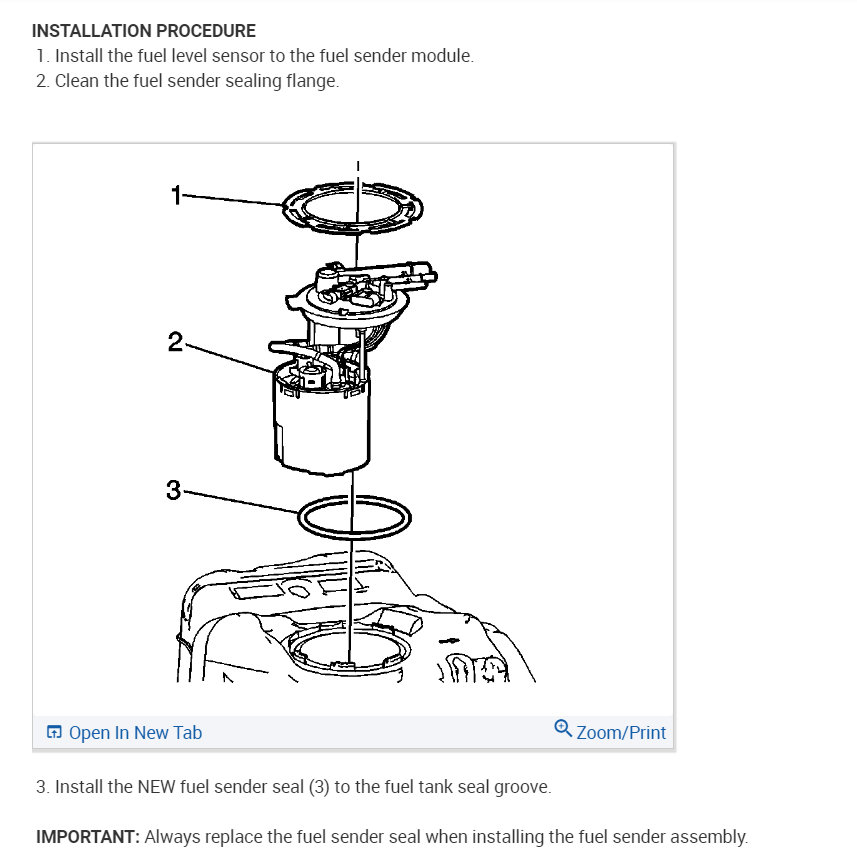

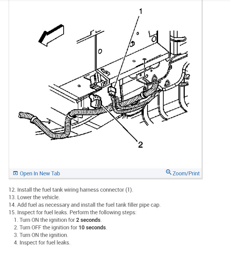

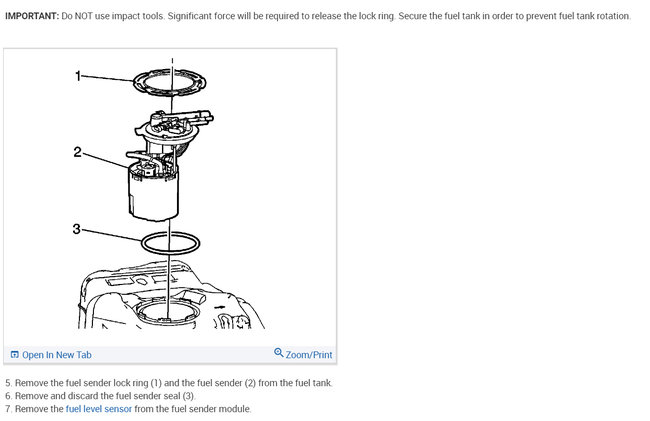

This can be one of two things, either the fuel pump is getting weak, or the catalytic converter is clogged, but we should run the codes to see what comes up this guide can help:

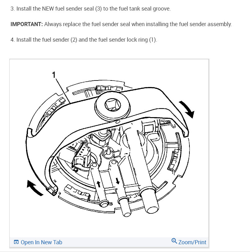

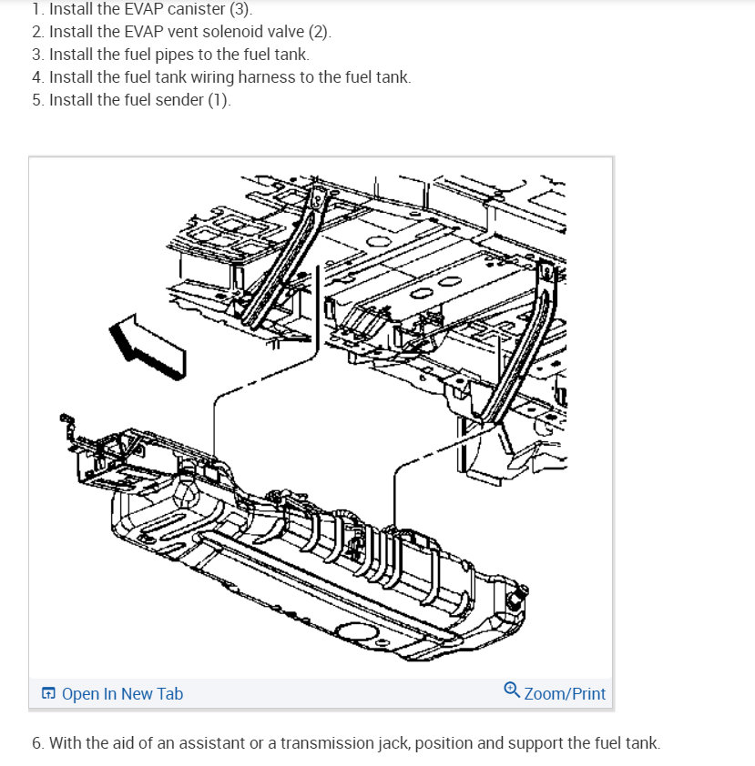

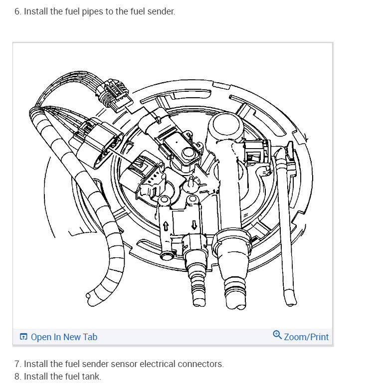

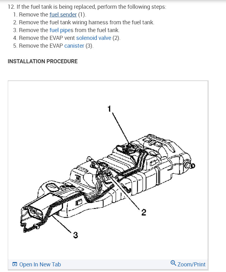

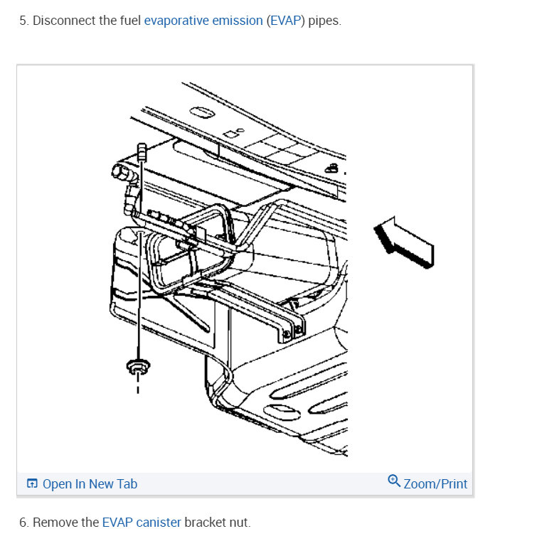

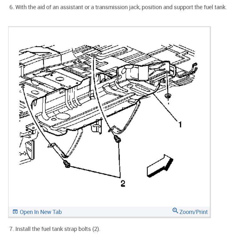

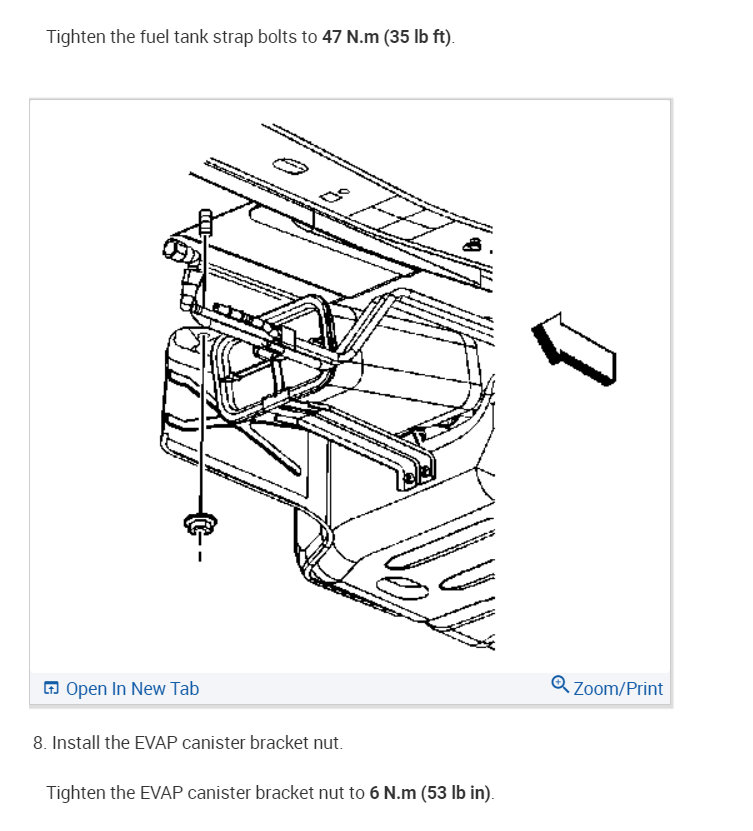

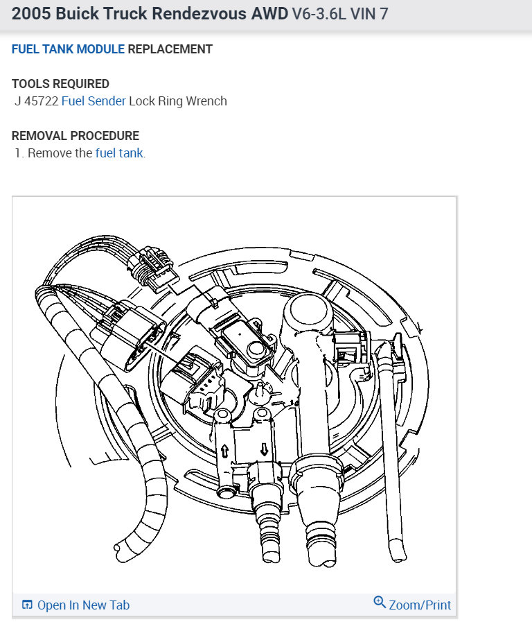

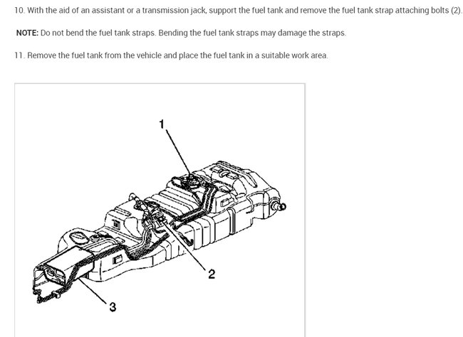

Here is a guide to help you check the fuel pressure and I have left instructions in the diagrams below on how to change out the fuel pump:
