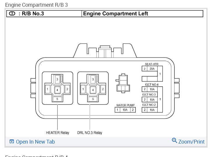

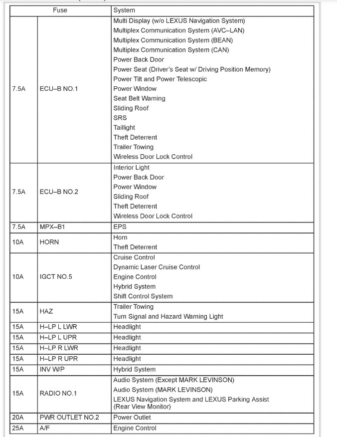

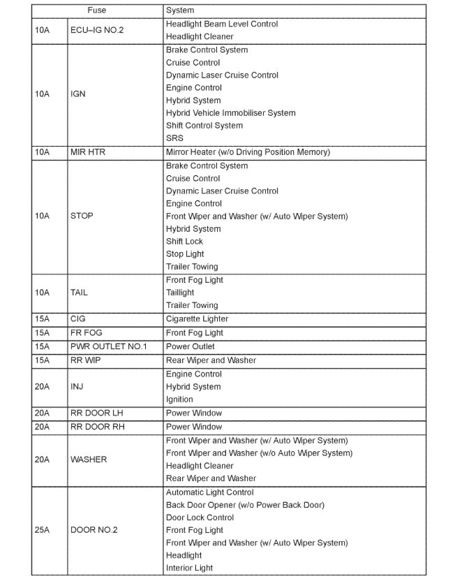

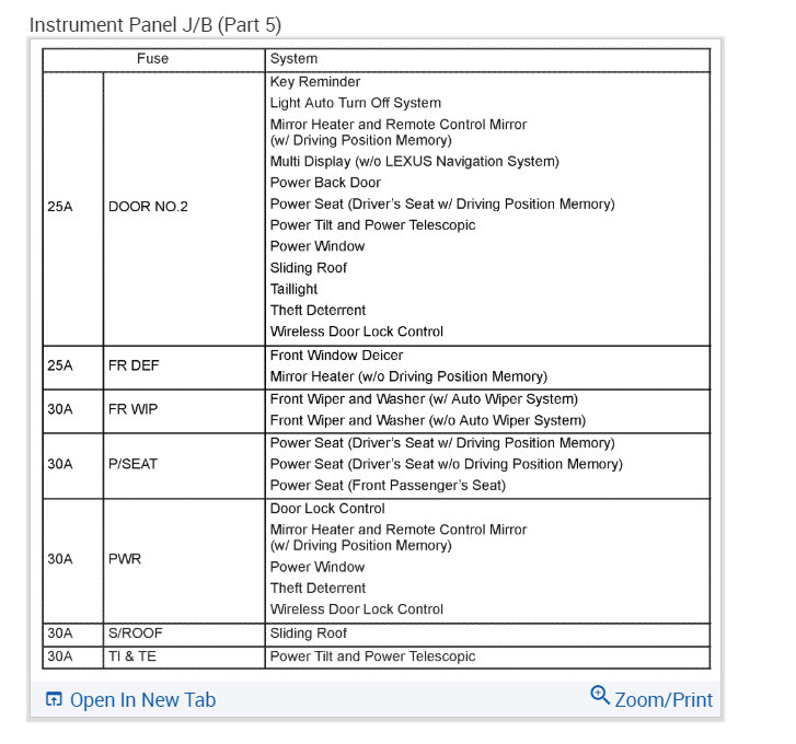

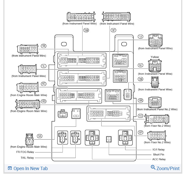

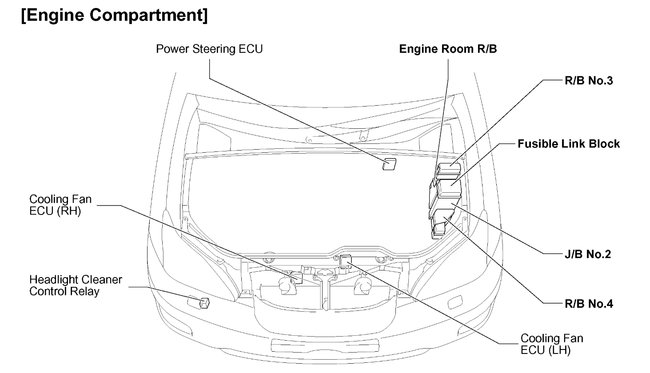

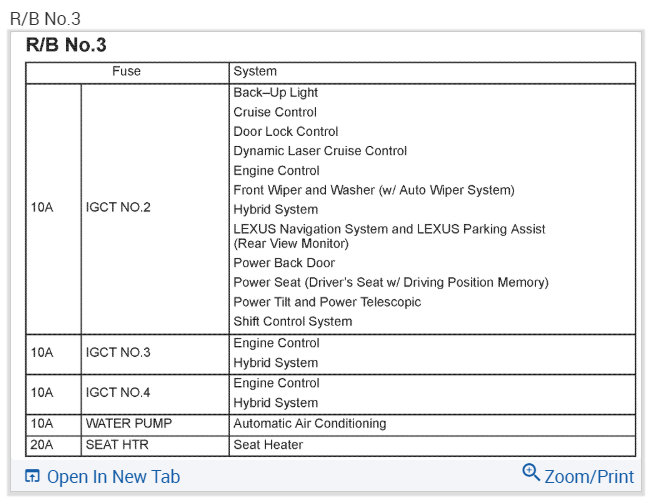

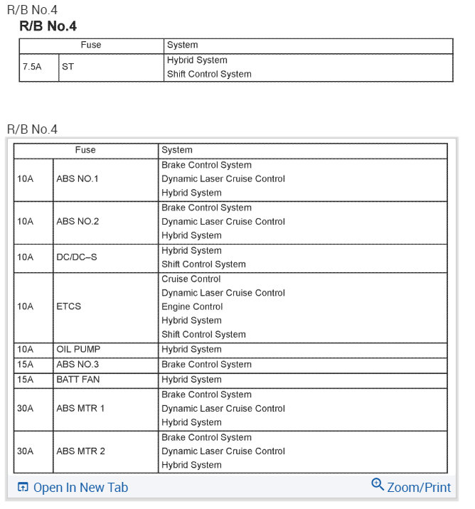

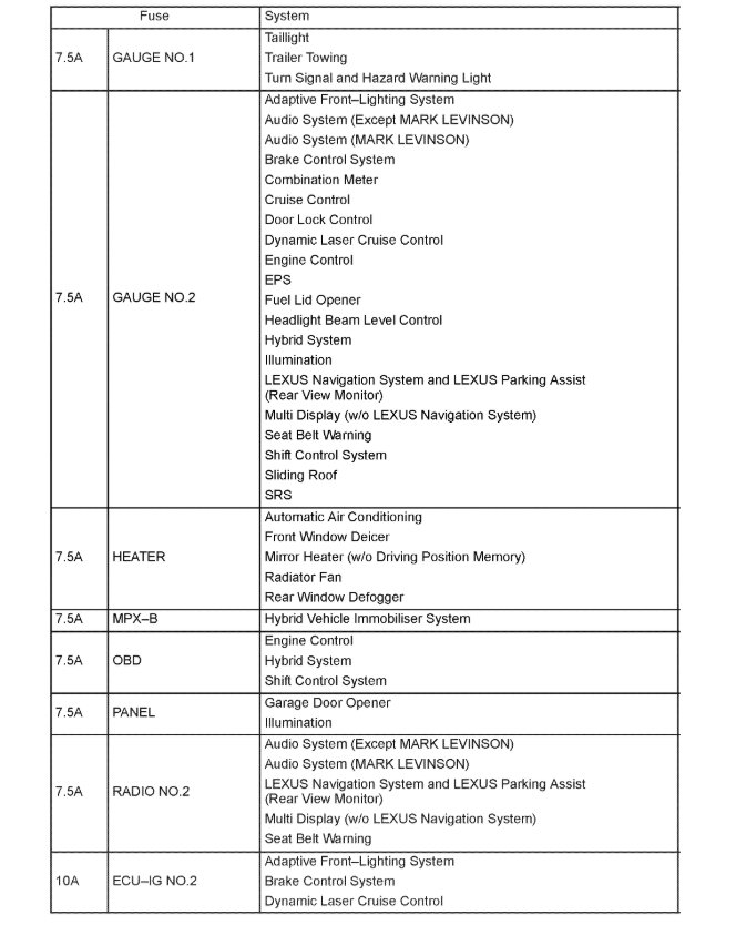

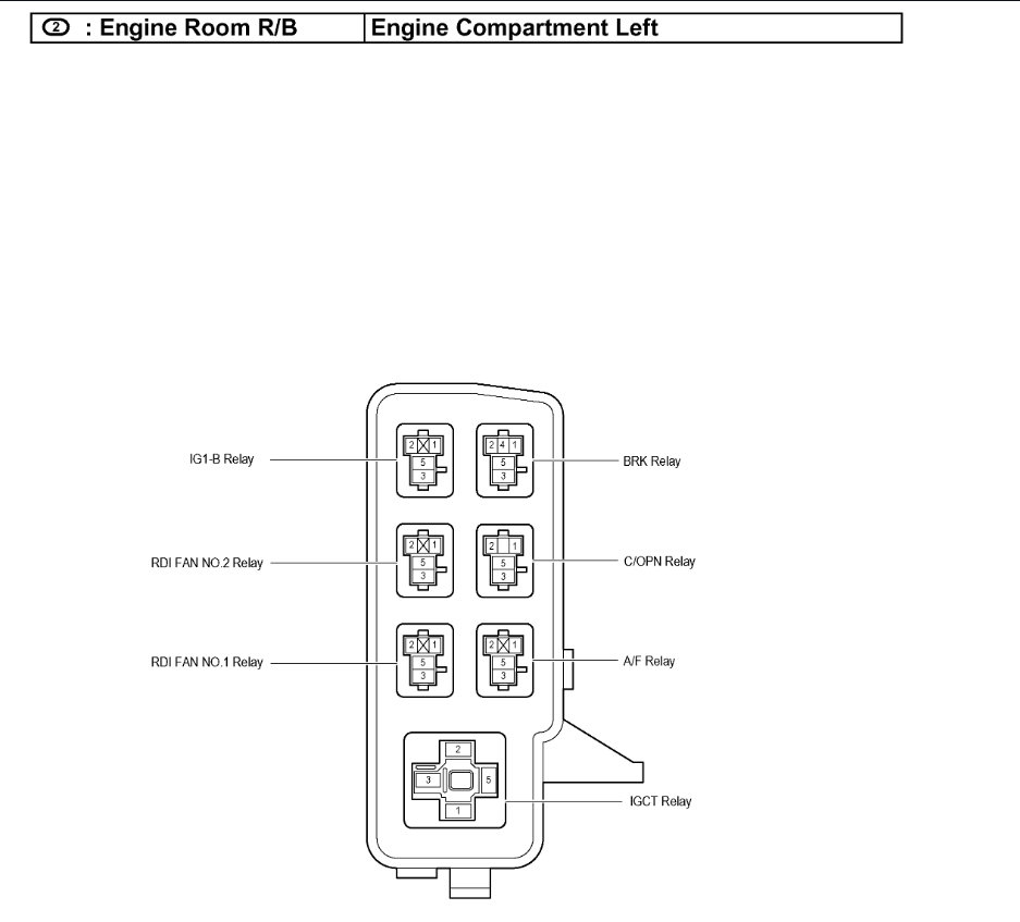

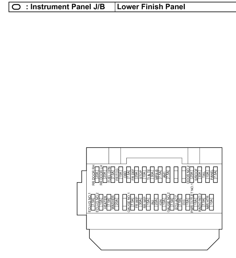

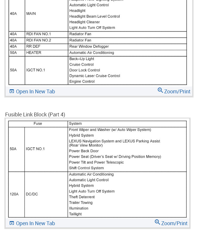

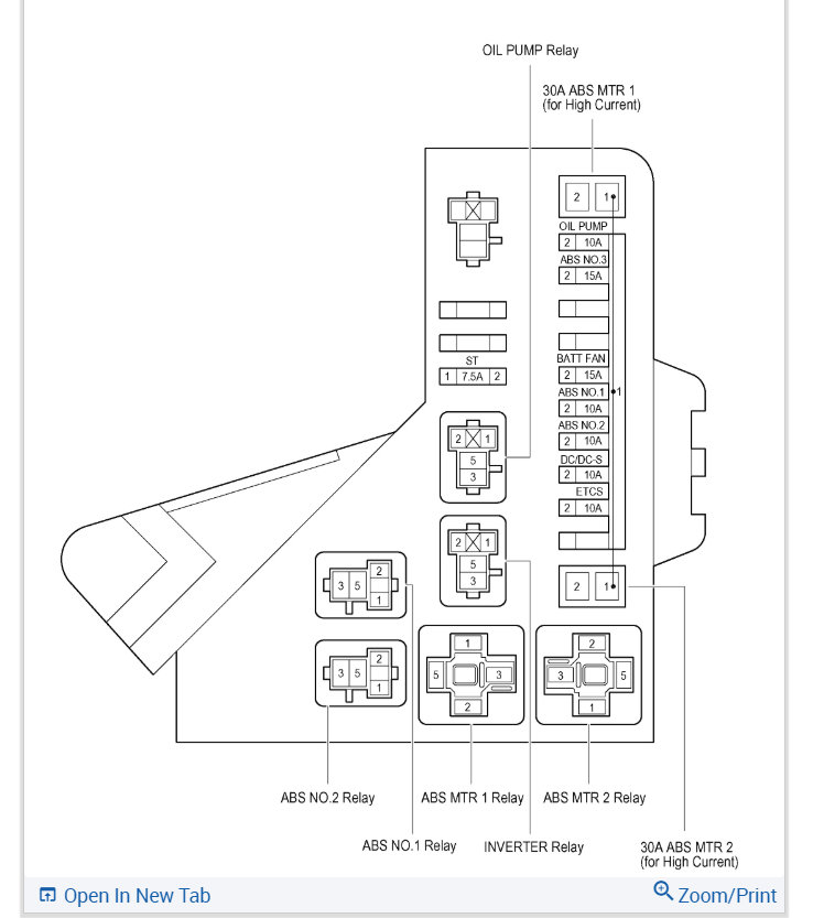

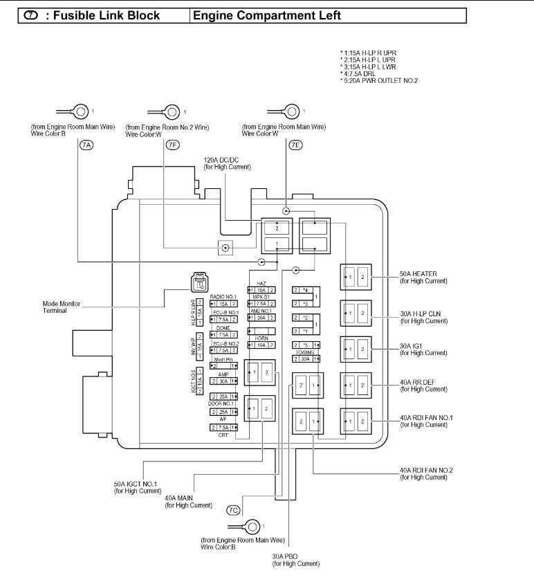

It sounds like the 7.5 amp CRT fuse popped under the hood which is common when replacing the battery here is a guide to help make sure and the fuse location as well.

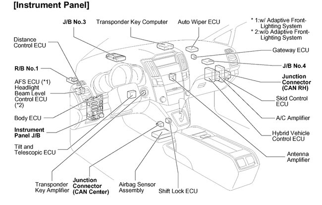

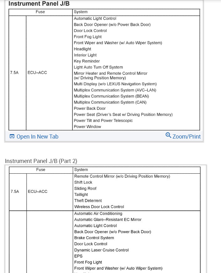

Here are all fuses and relays to help you in the future you can save this page too your favorites. Check out the diagrams (Below). Please let us know if you need anything else to get the problem fixed.

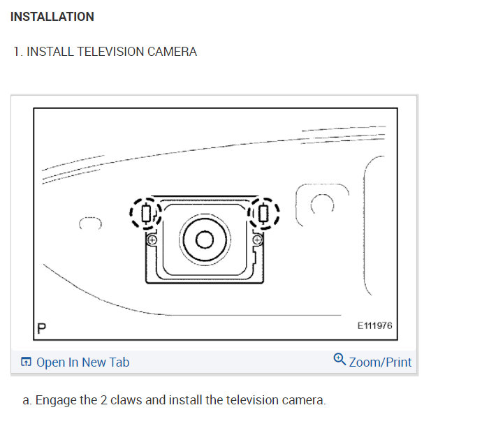

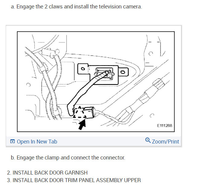

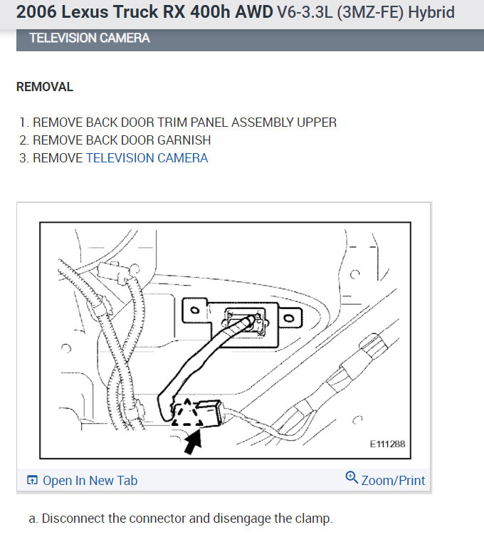

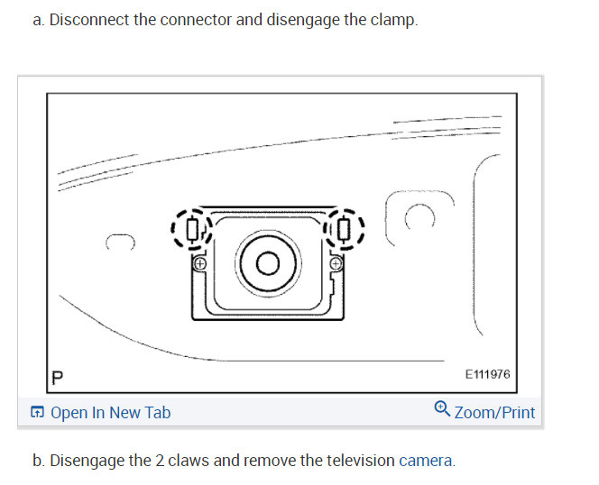

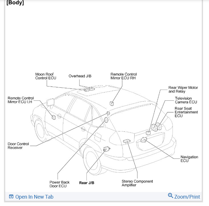

9 times out of 10 it will be the camera that is out. here are the instructions on how to replace it in the diagram below. Check out the diagrams (below). Please let us know what happens.
