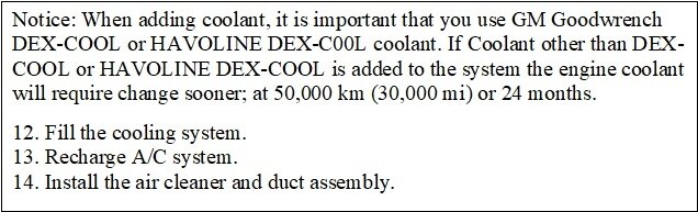

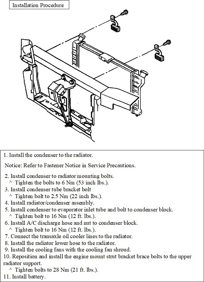

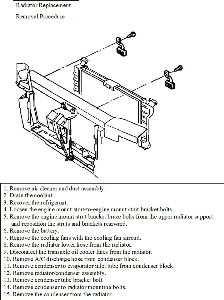

Here's links to some related articles you might find of interest:
https://www.2carpros.com/articles/how-a-radiator-works
https://www.2carpros.com/articles/how-to-replace-a-car-radiator
The replacement instructions are below.
