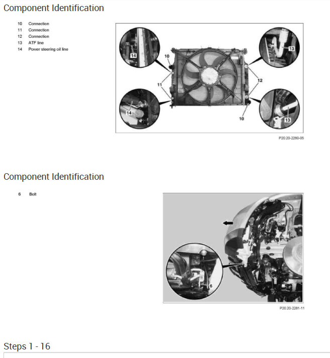

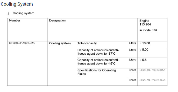

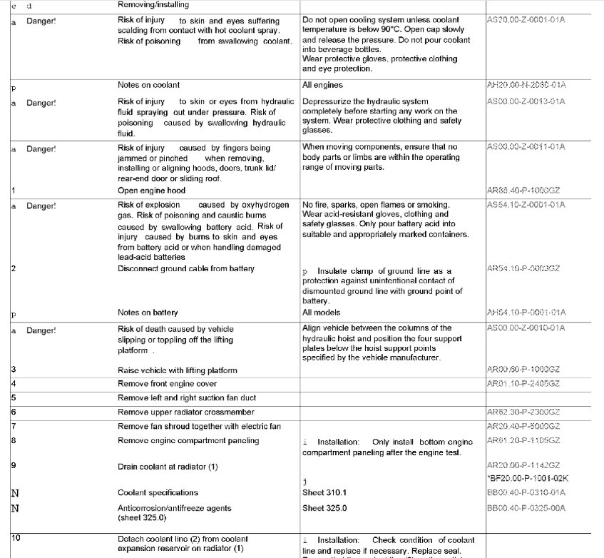

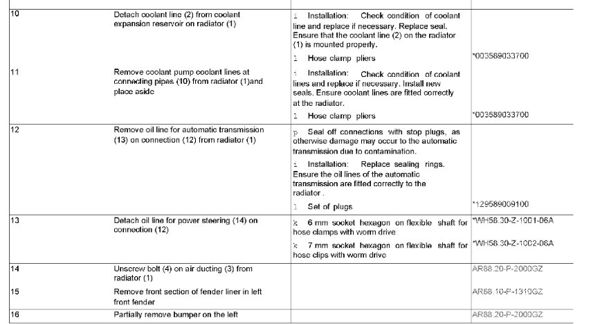

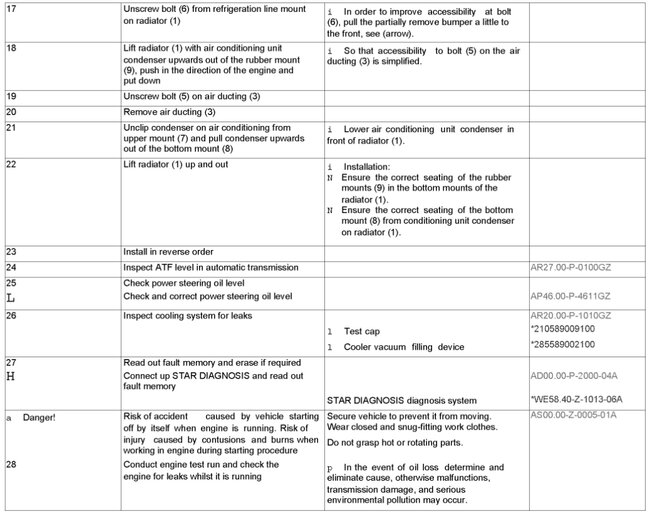

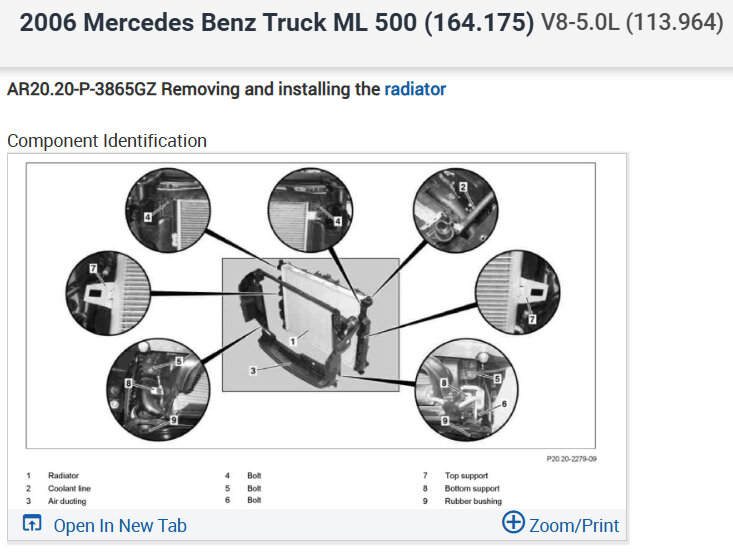

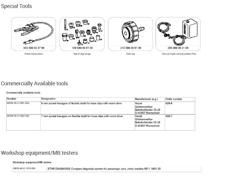

Yes, these can be tough. Fortunately, we did this job in the shop not too long ago and recorded it. This is the video for you to watch:
https://www.youtube.com/watch?v=NRlr9sg3rr8
The job is similar for the 2006 but there are subtle differences. Here are the instructions for the 2006 model. Check out the images (below). Please let us know what happens.

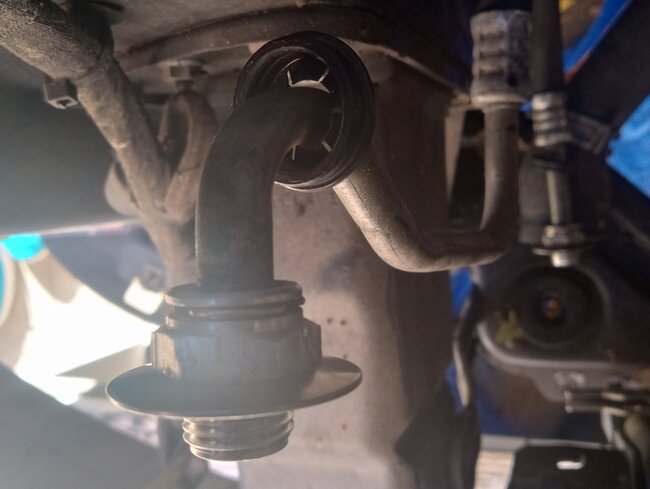

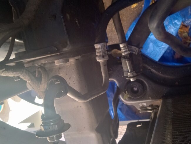

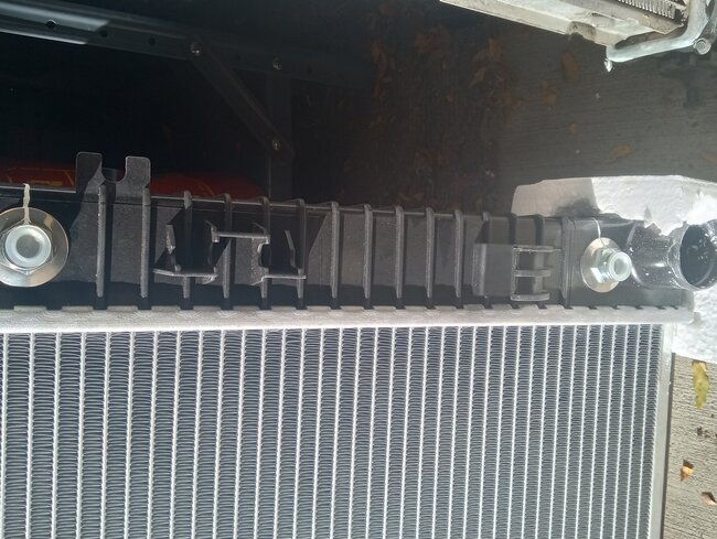

how do i remove the rivnuts from the old radiator the new i have doesn't have them How do i reattach the ATF Lines? I unscrewed him from the old radiator. the new radiator already has. the nuts attached to it, but the old lines I can't remove the nuts off of there to insert it into the new radiator.
Dec 2, 2024 at 11:30 AM
Can you upload an image of what you are looking at so I can see what you are talking about?
Dec 3, 2024 at 9:20 AM
JAMES BRYANT
  • 9 POSTS
I can't disconnect the line from the nut to be able to put it into a new radiator.
Dec 4, 2024 at 12:14 PM
Thanks for the images they help. You need to remove the retainer clips on the old fittings then they will come off of the line. and then they just push into the new radiator fittings, and you are all set.

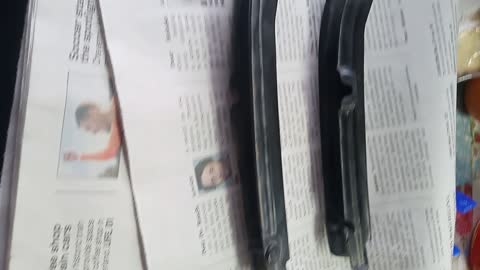

I'm having difficulty reattaching these clips to the front fender. I watched multiple videos on YouTube, but nobody seems to show you how to reattach them.
Dec 13, 2024 at 1:35 PM
Can you show me where they go? I am not sure but I think we can figure it out.
